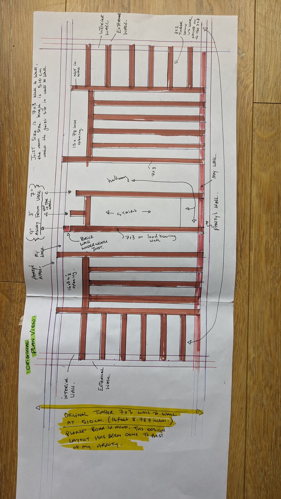

Hello! I've created this layout plan to the best of my skills. I hope you find it helpful.

If it's close enough to the wall use a joist hanger, otherwise extend via sistering.

You would just use a short length - If it's that one on the top left of your picture that says "not in wall" then it looks like you only have 15" but that should be enough. You might still find it easier to carry the end of your new piece on a joist hanger but a photo would make it clearer.

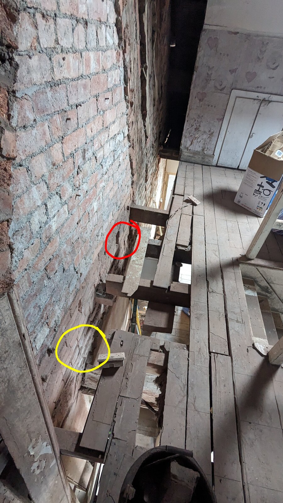

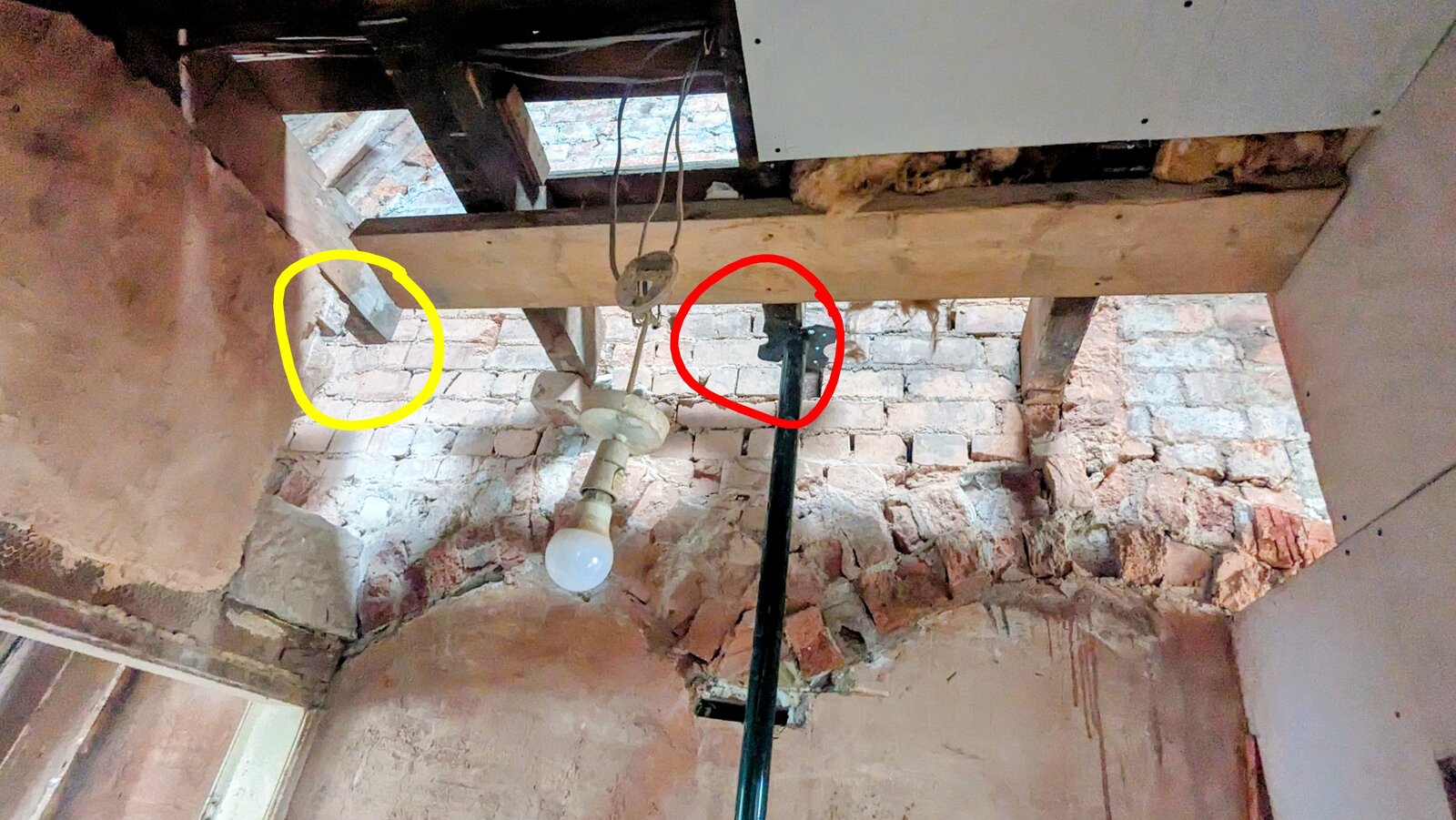

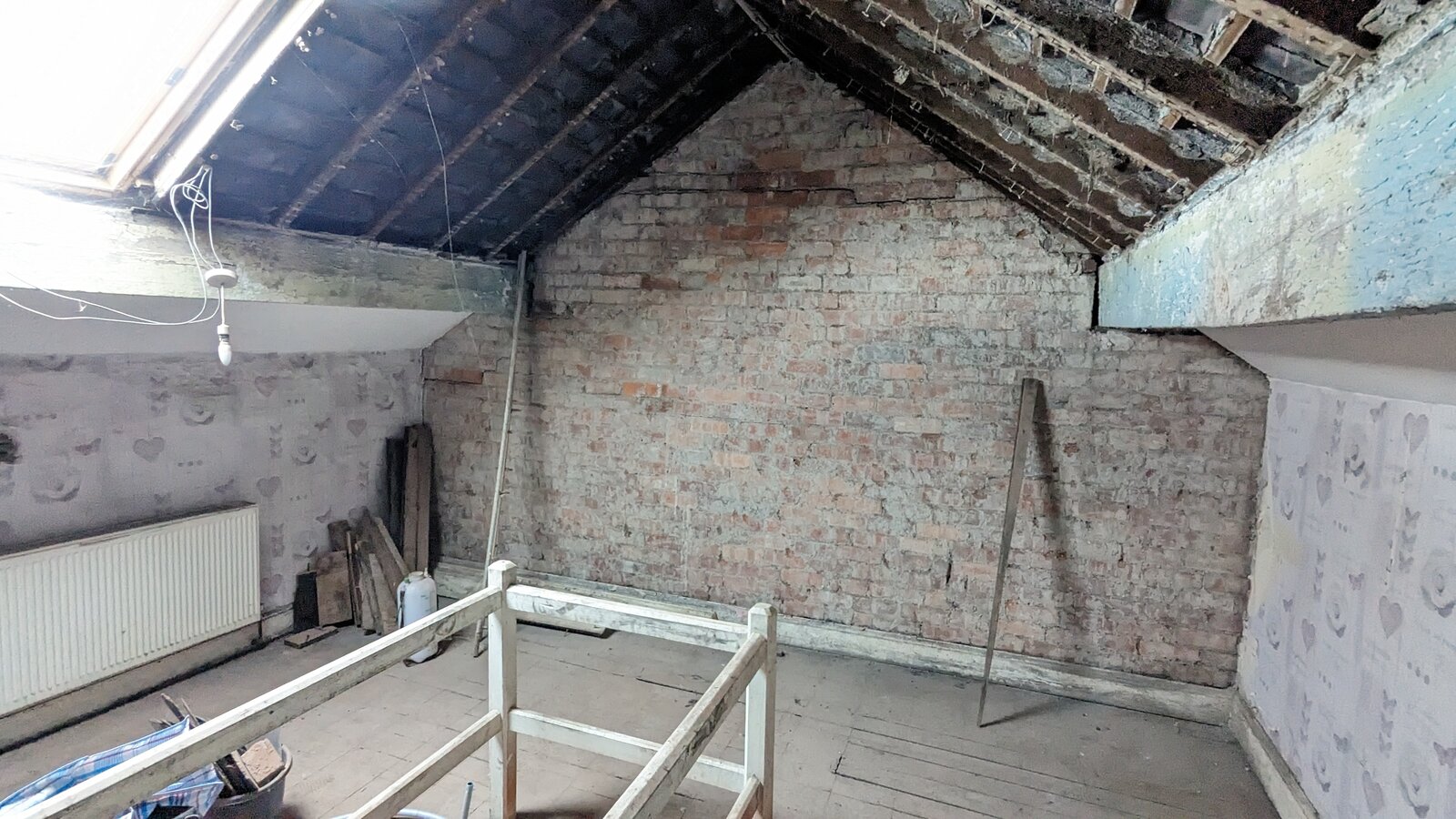

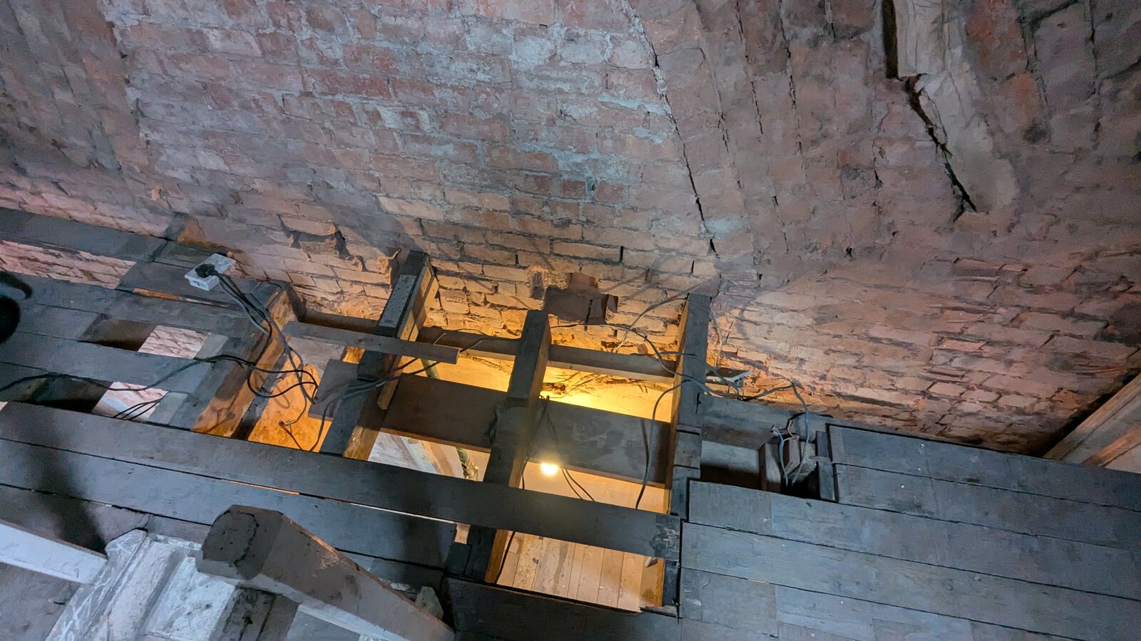

I have included a picture for clarification. As you can observe, both the stack and the chimney breast have been entirely removed. The area where the joists are situated was once supported by a 'U' shaped chimney breast, which then divided into two chimney breasts that extended down to the cellar.
In the image, marked in red, you can see that the joist measures 5 meters in length—one end is secured in the wall while the other end is free. The unanchored end is positioned 7 inches away from the wall.
On the other hand, the joist marked in yellow is located on a load-bearing wall, but it is 9 inches away from the wall.

I thought this rang a bell - you've asked about this years ago and if I recall correctly were given suitable advice??
Not a builder but I would think you need to extend all 3 of the joists in your pic. The ones marked red and yellow and the one that is just supported by a protruding brick as you will probably need to remove it to get your new ceiling flush. The one on what you say is a load bearing wall seems to be only supported by a wooden lintel above a door frame. I would not be happy with that for the extra work involved in doing it like the others. I would have thought a couple of extra metres on each joist with plenty of bolts would have been adequate but I am not a structural engineer either. I also think fitting some noggins would be helpful. It really needs to be safe if you are going to use it as living space.
