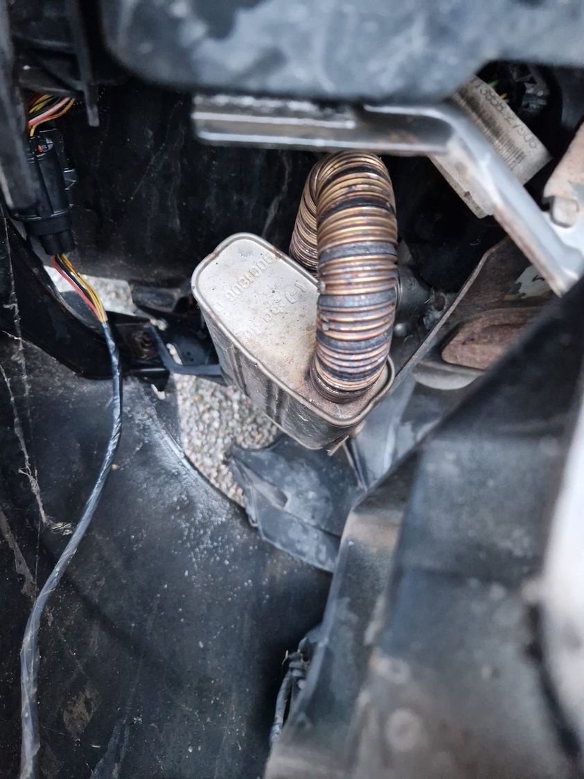

If they are never cleaned, never serviced, then the glow pin can become choked up with burn on carbon, as well as choked the heat exchanger. Surrounded by carbon, the pin is much less effective, and so they can smoke at start up, and to some extent when up to full speed. The exhaust cannot rust, they are stainless steel.
I've seen complaints of smoke, smells and splits or bursts in the flexi pipe. I must have been wrong about the rust, thanks.
