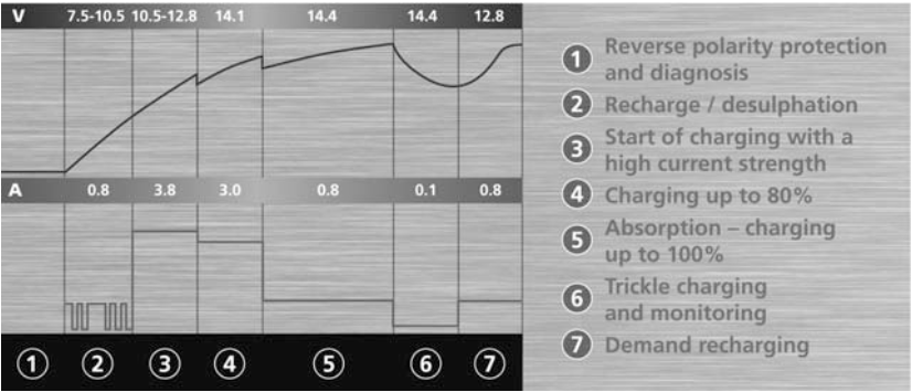

Most manufacturers have the minimum no load voltage as 12.4 volt, under that returns are rejected, and the stage charges (some times called smart charges, use a pulse system to charge a battery under 10.5 volt, a typical charge graph 1703413683128.png this charger is a problem if battery being used, as it will not return to full 3.8 amp once it passes that stage, it alternates between 0.8 and 0.1 in large battery selection and 0.1 and off in small battery selection, the latter Lidi charge does return to 3 amps. And I think the Ctek does return to full output.
