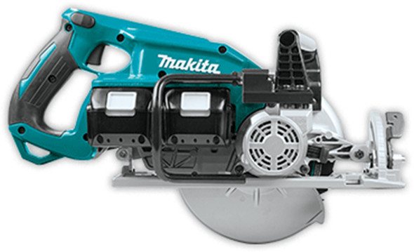

If it's something that interests you, the Makita XSR01 36v Brushless Rear Handle saw will be out over here in the coming months and it pretty much eats any competition bar the Flexvolt.
While looking at other options I'd personally look at 36v(2x18) or the Brushless 18v. They're worth the extra money.

Nice looking machine. Only drawback is the battery probably won't fit makitas other vast range of cordless machines.
I'll stick with metabo.
Same batteries mate. Uses 2 18v packs.
