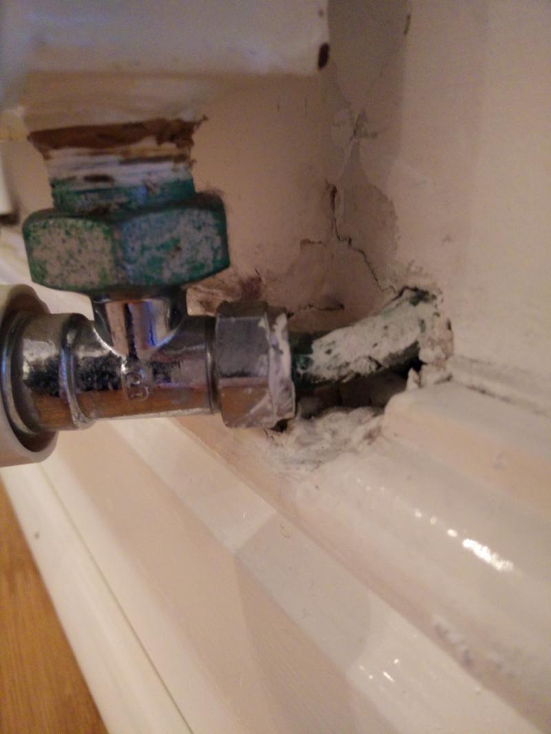

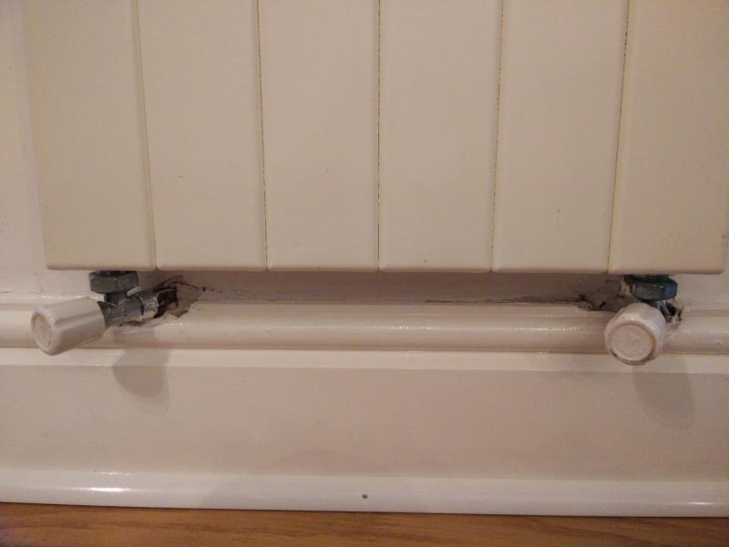

As the radiator will be thicker, the pipes will need to be extended. Also adjusted for the valves to fit the radiator. Easy enough for a plumber but there is no room for manoeuvre with existing pipes.
Will some of the plaster need to come off for the pipes to be extended.
Not the most tidy job I know. Just moved house.
They don't look like solid walls, so expect there to be a little making good afterwards. May have to use compression coupler to extend pipe, but that should be no problem. Leave it to your friend of a friend to decide how best to tackle the job. What could possibly go wrong?
Thanks. He is fitting new doors for me as he has his own building company. Said he they would do the radiator at no extra cost for what I'm paying for the doors. Therefore not sure if he just meant swapping like for like or all the alterations in between.
The wall should be solid. External wall with two french doors either side of the radiator.
I'm going to get a quote to fit 10 or so TRV's so may just get the rad done with that. As the valves will only have to come off again to fit the TRV, as well as drain down the system.
