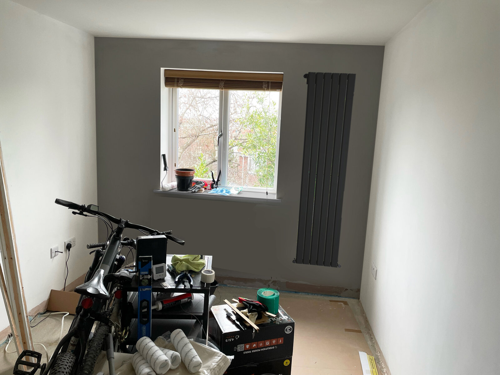

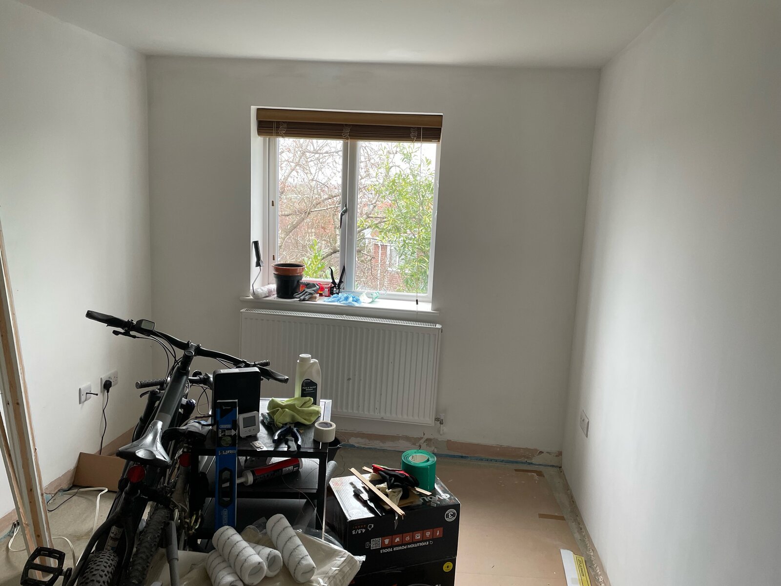

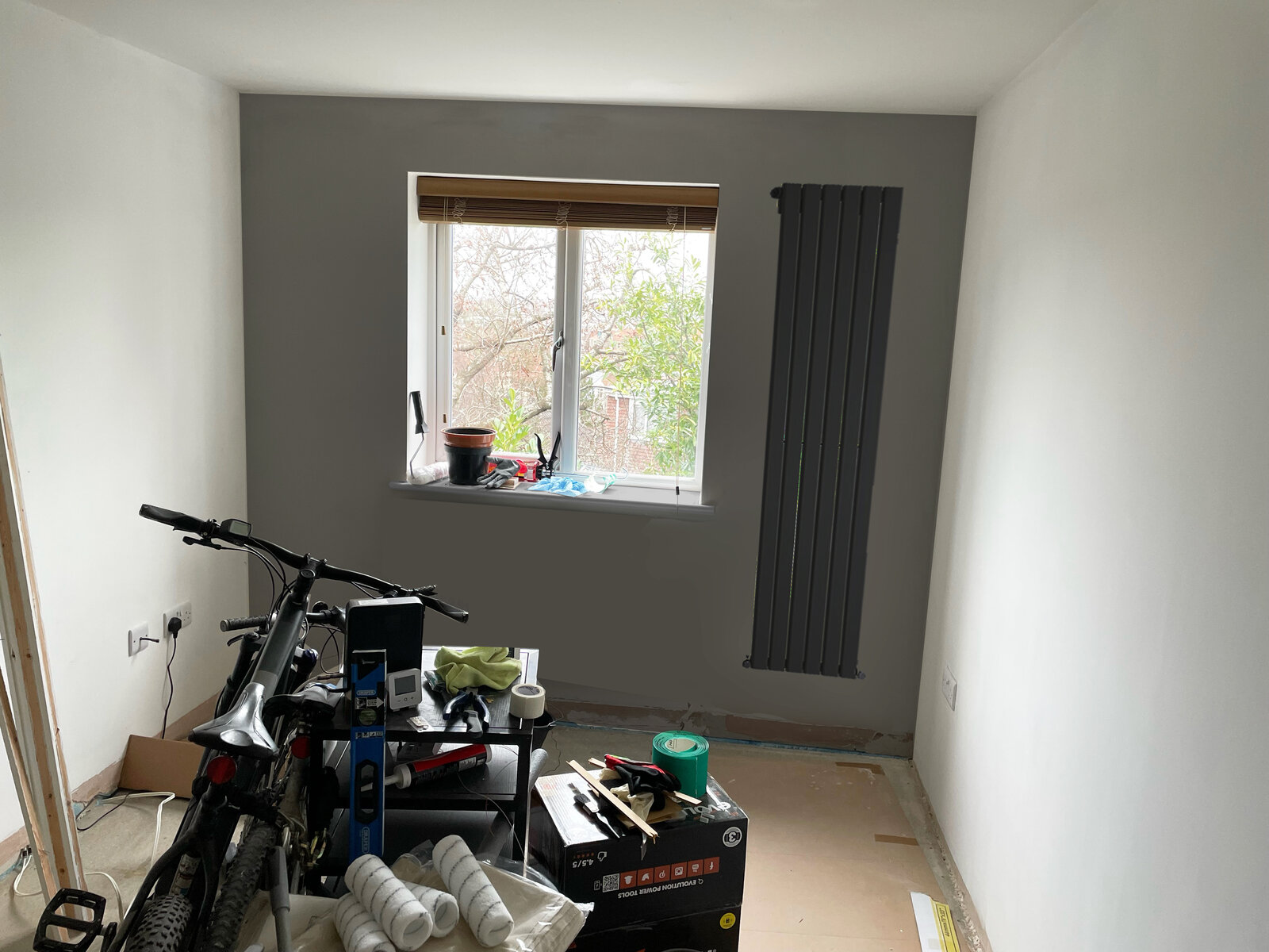

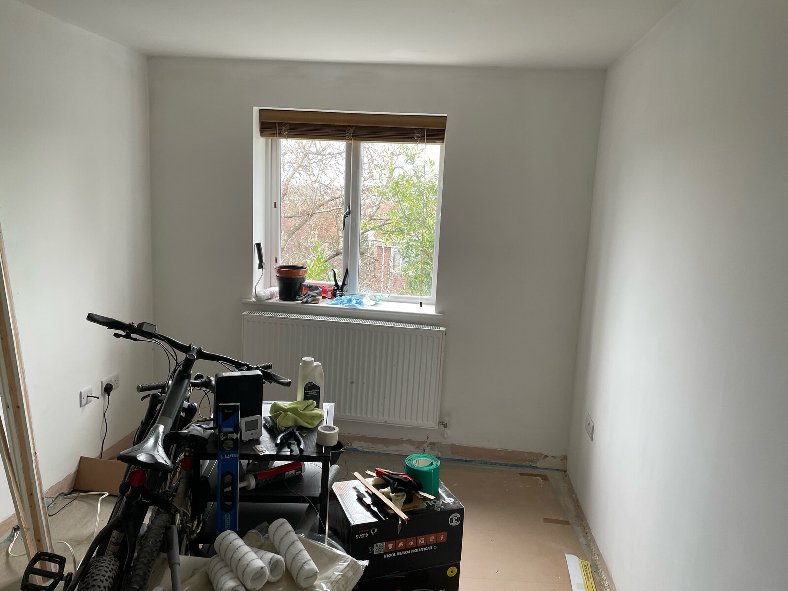

Is there any problem with changing this radiator to a vertical one?
28 Apr 2021
285
3
So I have an overpowered wonky 1200 x 600 x 100mm radiator under a window and I'd like to replace it with a vertical radiator to the side of the window. I'm in a new build with double glazing and insulated cavity walls as well as floors/ceilings. The old radiator was probably about 6500BTU at T50, and I'm thinking of a 1780 x 420 double panelled vertical rad that gives 4000BTU at T50.
Is there any problem with the positioning or BTU output of this plan? I have a combi boiler. I guess it would be nice to have some future proofing for a heat pump, though it's not something I can afford right now.
First pic is how the room is now, the second is a photoshop mockup of the position of the vertical rad

Changing to a rad with less output is usually not wise ,and a lot of these vertical rads leave a lot to be desired in terms of efficiency. Some must have the flow and return into specific ports or they don't work at all.
I’ve tried a few calculators online and none of them come out over 4500 BTU. The average is 3500BTU. The vertical rad I’m looking at is spec’d at 4000BTU at T50, which is more output than most of the calculators suggest. My boiler is set at 65 but its probably less when it reaches the rads.
How quickly does the room achieve comfortable heat now as it is? Add 50% to that time and that'll be a reasonable clue to the effect of derating.
Ok I’ll bear that in mind. I’ll have to test it as its set back to 10c at the moment
Do not spec these 'designer' column rads by their output as they can be very inefficient due to the way they heat the space. The rad you have works by convection and heats a room space relatively quickly, the one you want works primarily by radiation so it heats the space in a quite a different way and depending on the room size, can take an quite a bit longer to heat up the room.
Just worth bearing in mind.

So how should I spec a vertical radiator?
Difficult ... as suggested it's all down to the way they heat, I know some that have had them taken out as they just don't heat the room enough, others with smaller rooms that are fine albeit they take longer to heat the space.
The rad does have enough output, it just can't get that heat to warm the space properly, especially large rooms with higher ceilings.
Professionally I never recommend them and caveat them if they insist.

The room is 5.2 x 2.5 with a 2.3m ceiling. Its well insulated with two double glazed windows 1.25m2 each
