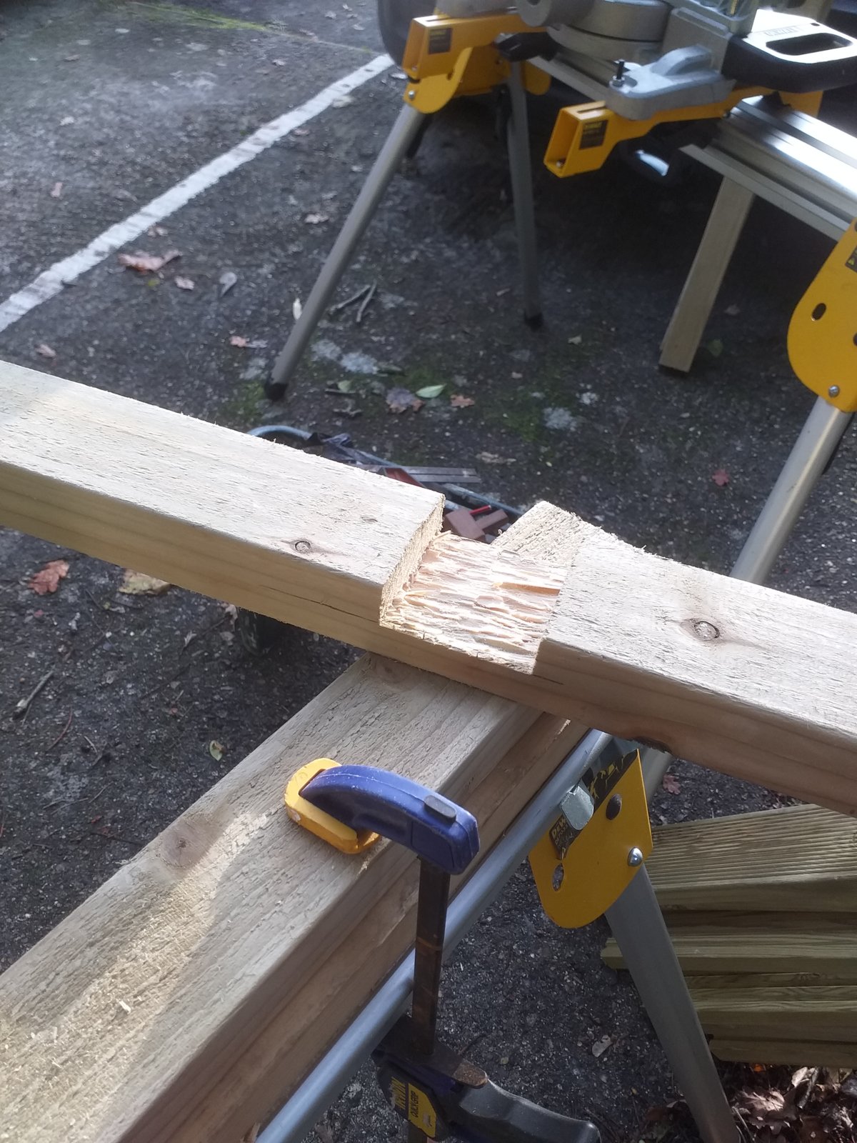

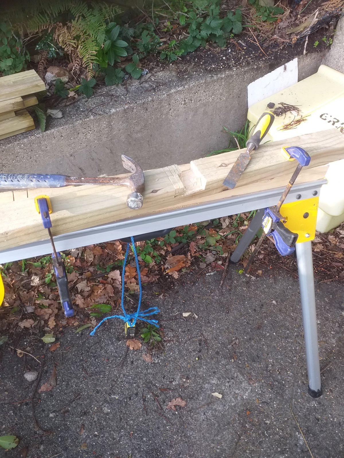

I want to chop half the wood out for a groove. I forget the joint name. I'm doing it the slow way with chisel and saw. I'm sure I've seen people do it with chop saw though. There isn't a depth setti ng on my mitre saw so How do you do it?

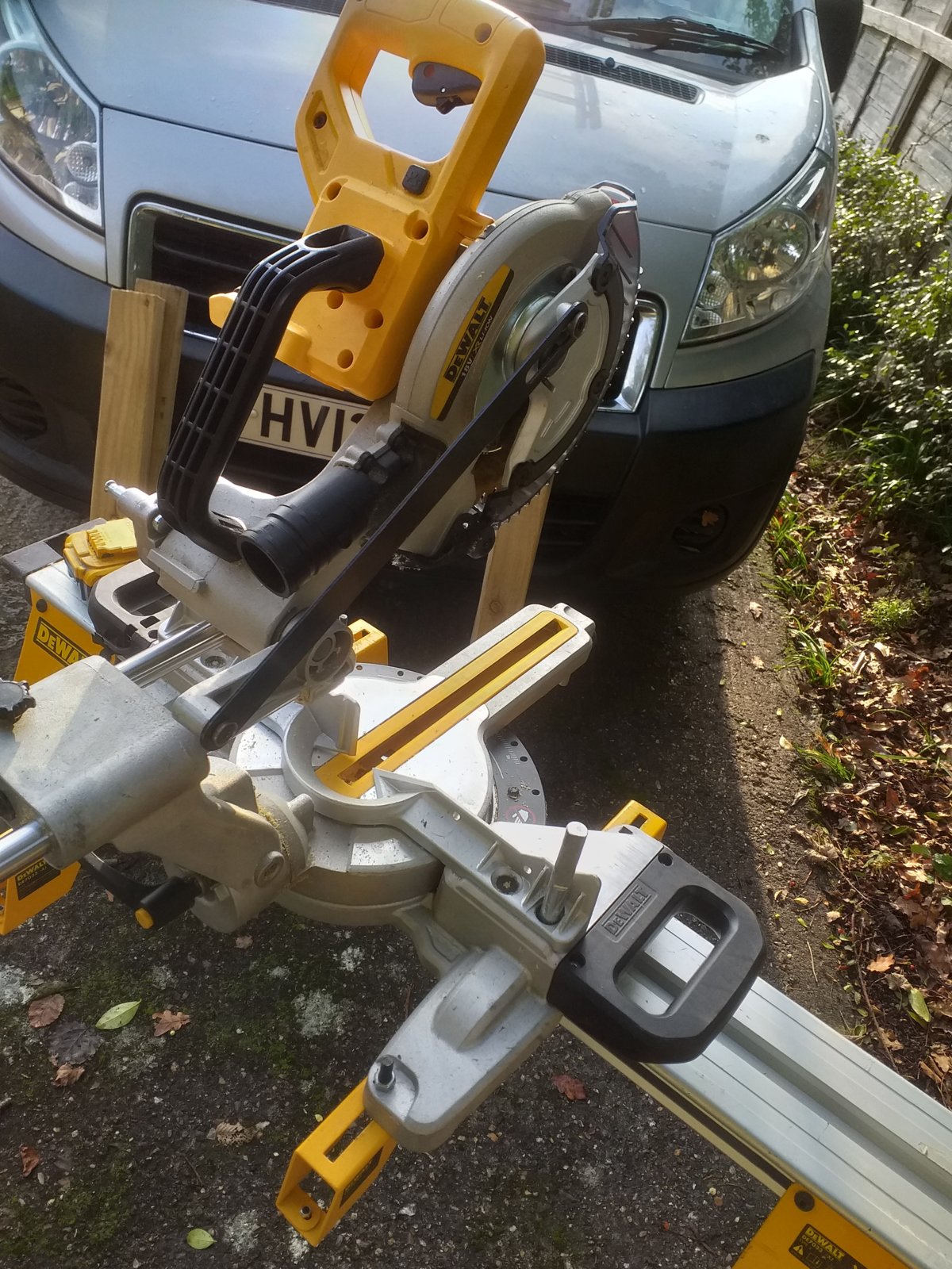

i have made a wooden concentric disk to go over the black round stop on the rh side off the saw
you can stick a bit off say ply on the stop to stop the head dropping so much
if you get it to work you need to pad out from the back fence about 30mm to bring the work at the back level with the full depth blade
It might actually help if your chisel was sharp, you know....... TBH the one reason I'm not a fan of trenching or housing with a mitre saw is that the depth of cut you get on each pass varies too much depending on the amount of pressure you apply together with the amount of flex in the saw itself, so not ideal for accurate work. I prefer a cheap Speed Square used in conjunction with a smallish portable circular saw (or better a cordless) when out on site

also worth pointing out your saw would be better back so the fence is about 20-30mm behind the back edge off the leg stand top
this is because iff you lay a heavy bit off say 8x2" on the saw you naturally to avoid the head lay it quite far forward on the arm and put the weight close to the tipping point out side the leg footprint
Need sliding chop saw for joints , they have depth stops on them .
If you have to use a hammer on a wood chisel to cut, it must be blunt .

If you're making several of these cuts, make a basic jig and use a router.
Yeah that's it.
My brother said a circular saw is the best tool for cutting wood out as you can set the depth. If u can do it with a chop saw that would be good too though.
I guess with a circular saw u have to clamp small bits of wood (like in my picture) down really hard to stop them kicking back.
