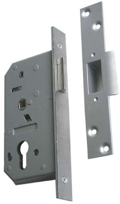

That's how I would interpret it, so that being the case could you not fit a 3R35X euro then instead with a thumb turn barrel for your fire escape and that would cure the spinning curtain issue as well
That actually looks like it could be a solution if push came to shove. I'll take a look at that later, cheers.
http://surelockmcgill.com/uk/customlocks-singlepoint-chubb3r35.html
well that's an interesting curiosity.
I wonder who made it?
Do you think Chubb Custodial know their trademark is being used?i
Not sure, it appears to be genuine though, having said that its the only search result for a euro version of that lock, strange one
I called them and asked how much it was. £235.08 inc VAT and delivery. I asked if it was made under licence from Chubb but the person I talked to didn't know. I just can't see the same lock anywhere else on the interweb either. Strange indeed...
"Union" (Assa Abloy) have the manufacturing rights and the factory, but not a licence to use the Chubb name. Their previous licence expired and was not renewed.
Rather like Rolls-Royce, Volkswagen and BMW.
Quite correct John, I should have said Union or (Assa Abloy) not Chubb and you're right, I've got the box the 3R35X came in and Union/Assa Abloy is all that's on the box. It's so sad a brand like that dissapearing, but there you go.
I wonder if it was originally a Chubb that's been custom modified, custom locks makes me wonder if they've machined the euro 'hole' in the case and modified the internals?
Could be, but wouldn't they have to have a big stack of pre-Assa genuine Chubb locks to modify. I wonder about how sustainable that would be, curiouser and curiouser.
