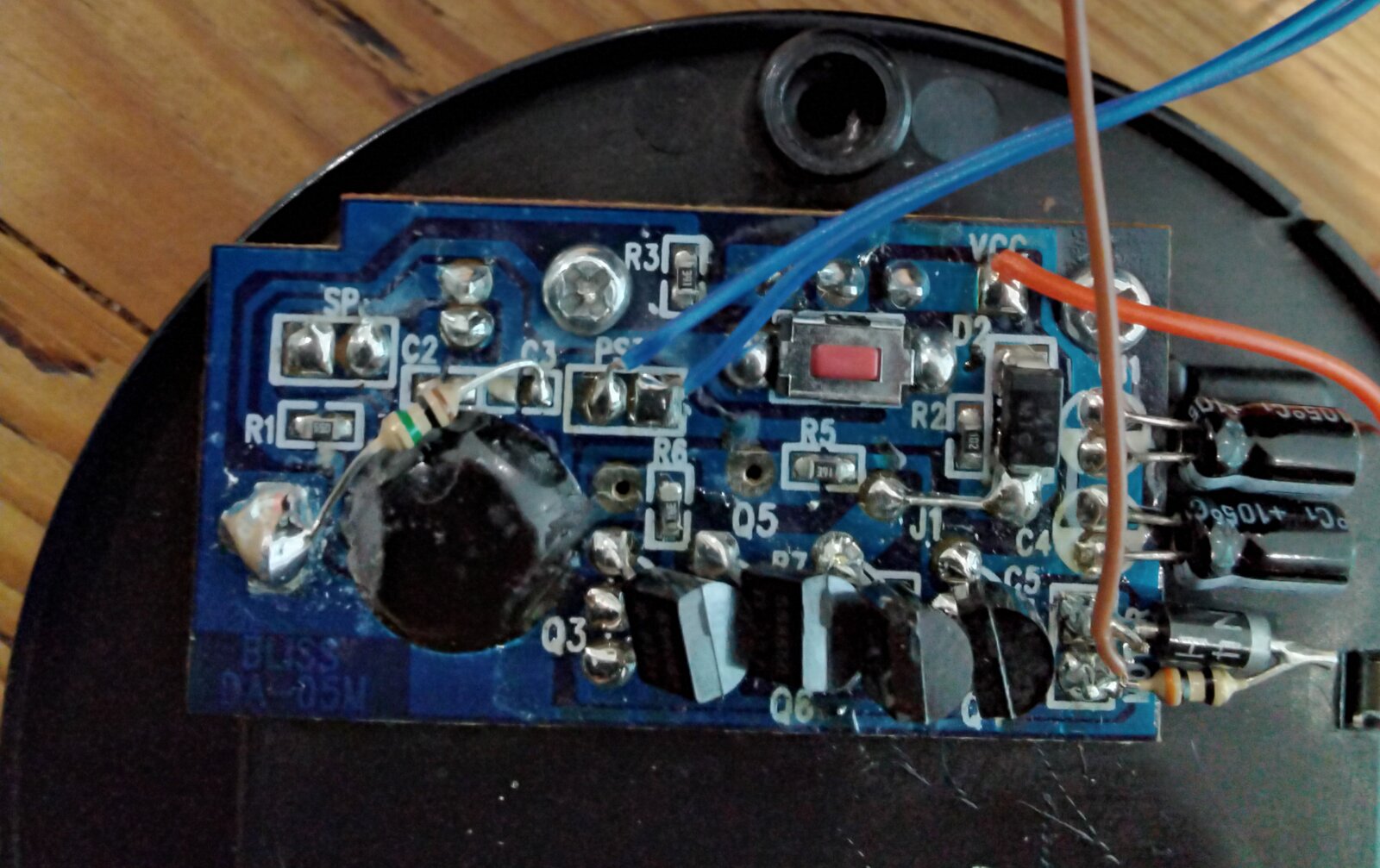

Hi
Please can someone advise where I need to put the yellow wire back on to.
I also need to put a little speaker back on somewhere - would this be SP for speaker?
It's a football toy that waves its arms around and sings (or is supposed to).
Does the yellow wire go to a motor?
The bottom right of your pic shows what looks like a broken strand of wire on the motor contacts, next to the brown wire (where the diode is soldered on).
The speaker should connect to the SP, but I can't tell the polarity of the output (may not matter greatly). Sometimes square pads denote positive, but not always!
Good luck! :)
Edit:
Yes, looking closer at the other connections, the square SP pad should connect to +ve on your speaker (if it's marked at all).
