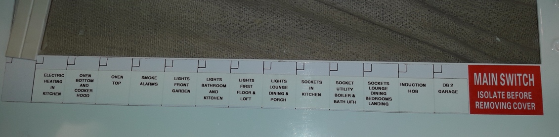

Hi.
Labelling a circuit in a CU Gnd floor/1st floor is quite obvious and logical. What should you do when the circuit is split:
One side of the house Gnd & 1st
other side of the house Gnd & 1st
Thanks.

There are no CU labeling standards (except for - make it too small to read when balancing on a chair!).
I would use something like:
Left- Grd &1st
Right- Grd & 1st
Or
Sockets - Left side of Grd &1st
Sockets - Right side of Grd & 1st
When I did this I used Word to write labels so I could make them a bit more detailed, that I then stuck onto the CU.

You can fit quite a lot of detail on printed labels, further information can be added on a separate label.
