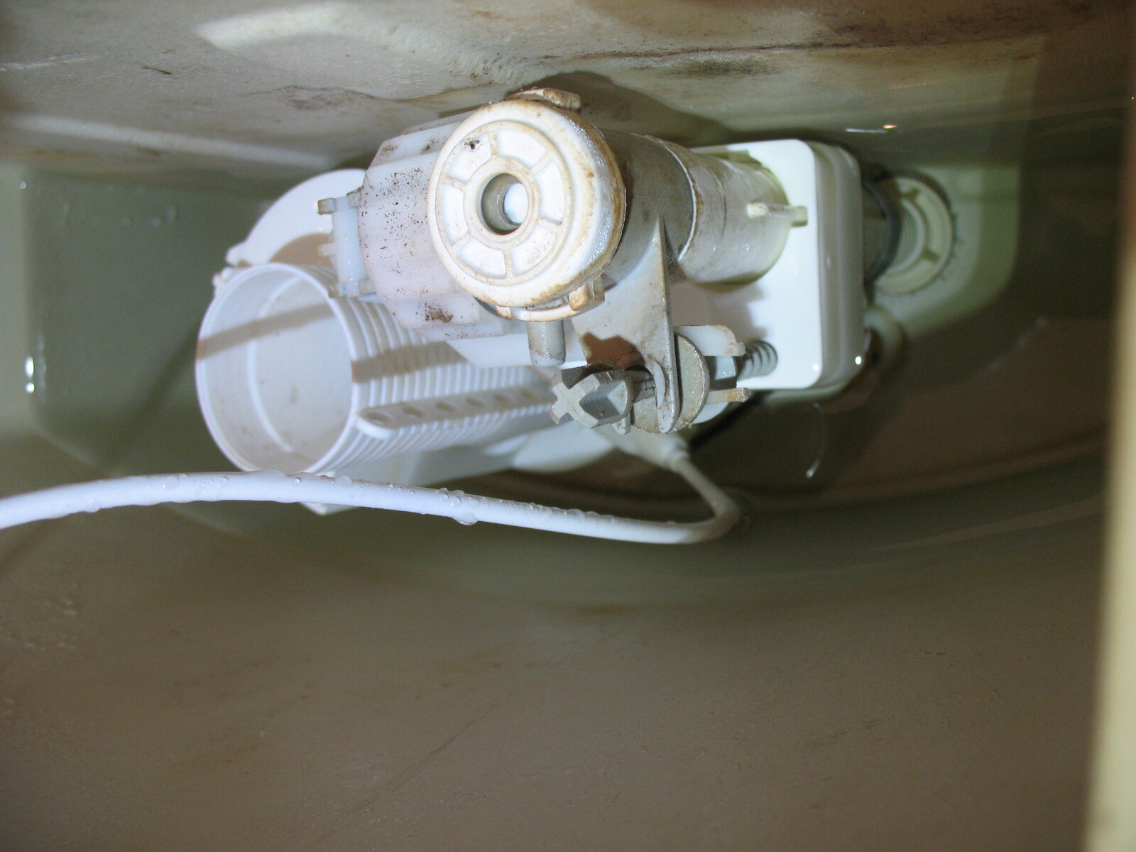

I have an annoying problem that has just started on our Wickes Trento dual flush toilet cistern and wondered if it can be fixed. Firstly, it started to get really slow to re-fill after flushing. Then a couple of days later the heavy flush wouldn't work, it flushed but only a similar amount that the light flush does. We have since discovered that if you push the heavy flush down and hold it down we can actually get a heavy flush.
I have taken the top off the cistern and it looks a bit complicated in there ! I have fixed other cisterns but I really wanted to know if this is fixable or is it a case of a new cistern is required ? Thanks in advance for any help and/or advice that can be given.

It does fill to it's entirety but it has just become very slow. I will try and get some photos. tomorrow.
Slow fill usually means the fill valve diaphragm has a hole and needs replaced...

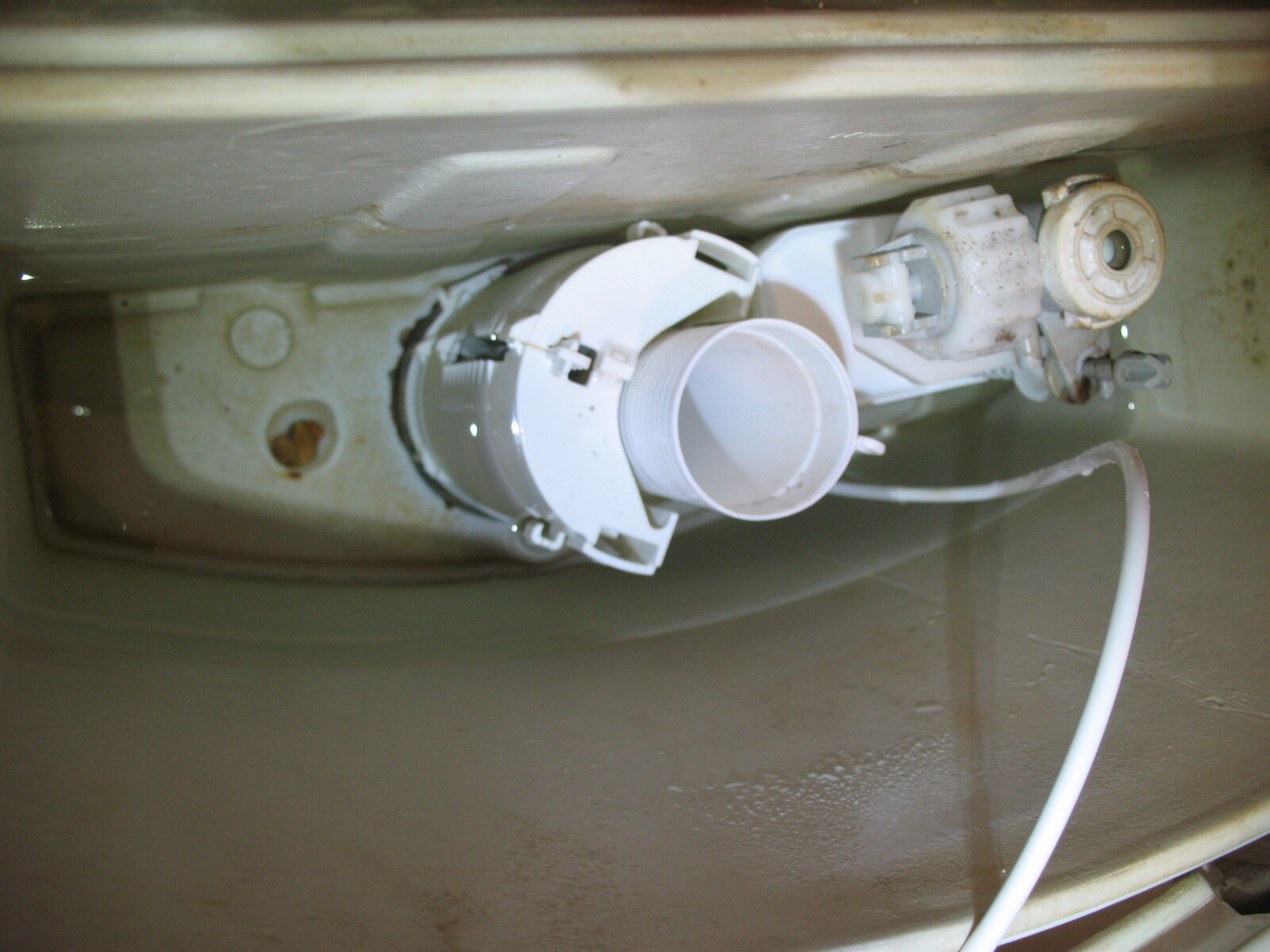

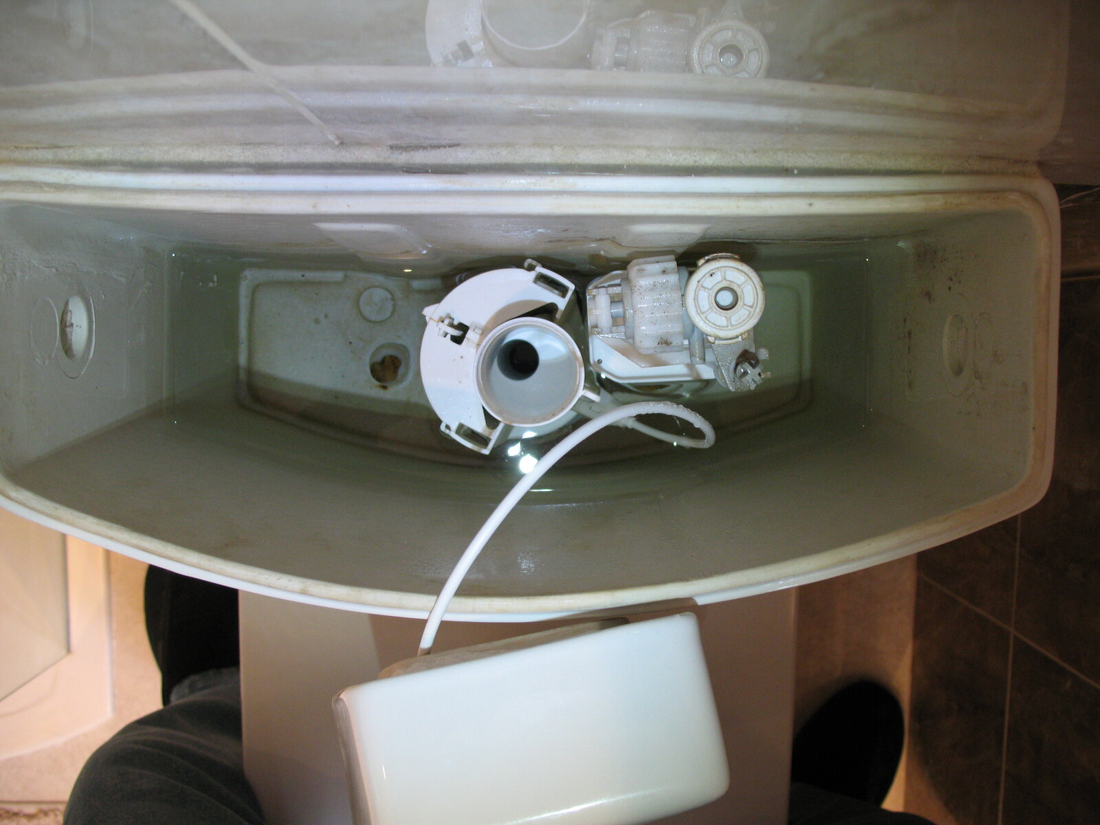

UPDATE I have taken some piccies of the cistern :
Ok, I as initially thought Siamp fill valve and flush valve. Slow fill will be the washer, the poor flush could be the cable. I’m not a lover of the cable types and would swap it out, being Siamp should be interchangeable with something like and Optima 49.

Fill valve diaphragm washer is a doddle to change and cheap. Just unscrew the end between inlet valve and flush valve to access. Changing the entire unit needs much greater plumbing skills.
The flush valve washer ditto - it's a bayonet fitting to remove from the cistern.

Brilliant - thanks very much for your help @Stuckinarut. Is there likely to be a model number anywhere on my valve so that I can cross-refernce it ?
Which valve? Th fill valves afaik are all the same be it 99t or similar. Flush valve as I said if possible go for optima 49, if you need a cable I think it’s optima 50. Have a look on Siamps website.
