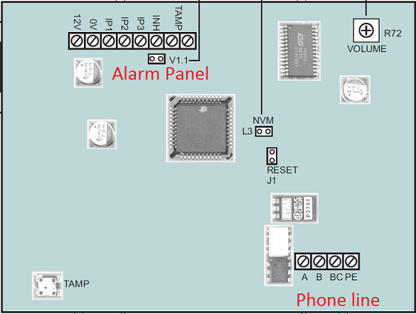

HI - just moved into a house that has a Citadel XR2 connected to an Informa speech dialer. The alarm panel is giving out a double beep every 5 mins which, according to the docs, says there is a telephone line fault.
However, when I open the alarm up, the phone line connection only goes to the Informa and the L/FAIL terminal on the communicator block on the alarm PCB is not connected to anything.

I don't think the Informa has a Line Fail detection output. Does the Informa PCB look like this ? If it does and there are no other terminals then the Informa you have does not detect Line Fail
The L/Fail input on the alarm may need to be linked to something to create a false ( but necessary ) Line OK condition.
Maybe the previous owners had a more sophisticated dialler with Line Fail Detection and took it with them when they moved out.

Yes that's exactly the board of the informa. There is nothing to suggest that they changed or replaced as it was in place from the owner before them.
So since there is nothing to be connected to L/Fail and no evidence it ever was, what other circumstances could cause the XR2 to beep twice every 5 mins?
Thanks but that's the one I read about the phone line fault causing 2 beeps. Could not find another reference.
