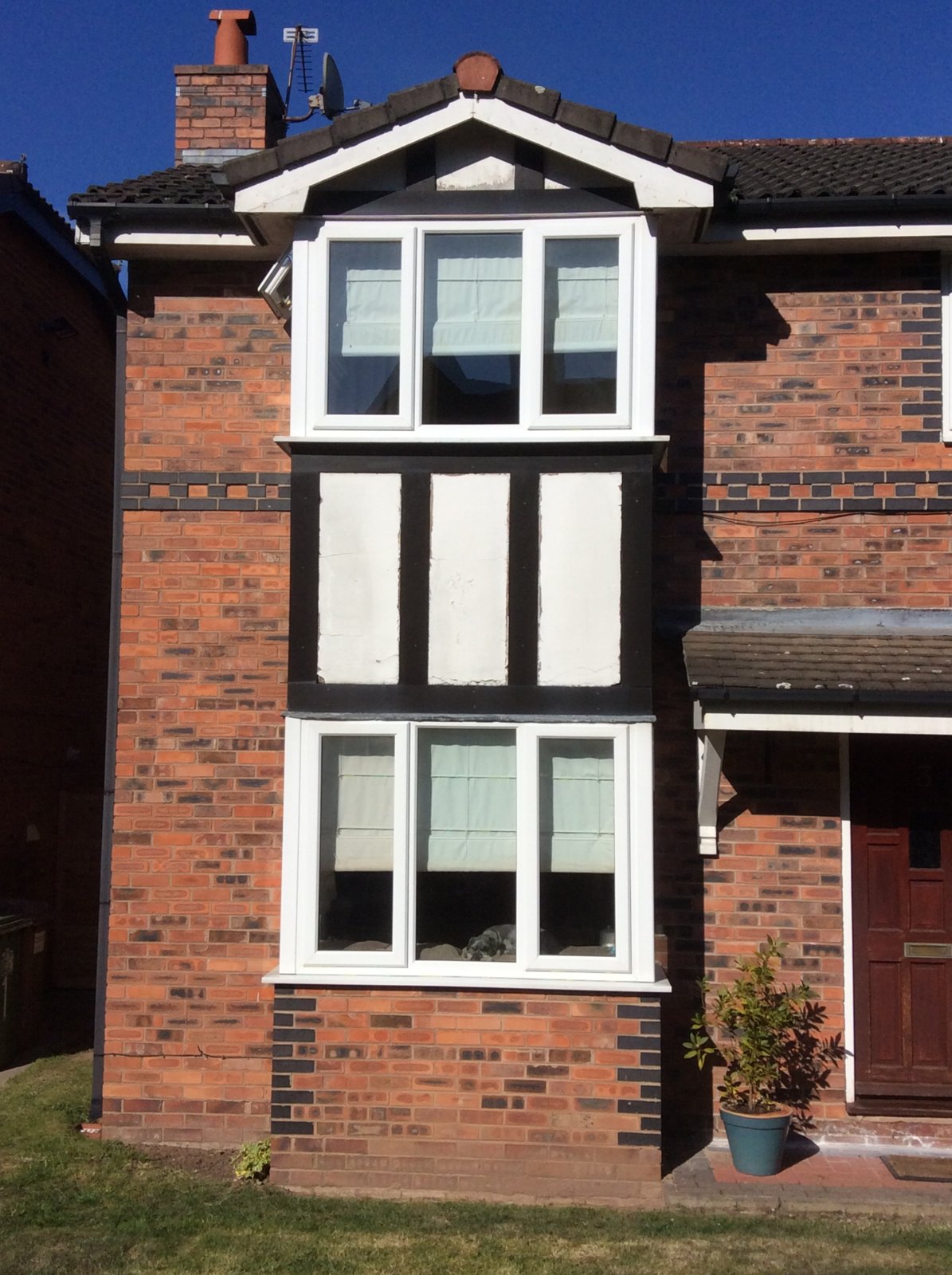

Hi
We have a square Bay that is currently Mock Tudor & a bit tired & tatty.
Cement panels, framed by Wood.
Some of the Cement has crumbled.
I want to replace it with Wood & thought Reclaimed Scaffold Boards would look fantastic & be durable.
Given that Scaffold Boards don’t have Tongues or Grooves, would I need to apply Mastic or some sealant between each board or can I just nail them on?
Any tips?
Thanks!

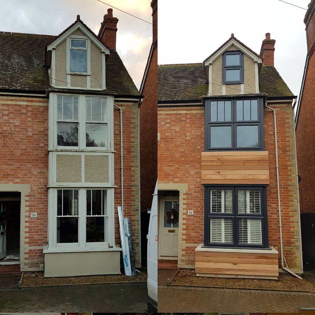

We did this quite cheaply. Is this the type of look your after.

Yours looks like a fantastic job!

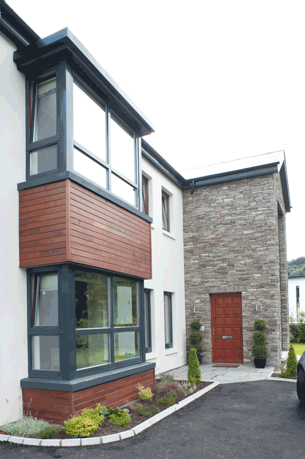

I want to move away from mock tudor.
Attached is a pic of mine now & 2 examples of ideas I want to achieve.
Grey Window frames & Wood between.

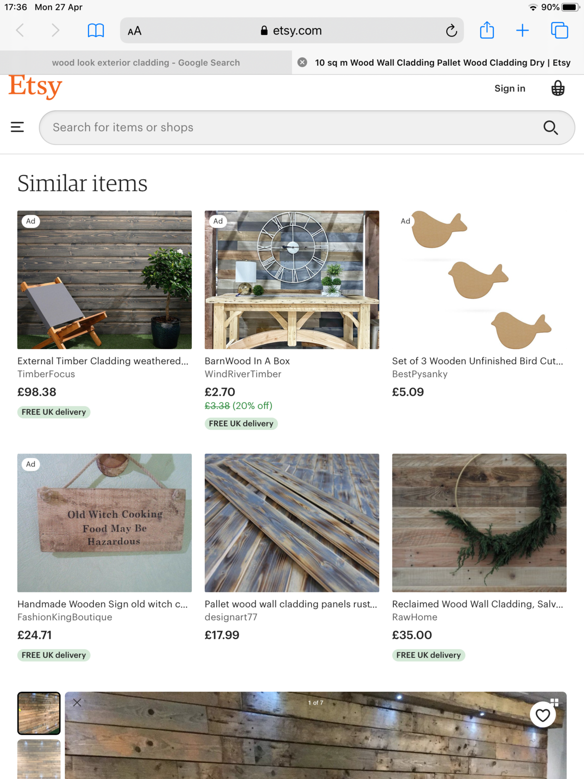

Yep I see what you want to do. Have you looked at Etsy they specialise in wood cladding. Great product to work with loads of choice might give you some more ideas at least. Hope this helps.
