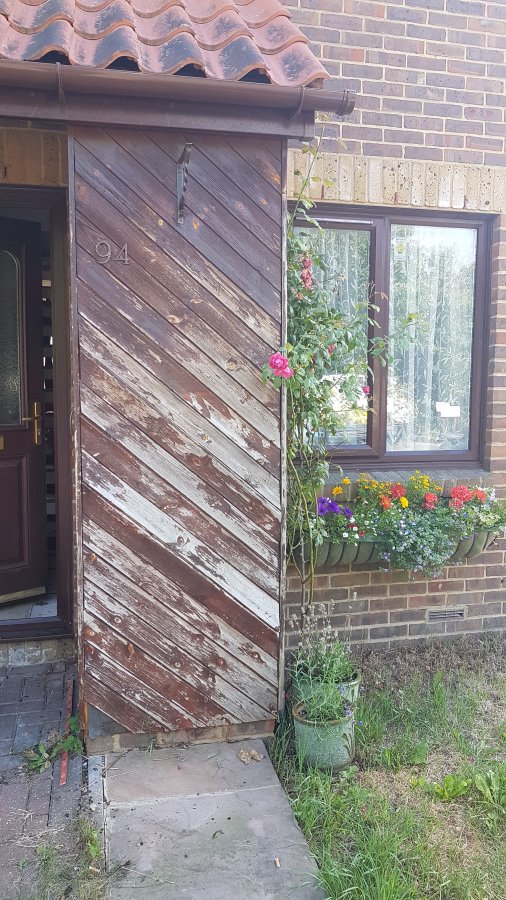

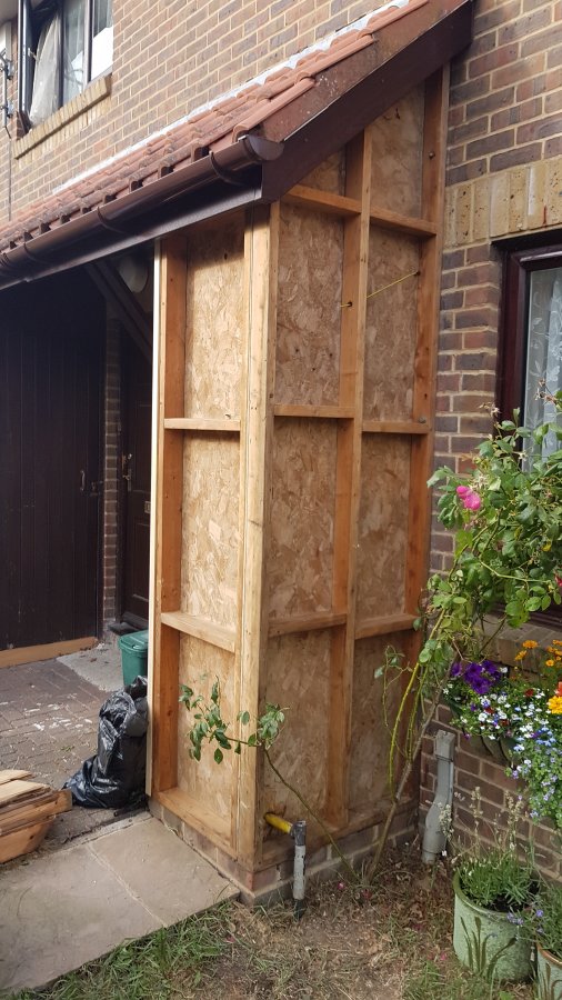

Hi All,
I am replacing the wooden cladding on an outdoor utility cupboard (attached to the front of the house) with uPVC open-vee cladding to match the recently replaced doors and windows, now also uPVC.
I have ordered all the cladding, breather membrane etc. and have stripped the old cladding off so I can see the original construction which used 89 x 38mm battens giving adequate (89mm) air gap behind, however ... my problem is that the old breather membrane was installed OVER the battens, then the cladding directly onto the membrane. Installation details tell me that with the uPVC cladding the membrane should go behind the battens and not contact the new cladding, but I can't fit it behind the battens without virtually destroying the cupboard first and starting from scratch!
As this is retrofit and not new build, can I get away with putting the membrane directly behind the uPVC cladding or will this compromise its waterproofing function and break building regulations?
Thanks, Hugh.

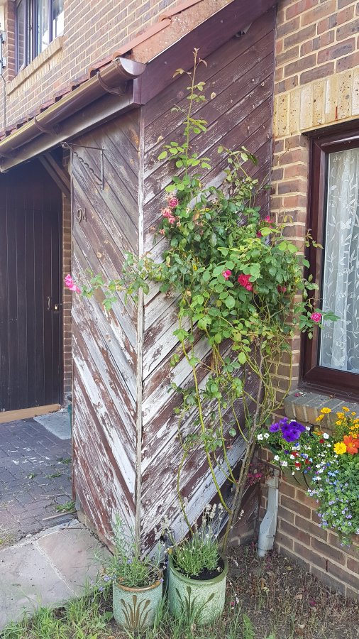

Hi Woody,
Yes sorry, a picture is worth a thousand words!

I see.
As it's not part of the main house (no heated internal room) then there is no condensation risk. I can't see the benefit of a vented cavity behind the cladding either or drain holes, you could just fix the membrane and cladding directly to the frame.
That makes perfect sense . Thanks Woody, you've been a great help Hugh.
