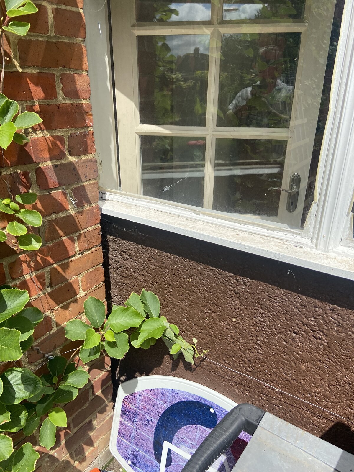

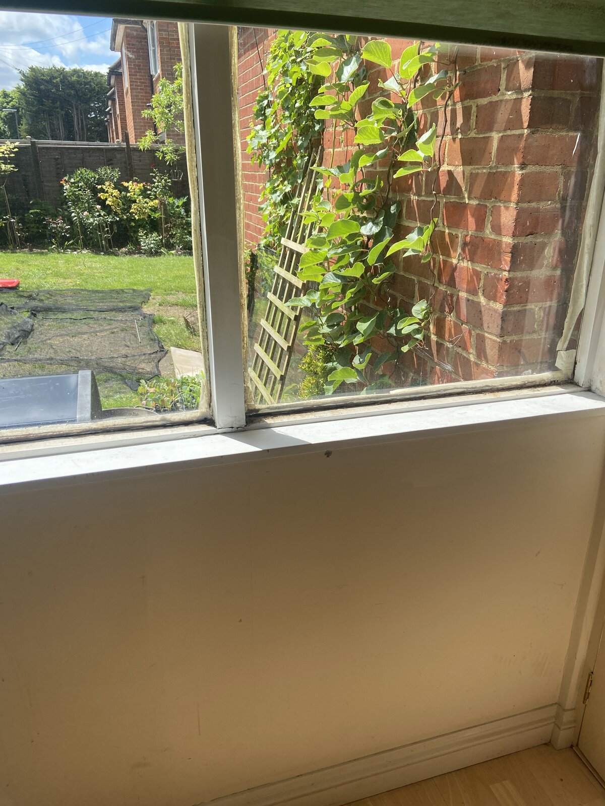

Got an early 70’s side conservatory. It’s half brick and half glazed. I got some double glazed Crittall for one end for light. I then intend to infill whete the glass segments are……..
I’m thinking if just removing the glass filling with 10cm thick insulation, On one side of that (to the inside) plaster board… ……….on the other side (external) vapour control then black plastic ship lap board.
Question is; Have I got the right amount of layers? Here are some pcs inside and outside

You need a cavity behind the ship lap, doesnt need to be very big but at least say 15-20mm (ideally 25mm)
and it needs to be ventilated
If you are keeping the window frame then you will need to detail how you finish where it meets the cill -maybe lap some lead upwards
if you use celetex foil faced insulation you can use foil tape to ensure its air tight and as vapour proof as possible
if you finish the celetex flush to the outside of the window frame then you will need some battens vertically to create the air gap / cavity
depends on the cill overhang on what you can do
i used 5" of celotex for the conservatory, pushed up between the rafters on the inside, then plasterboarded and then painted over the double glazing where the infill was used. It helped, but still expensive to heat.
