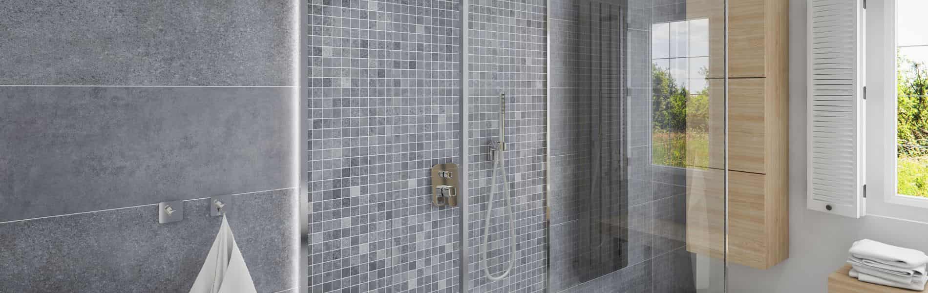

Here are the Panels
and
corner profiles:
https://www.panelcompany.co.uk/collections/trim-accessories/products/internal-corner (both from the Panel Company
