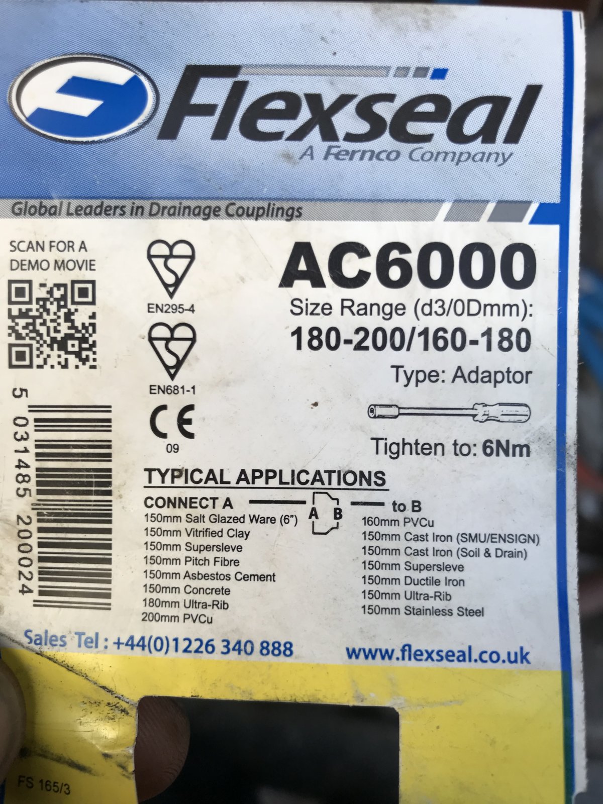

    So we have a build over the agreement and the building officer came, he said we have to replace the channel with clay pipe only not plastic.
    (I have found, not sure if that is the right one)
    https://www.travisperkins.co.uk/Hepworth-SuperSleve-HouseDrain-Pipe-100mm-x-1600mm-SP1/p/711543
    I asked him do we call the water board to come and do the work (as it serves about 5 other properties) or do our builders do it. He said your builders can do it.
    I then asked how to we couple it to the old clay pipe (which is like really old and half encased in cement), can we use those rubber couplers with jubilee clips (They allow for different diameters) I said - he said no. I Think he said to use some sort of clay couplers with quick drying cement - but I cant seem to see them - I only see the flexseal couplers
    https://www.travisperkins.co.uk/Flexseal-Standard-Coupling-100-115mm-SC115/p/221468
    Any help appreciated

    Fernco jubilee type couplers are fine. Tell you BCO to do one.

    There were/are some wierd water companies that insist on clay to clay. Ours is Severn Trent who didn’t.
    Rubber coupling will be fine, use the ones which the large stainless band in the middle too to align the joint and keep it there.

    I don't want to go against what the BO said (unless thames water says it ok) - the problem is how do I do it all in clay? I cant seem to find a suitable coupler. Does anyone have a link?
    And there's the added problem of doing the thing without getting a step in the pipe.

    How very stupid. There are plastic couplings (supersleeve brand) that will join clay to clay but they are rubbish. They aren’t tight enough to stop roots getting in.
    Have a look in Travis, there are loads of different bandseals, the plastic end of the AC6000 should fit over supersleeve. I hate supersleeve, it’s like glass, if I were Thames Water i’d rather have plastic.
