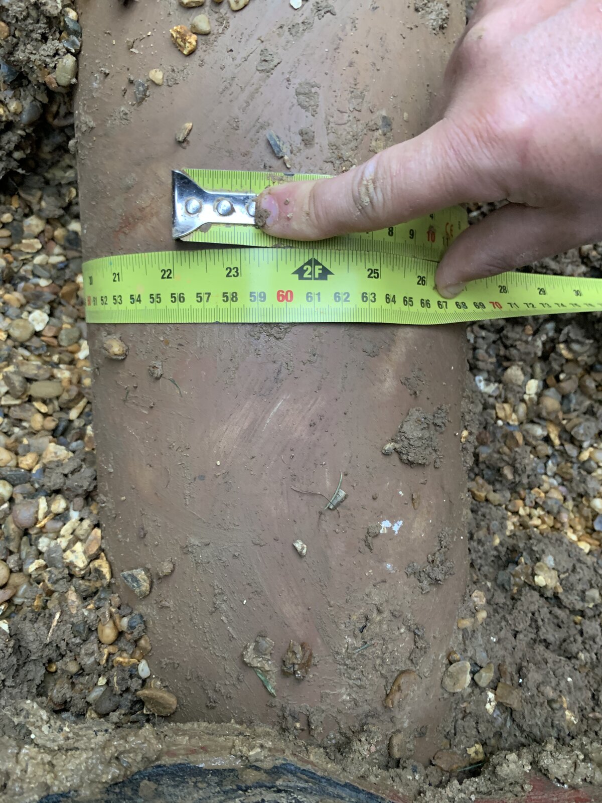

Clay Sewer Pipe 56cm outside circumference
14 Nov 2011
75
3
Essex
Hi All ive located a sewer pipe in the corner of where our extension foundations are going to go. Although the sewer was traced around 600mm further from the excavations. Anyway I've measure the clay pipe and the outside circumference of the clay pipe and it is 56cm any idea what that makes the internal diameter of the pipe.
I have a suspicion im going to be completing a build over agreement with Anglian Water soon.....
Thanks in Advance
Great thanks for the response that means I fall outside of submitting a build over agreement with Anglian as I fall within there guidelines. I will have to talk to our SE to ensure number 6)is followed also. But all the others are fine.
