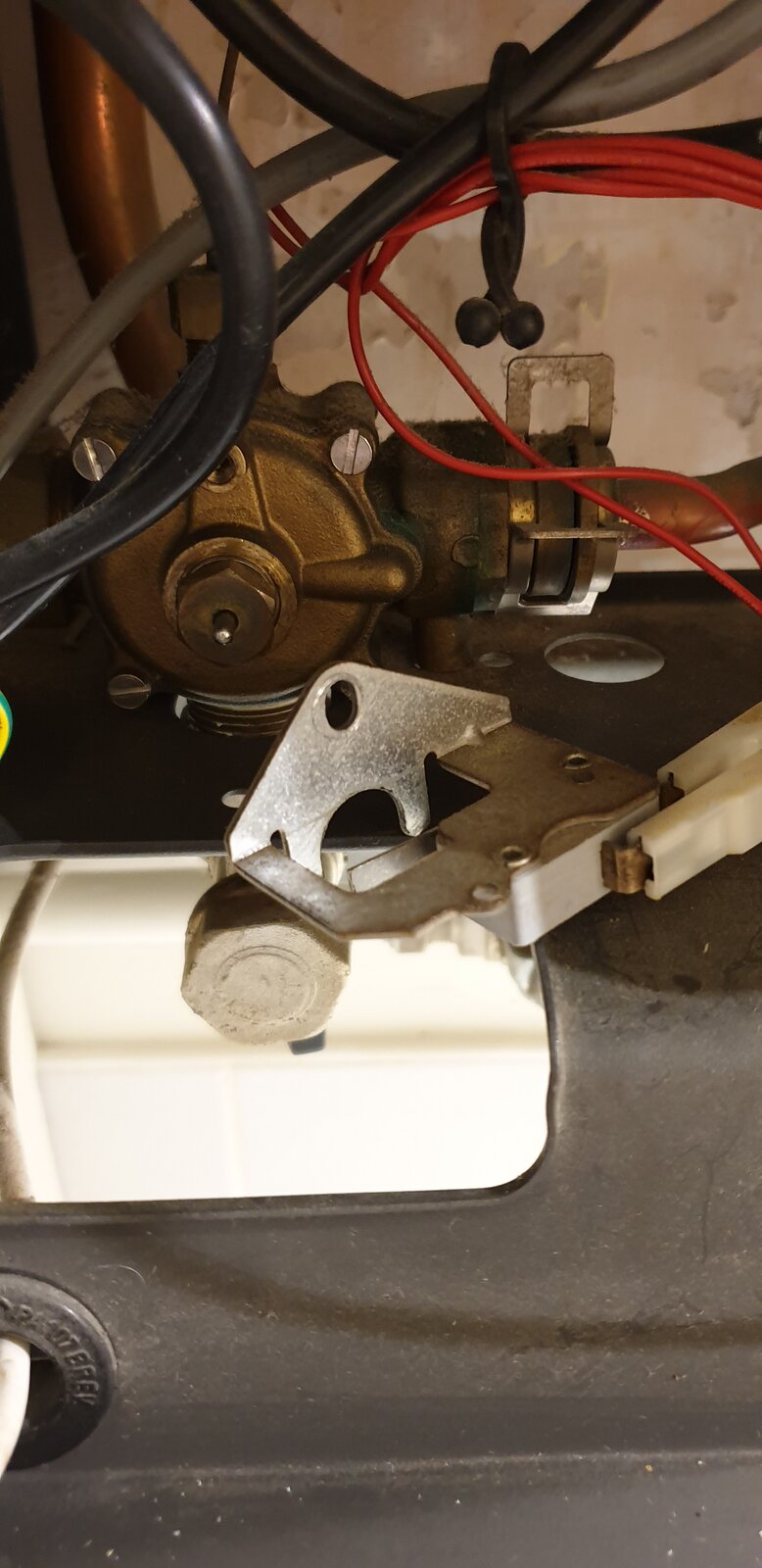

My Baxi system 35/60 boiler gives me the 60degree triangle error "fault on pump or low pressure" once every few weeks. I unscrew the silver part holding the microswitch, spray silicon spray over the pump proving pin, refit the silver part, turn the boiler off and on again and it works for a few more weeks. See attached photo.
I am looking for a more permanent fix. I have seen videos replacing the diaphragm and/or cleaning the pin (removing the 4 silver screws on the gold front). I think this is what I need to do next. However in all the videos that I have seen the diverter valve has been removed from the boiler to show it is cleaned /serviced. I am not sure if I can remove the 4 screws with the boiler turned off and access the rubber diaphragm / proving pin or if I need to drain the water system first.
Do I need to drain it first or will I get a flood of water if I attempt to replace/clean the parts without draining it? I have never drained a system so would probably find a boiler person to do it but if it is simply unscrewing the 4 screws, and cleaning/replacing the parts then I am certainly capable of doing that myself.

The 60degree triangle error "fault on pump or low pressure" happened again. Just reporting it here so I can keep a record of how often it fails.
A quick go on the silicone spray and it is working again, but for now long?
Does anyone know if I can replace the rubber diaphragm and /or pin without draining the system?
No you dont need to drain the system, you do need to drain the boiler and cover the electronics with towels, get a replacement diaghphragm they are pennies and make sure you clean the tiny waterway under the diaphragm

It is a very simple 15 min job, but you MUST cover the electronics, some actually remove the PCB before starting, any leaking water will go straight in there

you are getting confused, the youtube poster called it a bleed valve , it isnt it is a drain point, you use that to drain the primary/system water from your boiler, the other videos are for Combi boilers yours is a system boiler not a combi boiler, you do not have a cold inlet, you may have a filling loop, not the same thing

All sounds good, except there is no need to drain down, but if you drain down anyway - you would then need to add inhibitor to the CH side of the system.

The most important thing to do is , when you remove the diagphragm, you will see a tiny hole in the housing, poke that with a piece of wire or something and make sure it is clear , give the pin a good scrub with pan scourer or similar
