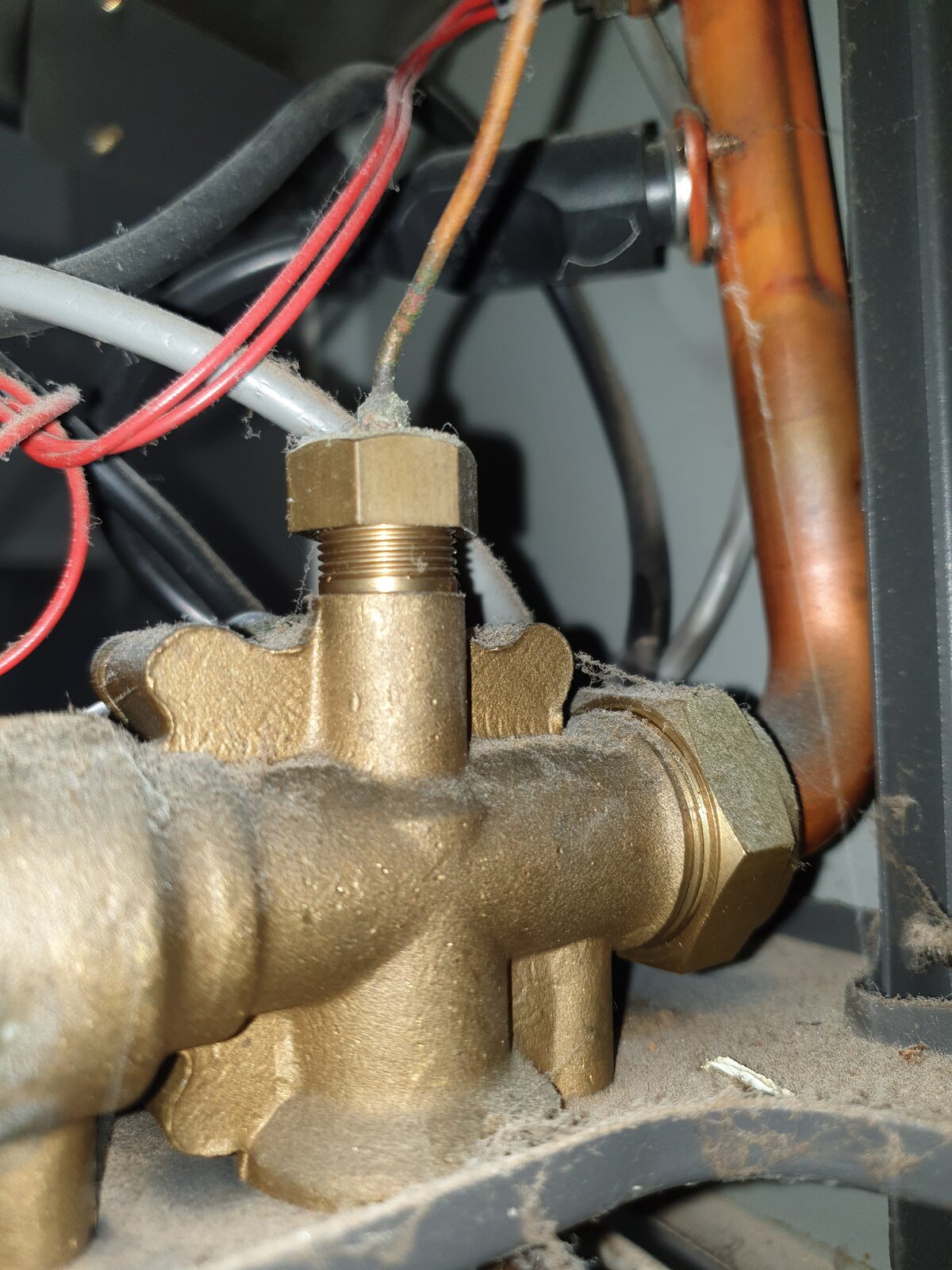

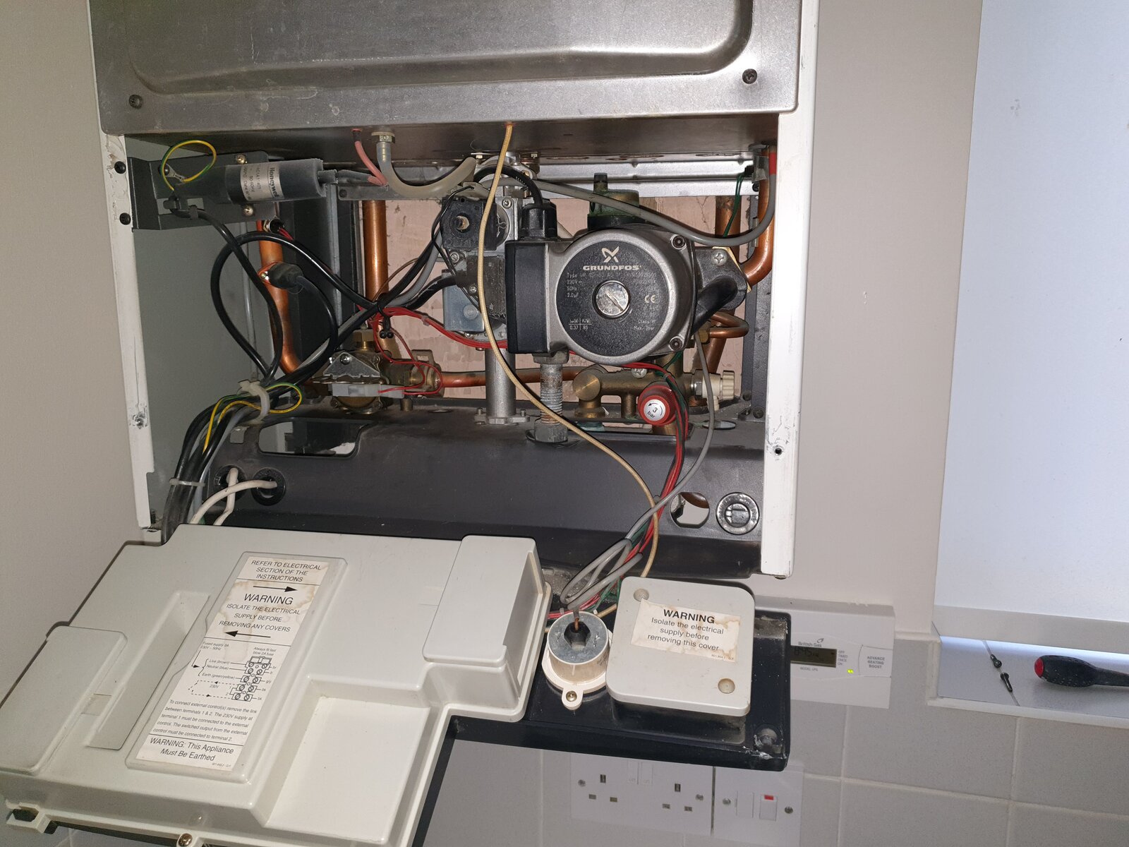

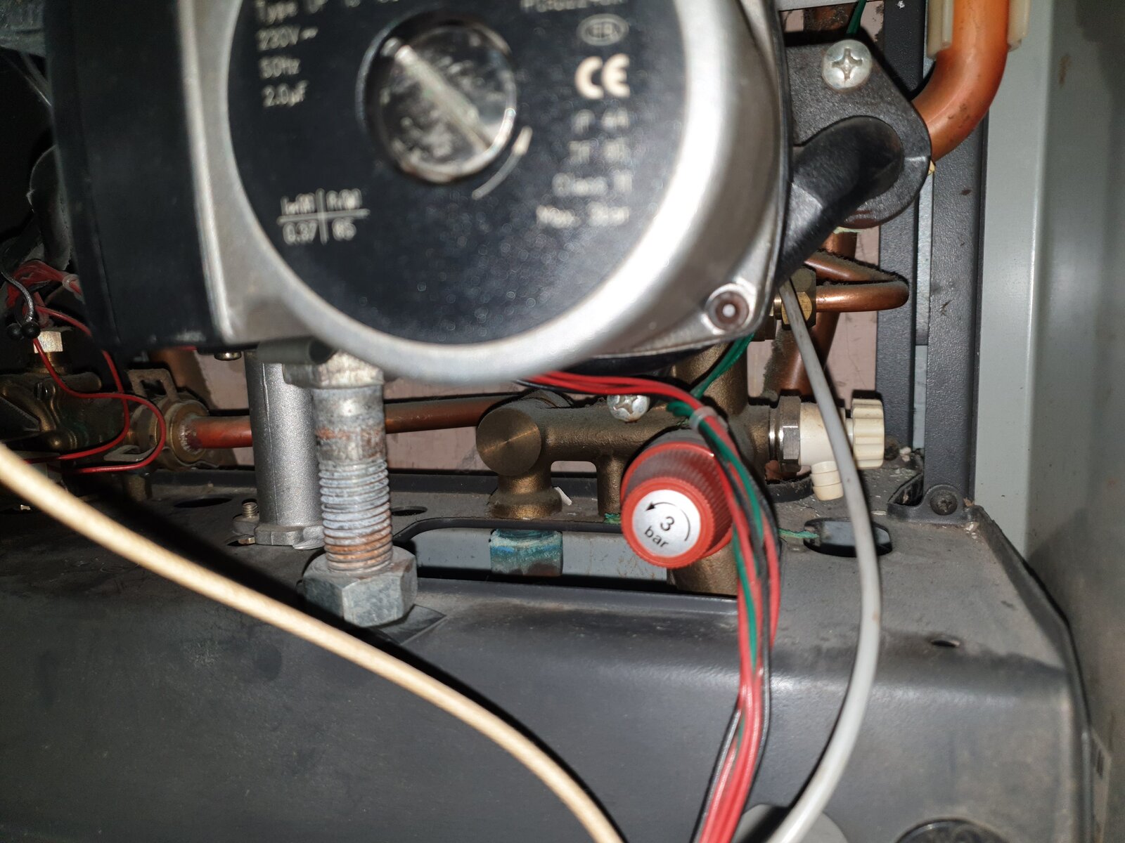

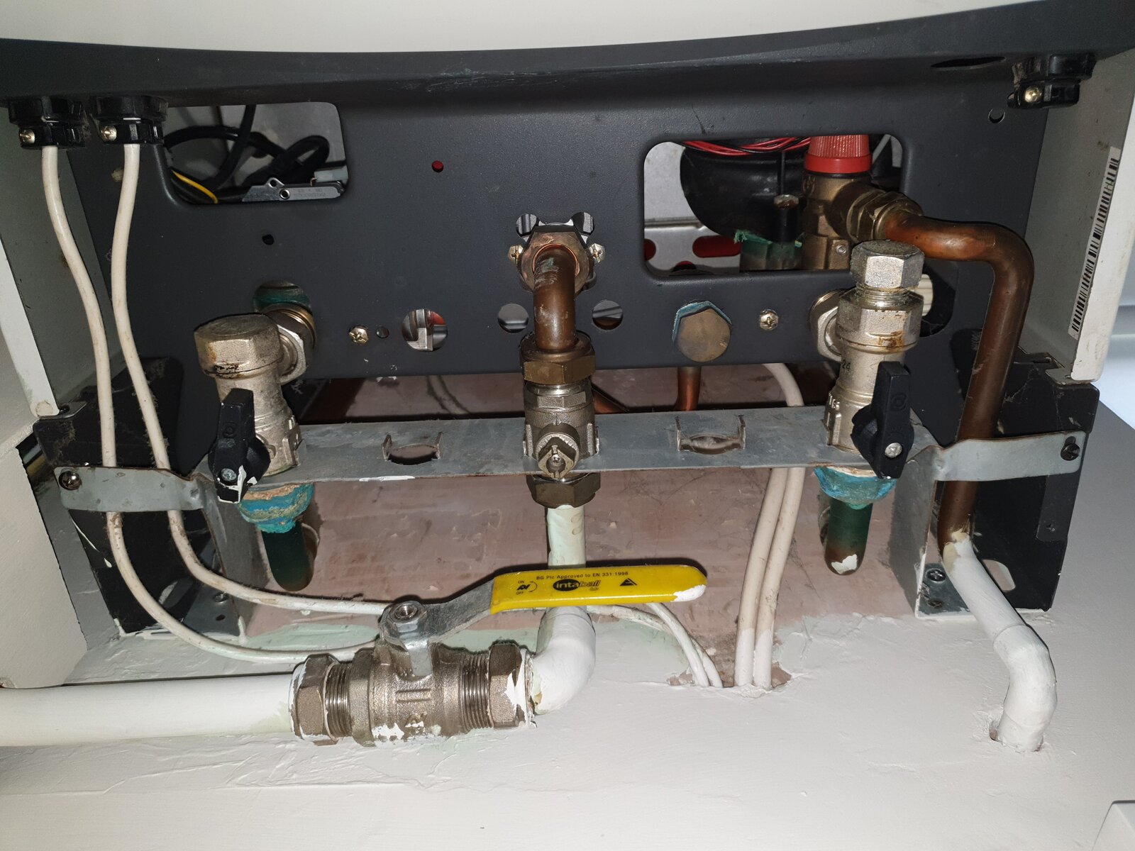

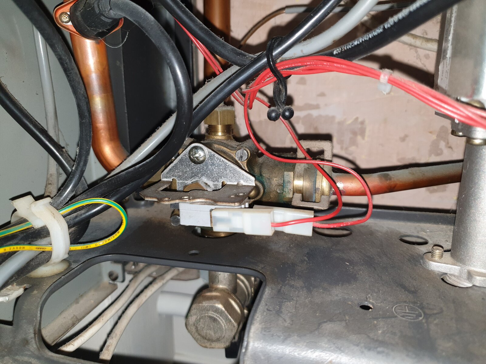

I am attaching photos of my boiler (last one is the back of the unit with the diaphragm). The big bolt on rubber was something I put in to prop up the pump as it was making an annoying humming noise which disappeared if I held the pump).
Can you please explain the sequence required to safely access the diaphragm (and small hole behind it) and reassemble? As far as I can tell the process is now
1) turn off the 2 valves (with the black handles) under the boiler, then connect a tube to the drain off point nipple

12) open the 2 valves under the boiler

why are you so determined to make a very simple job so complicated ? do not touch the isolating valves or they will leak, just do what everyone has told you it is not hard, you are fixated that your problem has something to do with the pin, it has not , a diaphragm works with different pressures above and below and the orifice that supplies the pressure below the diaphragm is partially blocked or the Diaphragm is worn, sorry for being so hard on you , but this is a weekly chore for most of us, if you dont want to listen to expert advice then do it your own way

OK last time , drain the boiler and leave the drain tap open, cover the pcb housing with towels or rags, remove the 4 screws, check the Diaphragm, scrub the spindle and clear the small orifice under the diaphragm , rebuild , close drain and re-pressurise the boiler, absolutely nothing difficult about it, if you find that hard get someone in
Has the pump been checked...a weak pump will result in a low differential pressure being applied across the diaphragm.
Should I mention that all the air must be bleed from the radiators and the expansion vessel pressure checked before commencing with the repair...and I'd be replacing that auto air vent too.
You should close down the AAV cap before startng to prevent air ingress...otherwise you'll end up draining the whole boiler which is unnecessary.

And there's just what I was saying "drain the boiler" as a single instruction but will take a few steps. How exactly is that done? This is what I had tried searching websites, forums, YouTube and failed to find a step by step answer. Is it just open the drain off valve (with a bucket/hose underneath), or does it involve turning off those 2 valves under the boiler as well, or something else? As Gasguru has just mentioned as well what about the auto air vent and expansion vessel as well? I can see both of those.

I managed to find time to take the cover off the proving pin/diaphragm. I cleaned it up and put it back. The draining process was quite easy in the end. I left the drain off valve open while I loosened the cover and more water came out from the drain off valve so there was very little from removing the cover itself. That was a relief as I didn't want a fish of water near the PCB (which was covered with tags just in case).
Only time will tell if it fixed anything.
