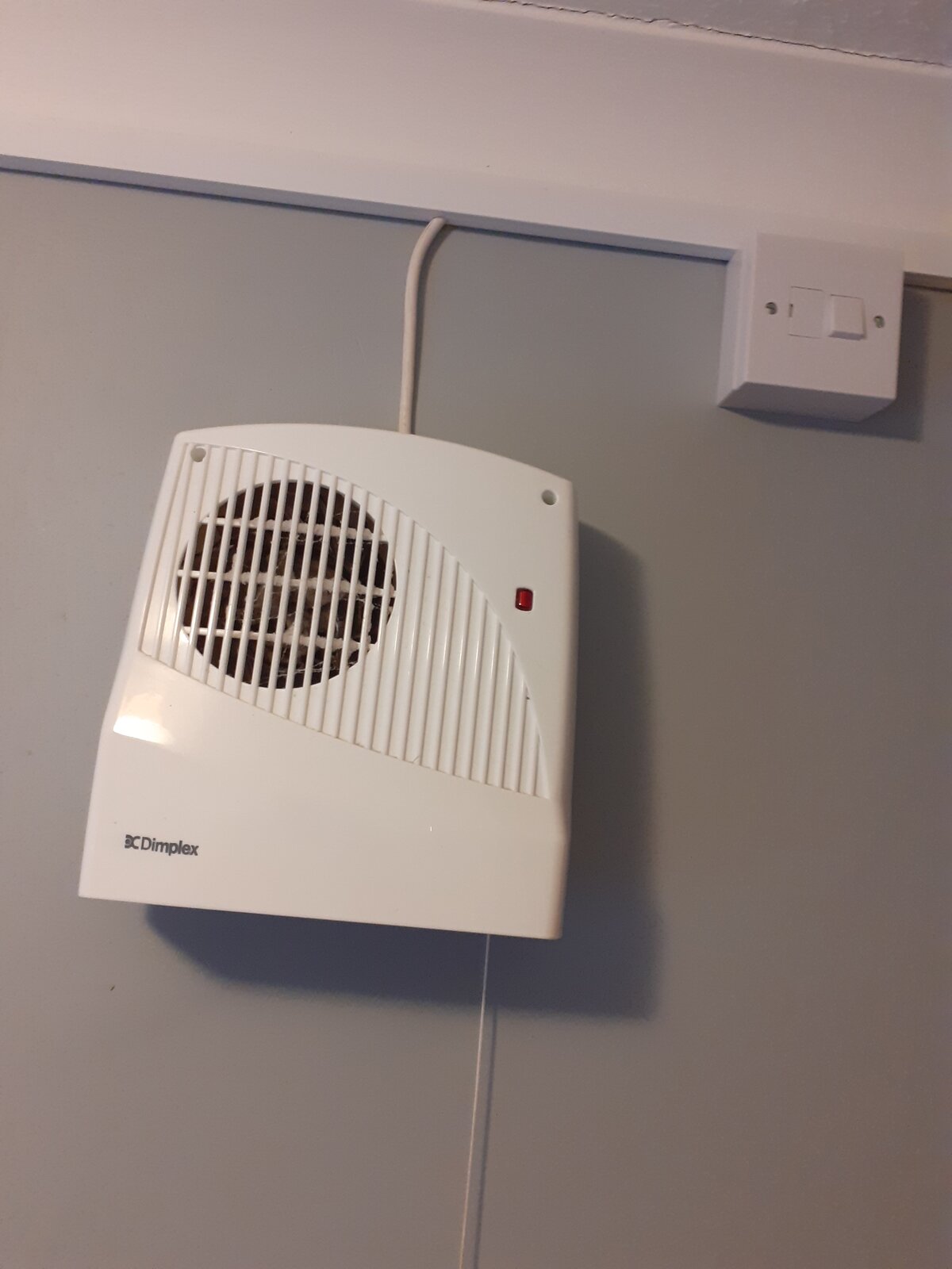

Cleaning inside of this heater with compressed air
22 Nov 2018
1,991
41

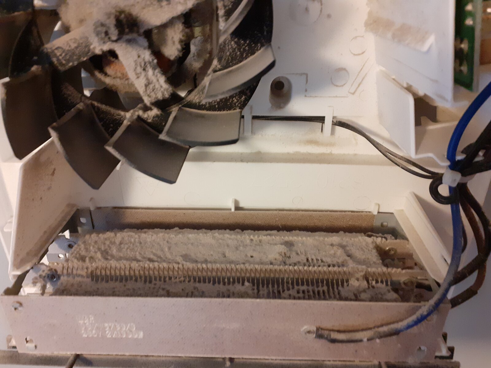

Used vac to clean the dust inside but is it ok to use compressed air? Couldn't get all dust with vac
You should always avoid using compressed air to clean out stuff if at all possible - dislodged detritus can come back in your face and get in your eyes
For small jobs like that I just purchase a couple of tins of compressed air from the pound shop. The "straw" provided with the tin makes it easy to precisely direct the air. You could always hold the vacuum cleaner hose under the heating element to catch the dust. As wayners said, a brush (and possibly cotton buds) will help.
If you use cans of compressed, do not shake them first and wait a minute or two before turning the power back on.
