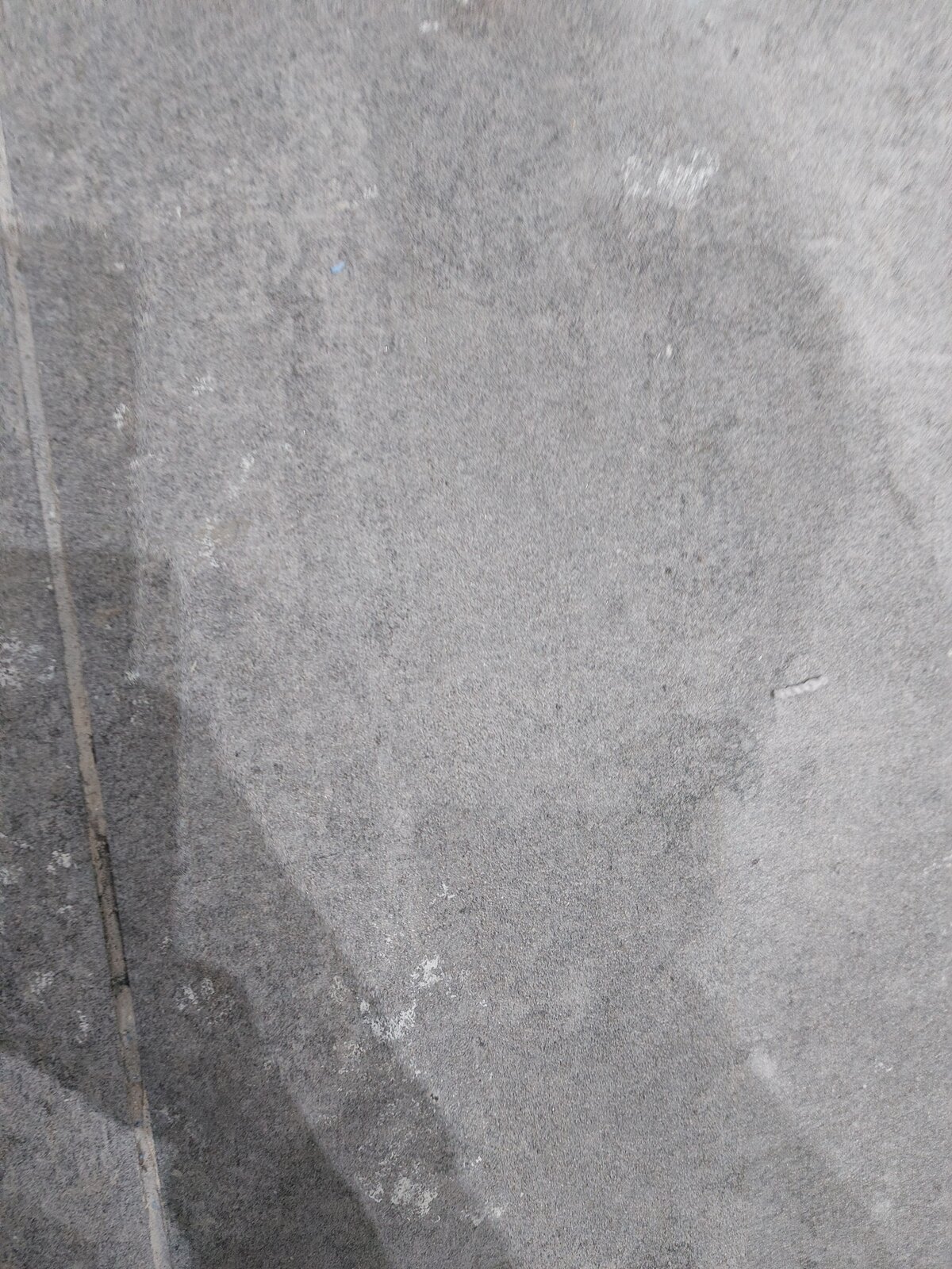

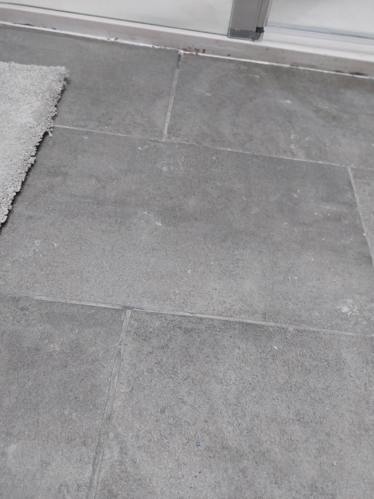

Hi Guys
Hoping someone can help me and suggest the best way to clean up tiles which have adhesive and grout on the face of them. I read that brick cleaning acid is a good method - Ive tried acetone without any joy so Im hoping someone has a good suggestion please?!

Floor tiles or wall?
Is it a waterproof type?
Put one in a bucket of water for a couple of days to find out.
Tile shops sell a scotch pad like pad. It's like a nylon scratching pad that takes off grout. DIY also sell but they aren't very good.
Then any dust left on wipe over with white spirit on a rag...
Lumps of grout need to be carefully scraped off
Thanks guys I was hesitant to post the question as I knew someone would ask the tile material type.
I think they are porcelain but will check if possible. Does the material type make a difference when it comes to removing the adhesive and grout spills?

I think I have these are they different colours (black white and red for example) and do I use a solution of some sort or just hot water? Thanks
Use dry.
Smack or vacuum out dust.
DIY store ones can be small and less aggressive
It's the grout and adhesive I meant.
If it is not waterproof it will soften when soaked and clean off easily.
Is it a wall or a floor?
That picture is floor tiles but Ive got messy wall ones also.
I was rushing the job (keen diy'er) and haven't done the cleanest of jobs.
If you did it yourself, look at the packaging to see if it is waterproof,
