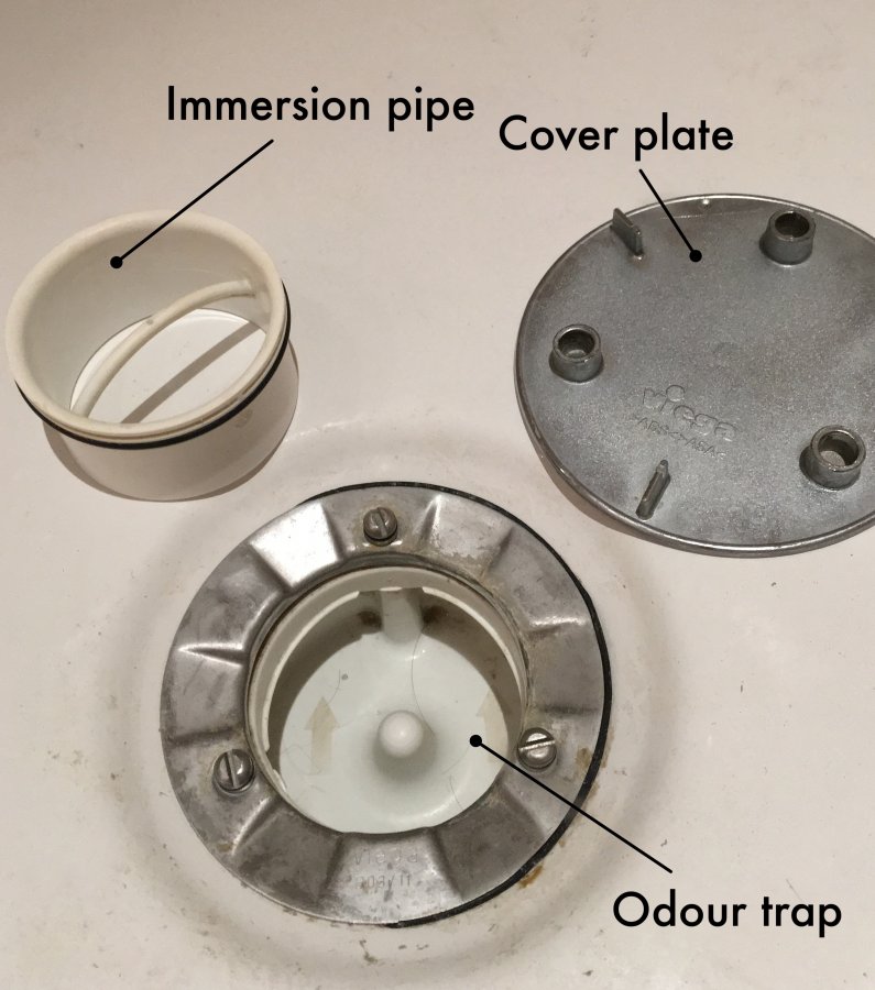

Hi Chris Parker (or anyone reading this) - Have you solved your finding the drain problem yet? I have the same question. I'm trying to figure out how to access the drainage hole after I've removed the plastic immersion pipe. The drain has started to drain very slowly - even after cleaning out the immersion pipe.
The manufacturer is Viega and I've been looking on their web site but I think the model is older. I can only find instructions for new models that have plug on the side of the odour trap that can be unscrewed to easily access the drainage hole and waste pipe. Will I have to unscrew the 3 screws on the top to get to the drainage hole?

does the odour trap lift out ,maybe turn slightly first ? I wouldn't undo the screws if you have no access to beneath the tray ,that could end up in total grief.
Thanks for the reply Terryplumb.
It looks like the lip of the odour trap fits in below that metal ring so there does not seem to be a way of lifting out unless metal ring comes out first.
Rather than take it all apart which is too scary, would a plunger work on this type of drain? I could try that first to see if the drainage flow improves.
plunger won't make an air tight seal on there .try one of the drain cleaning fluids
