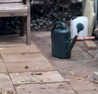

I have extended the paved area with slabs and brick sets, there are a few slabs which are covered with a moss or lichen, and need to clean them so they match the new slabs. Some were cleaned by the gardener before he had a heart attack, () and they do match, but not likely to see him for some time, so looking for some other way to clean them.
Under the watering can are the ones requiring cleaning.
Use Patio magic.
Give it a few weeks to really work as the instructions say.
Quick way is a jet wash. Messy and not much fun.
Non bio washing powder and a stiff brush and water is another way as more sensitive, especially with old coloured slads
+1 for Patio Magic - being the ultimate sceptic about 'green' products, I used this stuff 6 weeks ago on my patio, and there isn't any sign of greenery returning so far.
John :)
For hard surfaces like patios then something containing benzalkonium chloride (BAC) is the appropriate product. That includes Patio Magic (which I have used) and a number of other products. The branded products are c. 7% BAC and you dilute it down to c. 2%.
Patio Magic, etc, are relatively expensive. For regular use you can buy BAC at 50% which is much more economical.
NB Any moss killer will only kill the moss, that is all, it will not remove the dead moss. On a patio the dead moss will need to be removed. Hopefully it will be relatively loose and so can be brushed out.

If you use bio washing powder it has bleach in making it more powerful.
Depends on what you want
Be v. careful about using a trimmer to wire brush the area with washing powder: nearby plants won't like any splashback.

Trimmer did not work, the disk was too small, the paved area has increased less than a square meter, it was already paved, but was a slope, now flat so can place garden chairs on it, and also makes it easier to get my e-bike out of the patio doors.
I used ash from local steam trains under the paving slabs, which is very porous, so water is not retained too much, but it still retains water more than the original.
We must have over 30 trees in the garden, and it is quite amusing watching the squirrels, unfortunately grey, but pole cats are getting closer year by year. So soon they will be gone.
Soap powder is down, so now need to wait a month or two.
