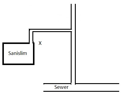

Most pumped systems do when they discharge into a stack pipe. I have never seen sewage coming out of the top of a soil stack where a pumped system has been involved. That said where a pumped system discharges into a manhole ( inspection chamber ) whch has a lateral 100 mm pipe to the sewer some care has to be taken with the benching ( bottom of the chamber ) to reduce the amount of splashing that occurs.
No, but you're asking it to pump into a larger pipe, for it then to find its way back out and to the stack by gravity. Bear in mind what it is these things are pumping, and the size of the pipework involved. The Manufacturers instructions clearly state how the discharge pipework must be arranged, and any attempt to alter, deviate or ignore these instructions is promptly going to invalidate the warranty, at the very least.
Secondly, a poorly fitted lateral into a chamber, particularly from a WC, can cause fouling of the opposite benching, which is the reason care must be taken when laying drains to avoid this scenario if at all possible.
I have one which goes up 50mm and then down about 1500 mm to then run horizontally for about 4000 mm all in 32 mm.
That empties all in one burst of just 3-4 seconds.
I also have a basin/shower going into mine and there must be a non return valve on that entry as toilet water does not cause that to rise.
Makes me wonder if you have a basin inlet with a non return valve which is somehow now leaking???
Tony
As per this
Effectively a soil stack pipe with the vent high enough to not allow sewer gas to enter the building. Or an AAV a foot or two above the end of the pipe from the Saniflow to avoid pumped sewage being blasted into the AAV. Arranging the end of the pipe to be pointing down the stack would ( should ) eliminate the risk of the AAV being contaminated ( and hence not closing )
The vertical pipe to be larger diameter than the pipe from the Sanislim

I did fit the supplied NRV on an upward pumping one and it leaked and caused unwanted pumping bursts every 20 minutes.
Had to find a better quality spring loaded 32 mm one and that solved the problem.
So much for the silly rubber flap one they supply!
