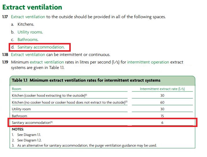

With an underfloor duct, if condensation were created it could sit in the bottom of it. However, I tend to agree that if it's just for a WC then it's unlikely that condensation would be an issue, especially if the duct is insulated. I would be concerned though if there were ever a shower, tumble dryer etc in there.
Also to be considered is the length of the duct from the fan to outside. The resistance created by an extended duct can seriously effect the fans performance, especially if there are also several bends. For the route you describe a centrifugal fan which generates a higher pressure than a standard axial fan would be better. I would also look for one that gives at least double the extraction rate required to make sure it was achieved the required minimum by the end.
The extract below is from the Building Regulations 2010 Approved Document Part F
