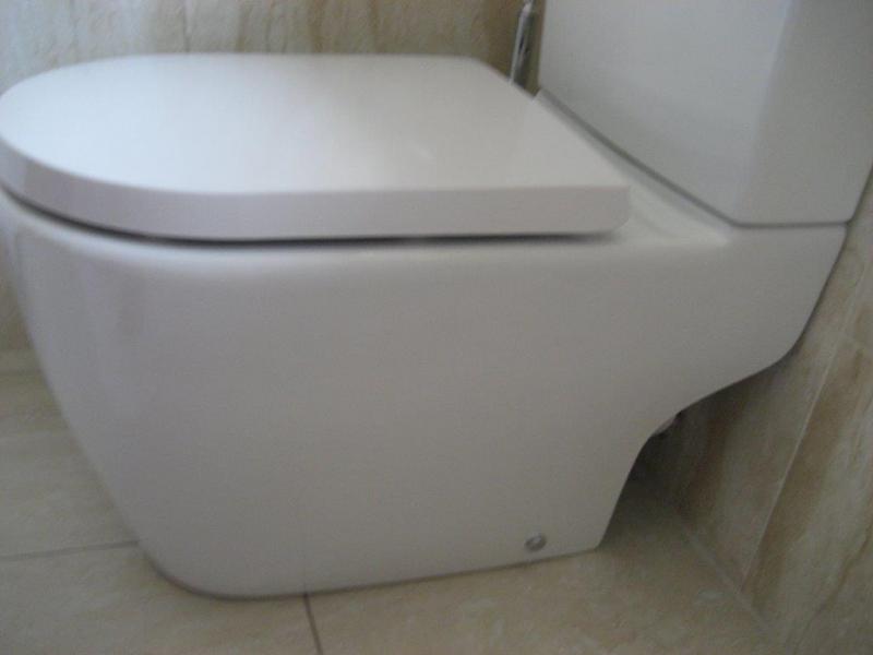

Hi all,
need a bit of advice. please see attached picture. i had a new bathroom installed a week ago and all looks good.
except that we have this very strange issue with the toilet. did not leak for the first 3 days and all of a sudden have started leaking intermittently from underneath.
there is no leak from the back where the water inlet connection is. infact i covered the whole inlet pipe with tissue paper over night and it was dry the next morning but the floor around the base was all wet.
i assume the toilet bow itself is faulty? the strange thing though is , if the toilet bow itself is faulty and leaking from underneath, why is it intermittent and not leaking all the time? we dont get any water on the floor after flushing and may not g et a leak all day. then it starts leaking again the next day. very strange. please advice.
thank you

"Do nut" washer between cistern and pan leaking !!!
Probably misaligned and moved when cistern was fitted

only thing is,ifthat was the case, then the sides or back of the toilet bow will be wet as well, right? ie when the leak happens, i should get wet hand if i wipe my hand round the back and sides of the bow?
but all dry..... :?
Its likely to be the bolts/nuts that go through the cistern that hold it to the pan.
Other potential problems.
Condensation.
Pan connector.
Cracked a faulty cistern or pan
I fixed one of these this morning, the customer reported that it leaked when flushed.
I removed the toilet to find that the 'plumber' who fitted the toilet pushed the pan connector on at an angle and the internal rubber came off inside.
I fitted a new pan connector and applied drain dye to the cistern to check for leaks.
Job Done.

thanks all. just thought i will add a quick update.
plumber came in and we discovered leak was from the actual drain out of the back of the pan. silicone applied and all good now. thank you all for your inputs.
