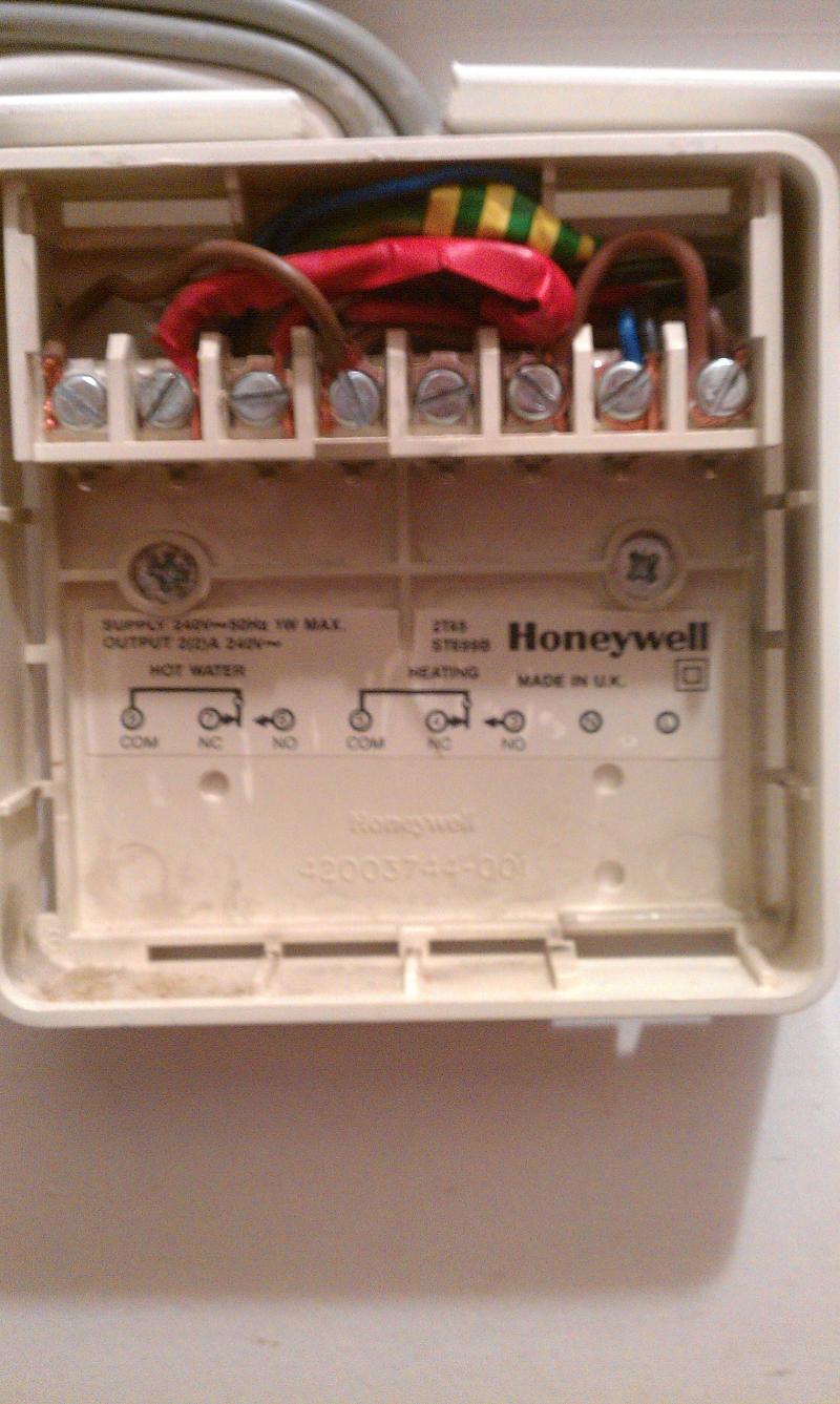

OK so what i've gone ahead and done, is disconnect the CH ON from pin4 in the 10 way chocblock and connect that to pin 1. I have connected the L of the relay to Pin 1 in the chocblock.
At the ST699 connector panel i've put a bridge between permanent L and "CH NO" (red - same wire - now becomes permanent L for chocblock pin 1).
Is that OK?
Or should I remove the connection from "CH NO" from the backplate and connect directly to the L connection?
In other words I am unsure how "CH NO" now being permanently live will affect the ST699 - does it matter?
BTW can the battery be replaced in the ST699?
Thanks!!

Before I started this, pin 4 and 5 were bridged - presumably in lieu of a room stat would that be fair to say?
That's correct. The previous owners have removed the stat and put the link in it's place. Incidentally, you should inform your Solicitor because, unless the previous owners stated on the Fixtures, Fittings and Contents Form that they were removing the stat, the previous owners are in breach of contract.
Connect B to 5 - done (white connection for valve)
Connect L to A - done
Connect N to Neutral - done
All OK
There is a plug nearby that I can use, but thought it would not be best to import a new live into the system
NOT a good idea. The system should be fed from a single source.
I guess I could make use of the now redundant CH ON wire as a live feed, as its now not needed?
That's the solution!
Move wire on 4 to 1 (chockblock)
Move wire on CH ON to L (ST699)
Connect L (Relay) to 1 (chockblock)
All OK
Awesome!!! Thanks - all sorted.
