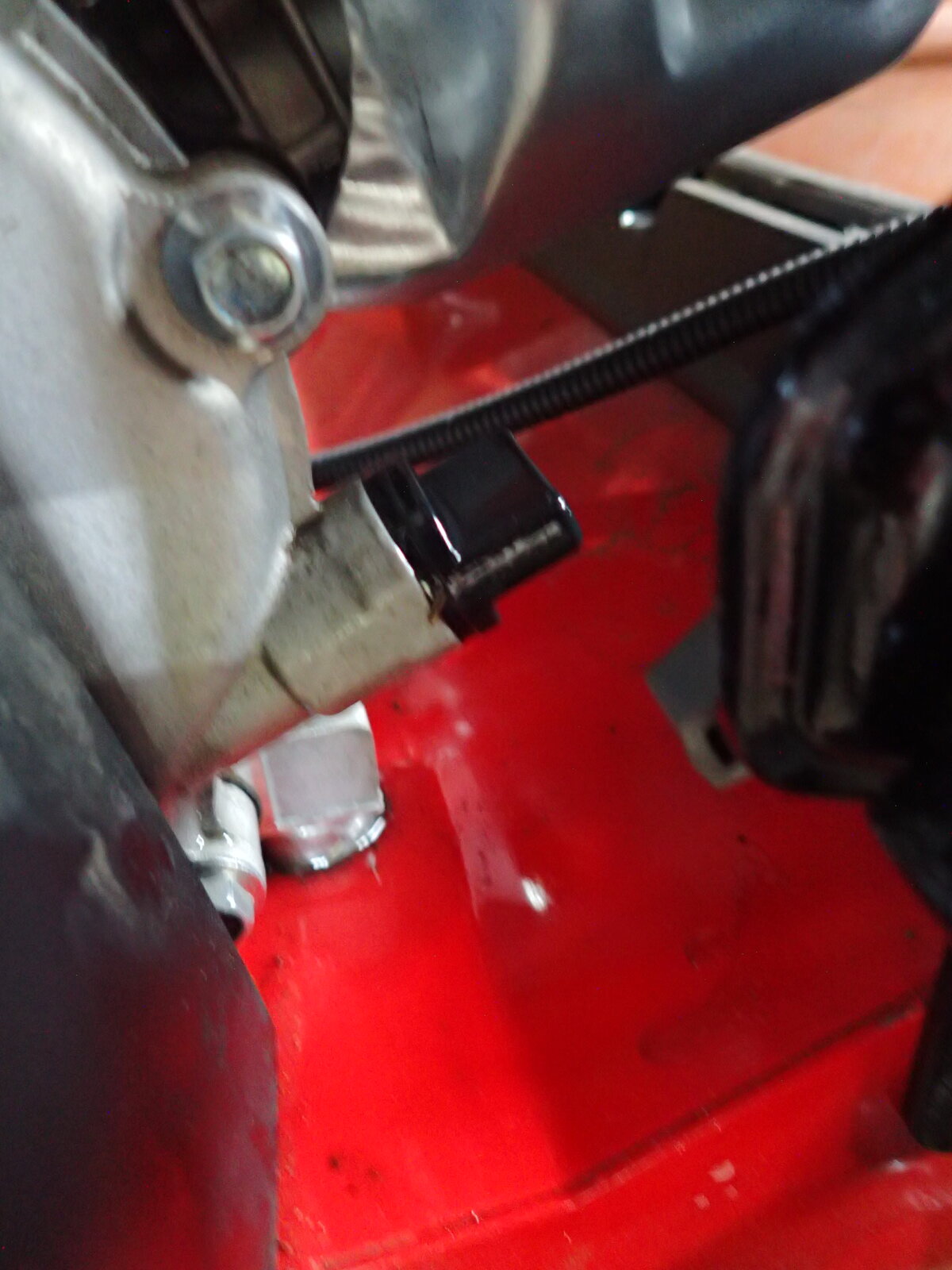

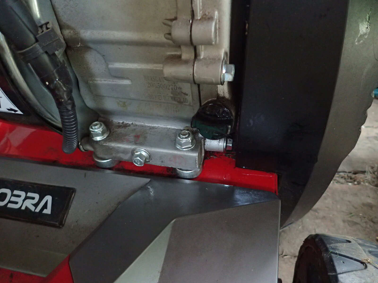

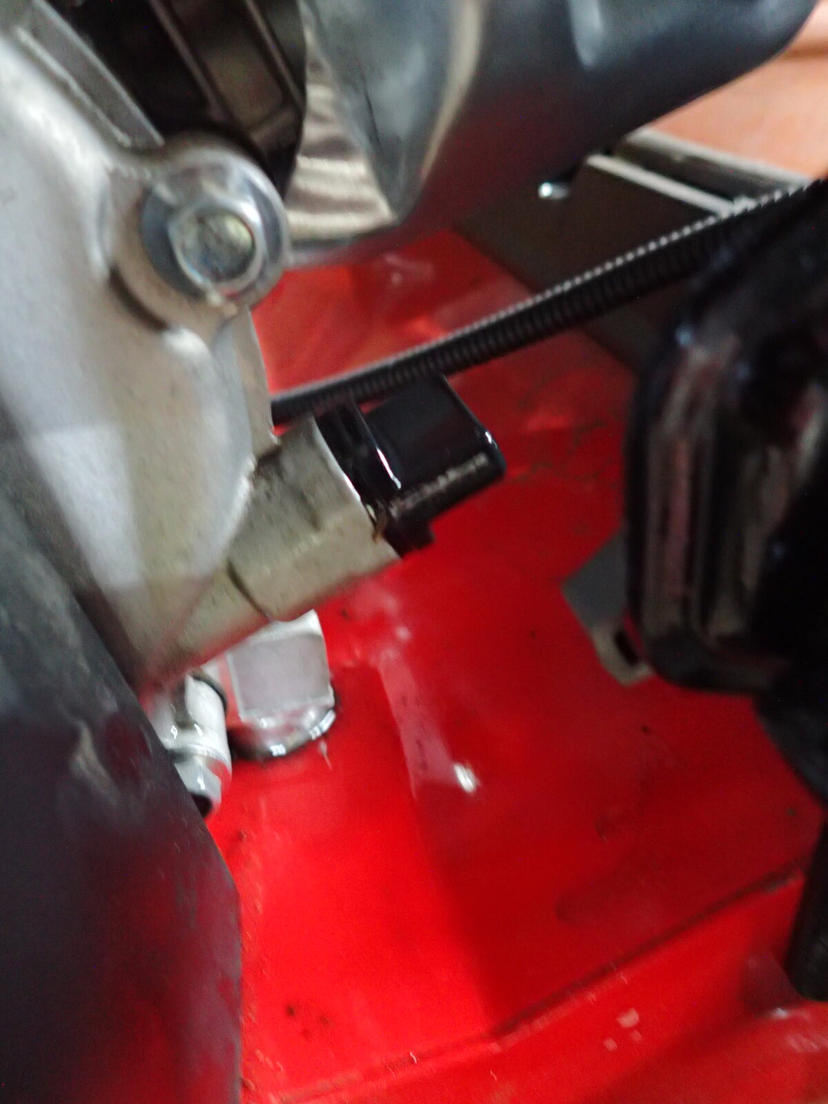

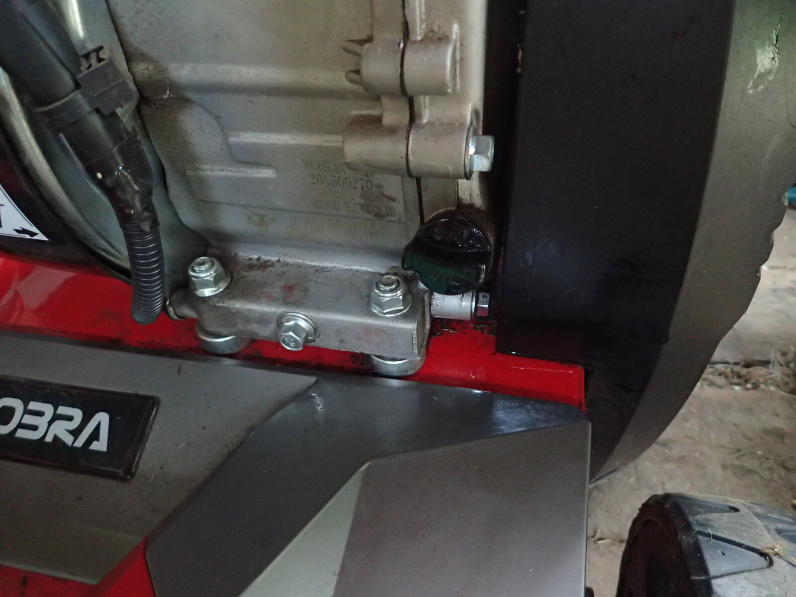

cobra scarifier S40c how to oil change ?
I can see the oil filler at the front of the machine, Can you just tip it forward to empty the oil ?
Hi John
Front and rear plugs have a dip stick attached.
No other plugs viable
John
These engines - like many others - fit onto a variety of machines. Therefore you may find two dipsticks which should sort all applications.
Indeed, sometimes the oil filler holes are much higher than the required oil level, just to confuse the issue more!
John :)

Thanks.
The Filler front hole higher, That must be why the oil just pours out when you remove the front dip stick, I will measure what I put in as not to overfill.
Best not quote me on this one, but I'd say with the front plastic plug removed, oil should be added so any more just runs out - i.e the level is correct when the oil is level with the bottom of the thread.
This should coincide with the rear plug having a slightly longer dipstick......best to refer to a manual of course, if you have one.
John :)
The 10mm plug has a flange socket to large to fit a socket without removing the front tray.
So I resorted to using this below, it work a treat measure the oil that was suck out so I know there was none left in sump maybe some that did not drain to the bottom.
Next time I use it and it's hot I will try and release that nut.
