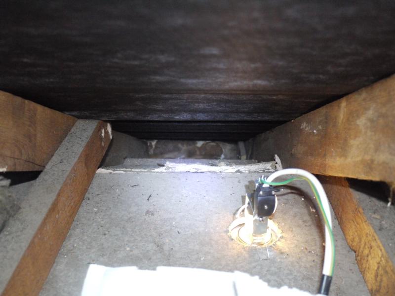

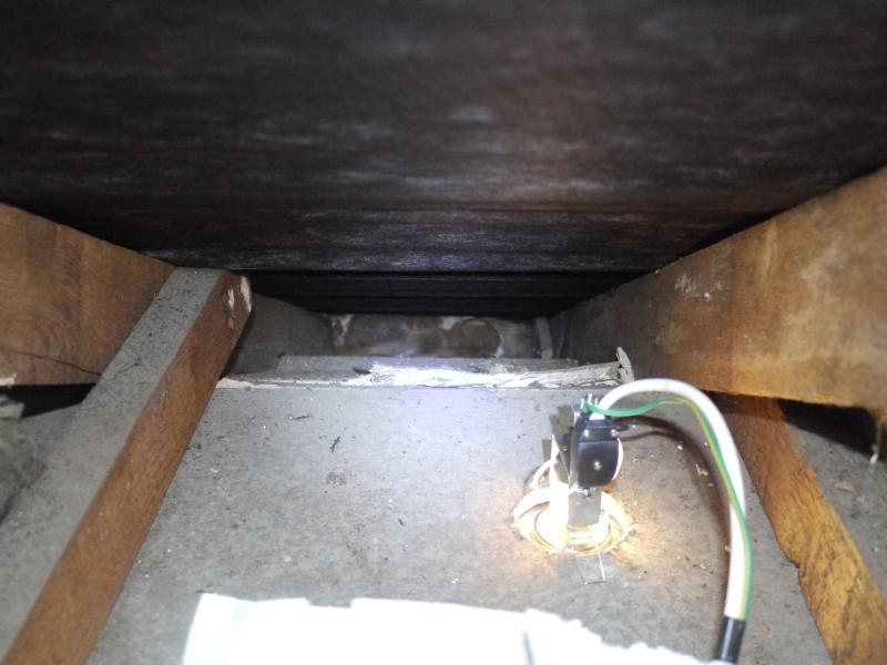

Cold bedrooms, condensation on curved ceilings.
I insulated my loft a couple of months back using 200mm encapsulated space blanket over the top of the existing insulation.
Just after Christmas I noticed a lot of condensation had appeared and decided to remove the encapsulation from the new insulation and check the eaves above the curved ceilings. Some were packed with insulation, I found old expanding foam and birds and wasp nests.
I was able to clear the eaves using a long piece of wood but I intend to get back up there and vacuum the debris from the eaves and insulate. I am conscious of not restricting air flow so was thinking of a thinner insulation slab on top of the slopes section similar to that in the picture.
I may then add lap vents. Due to the limited clearance is there a suggestion of which insulation to use please? I was thinking slabs just for ease and being compacted should help prevent blocking air movement

What sarking sheet material do you have ? If it's the old tarred felt then that's impermeable and you need an air space and ventilation to allow airflow - otherwise you'll get condensation. If it's a modern breathable membrane then AIUI you can rely on that to let the moisture out.

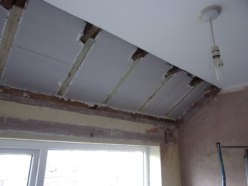

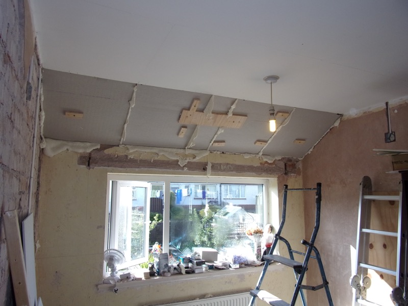

Here's some photos of what I did with my rooms.
Battens on the rafters, first layer of board between teh rafters and all the joints foamed in. Cut off the excess foam, then another layer of insulation underneath. Finally the new plasterboard (and plastic sheet), fixed with thin fixings* to try and avoid creating cold spots with lengths of steel bar conducting heat through the insulation - that's the theory anyway :rolleyes: :

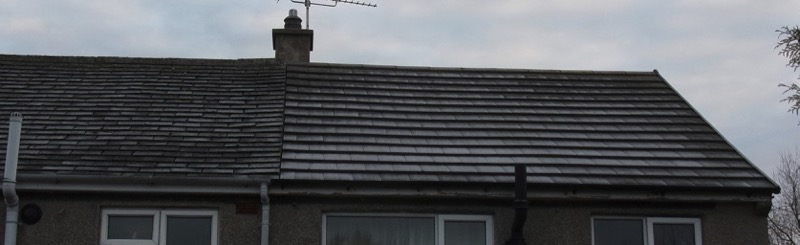

And one cold morning, I got a snap of the frost on the roof. You can see that the bathroom (to the right) has a lot less front on it, and the neighbours (to the left) had b***er all frost left on. At this point, the main (flat) ceiling still needed some insulation adding, so the sloping bit was the best insulated of all :
BTW - I put a sheet of plastic between the plasterboard and the insulation to keep room moisture in the room so it can't permeate into the insulation and condense there.
* Don't look too closely, those aren't actually the right fixings - they sent the wrong ones, but I didn't have time before the plasterer was booked to get the right ones :mad:

IMO, the most effective method is to pull the ceiling down and re-instate it after insulating properly. It's messy, and it makes more of the sloping bit in the room, but it gives you as much insulation as you want with minimal cold bridging. It's also the most disruptive and best done when doing other major works - in our case, both bedrooms needed some walls re-plastering from the bricks up and I was doing other work (adding sockets etc) as well, so the disruption didn't really matter.
It is important that the insulation fits well. If using batts of (say) rockwool, then they need to be a tight fit. If using rigid foam, then they either need to be a tight fit (fiddly to do) or you need to foam all the gaps. If you have gaps round the insulation, then air will circulate and reduce the effectiveness of the insulation.
Simon thanks for taking the time to provide all the information. I don’t have any condensation issues on the bedroom ceilings I am looking at it really to prevent heat loss. The flat sections are fully insulated but the slopes aren’t.
I went in the loft today and using a good length of PVC pipe attached to the hoover I was able to remove anything in the eaves space. This was old foam insulation, nest etc.
This was beneficial as it confirmed we do have a leak near the chimney so gave me confidence in employing someone to rebuild and weather proof it. I was able to remove damp material as well so pleased i did this.
I intend to slide insulation slab down the eaves to maintain an air gap. I intend to use 100mm omnidirectional slab to hopefully help with the handling.
Can anyone recommend a tradesman who can do this job for me.
If I decide to overboard, is there any chance condensation will just occur underneath the insualtion board.
You are lucky. Cold surfaces like these are where moisture condenses - and when it gets bad enough then mould will grow. Even without mould, those cold surfaces will be damp deep into the materials.
How deep are the rafters ? Likely 3"
If so, then you'll only get 50mm in the gap while leaving an inch gap.
Thanks Simon, yup 3”. I can see B&Q have some 75mm insulation slab on offer.
Far cheaper than the omnifitnstuff. I will give that ago as it seems less intrusive but I admire your approach to resolving the issue. Thanks for your advice
