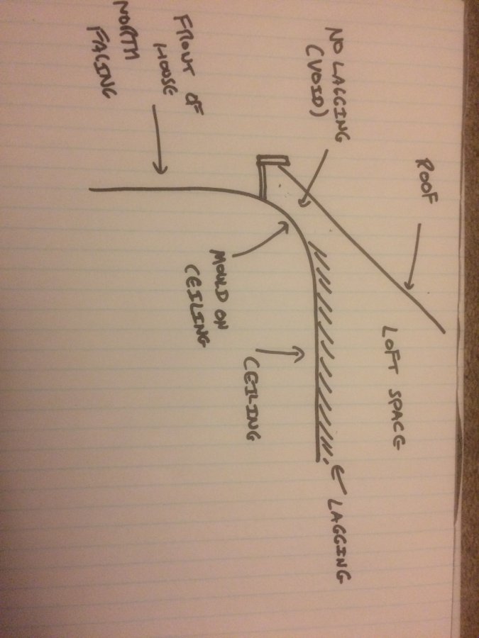

I have lived in my home for approx 5 years now & mould on the master bedroom ceilnig has slowly increased. I am trying to work out the cause & as such attach a picture of the setup & describe below.
My home has low evaes meaning that the ceilings upstairs are all curved where they meet the exterior walls.It is this curved area in the master bedroom that is mouldy & it is only this room. Please note that this room is north facing - if this has an impact.
My loft is fully insulated/lagged with the exception of the void area where the roof & ceiling are only approx 1 foot apart; this area is too tight for anyone to get into & you can just see the back of the fascia boards using a touch and looking down. Is this area meant to be lagged; as this is the area above the section of ceiling becoming mouldy?
Any suggestions would be great.

Remove plasterboard from the raked (slopey bit) ceiling.
Increase rafter depth if necessary.
Insert 100mm celotex between rafters leaving a 25-50mm air gap above rafters and below roof tiles or membrane.
Fix 62.5mm pre-insulated plasterboards to rafters - or fix 50mm double foil celotex insulation, foil tape all joints then fix 12.5mm foil back plasterboards on top.
Skim affected area.

Geographical elevation location plays a part i.e. NSEW.
One room may be better vented than another or just draftier.
