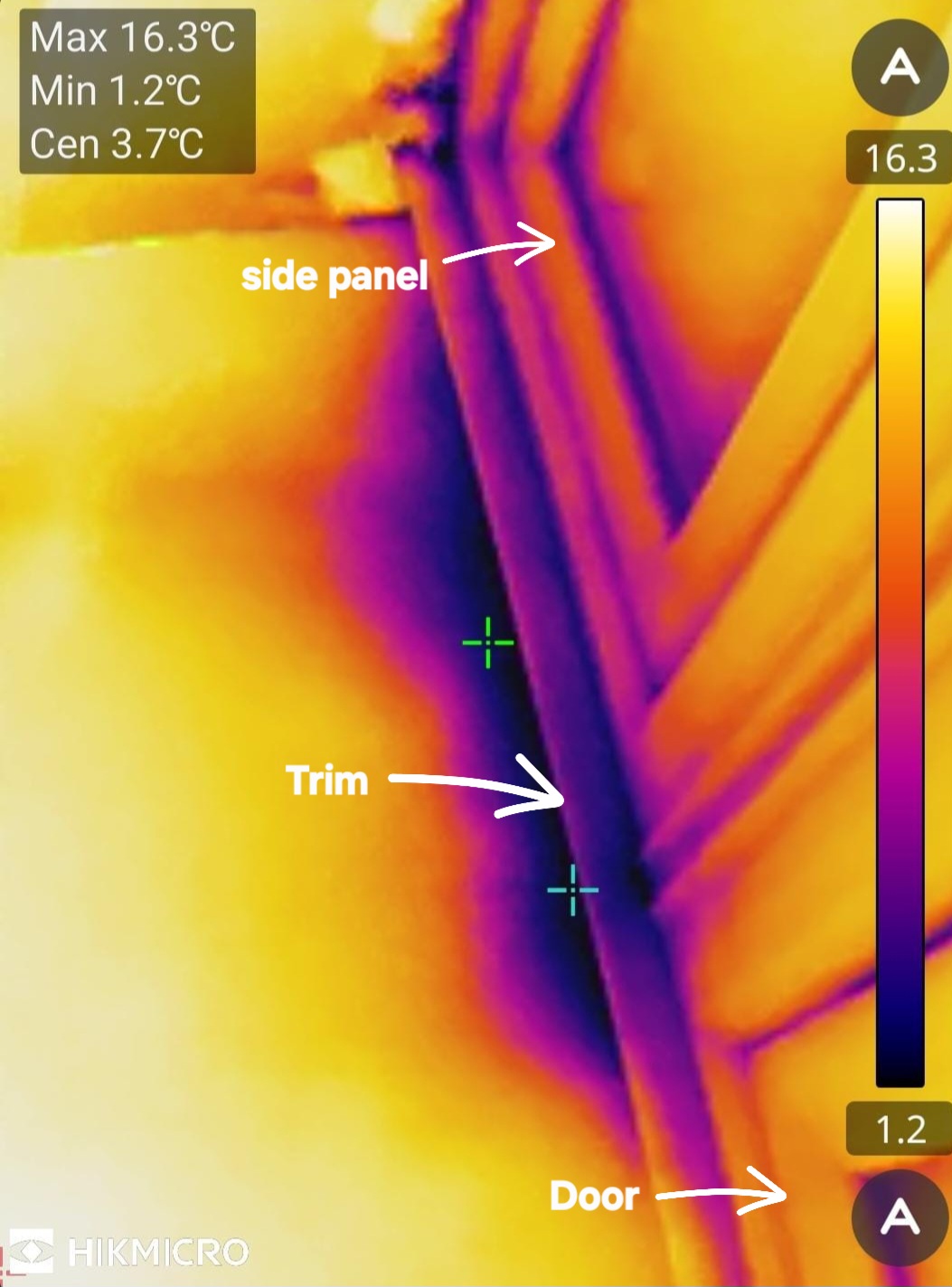

Cold bridge at new patio doors – sill resting on brickwork? Installer says “nothing more can be done”
Ok to me it looks like the coldest area stretches further into the room than the cill, the trim IMO is covering something usually a gap hence why it's trimmed and not just sealed, the trim isn't the cill, what's under the laminate floor in the area of the cold spot, a concrete patch repair maybe, an open cavity, who knows?

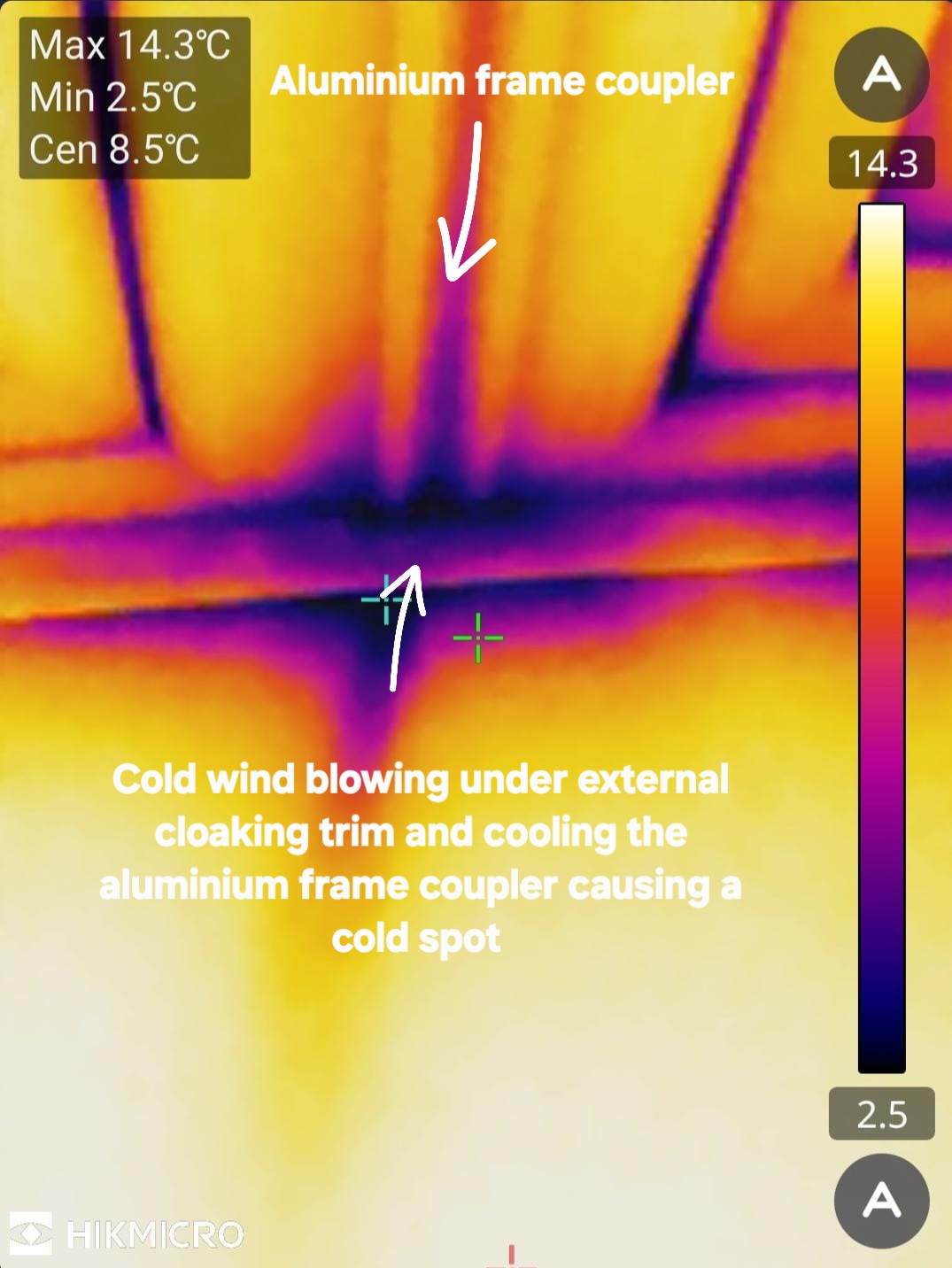

Behind the internal and external cloaking trims is a heavy duty aluminium frame coupler that strengthens the joint between the french doors and side panels, it's 100% always going to be cold and is acting like a heat sink in reverse, it's only cold at the bottom because that's more exposed as the wind blows against the doors and it blows upwards, nothing much can be done here

We have one pic from the outside. Looking at that, do you think more could have been done to prevent cold air getting in under the cill?
It seems the door has been put in place OK, but perhaps not been given enough protection from cold wind coming in below it.

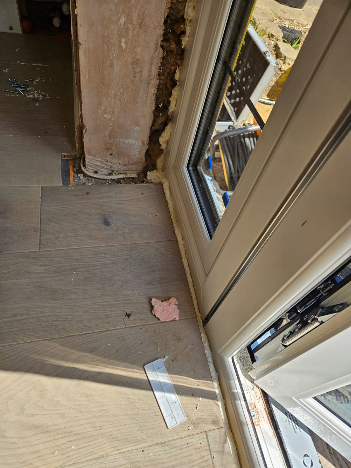

Just to add a bit more info because I think the photos might explain things better. The cold I’m seeing on the thermal camera isn’t coming up from the floor — the floor edge is actually warm because the installers foamed that whole area on their last visit. The cold line is literally exactly where the sill meets the frame. When I put my hand there, that’s where the draught is too.

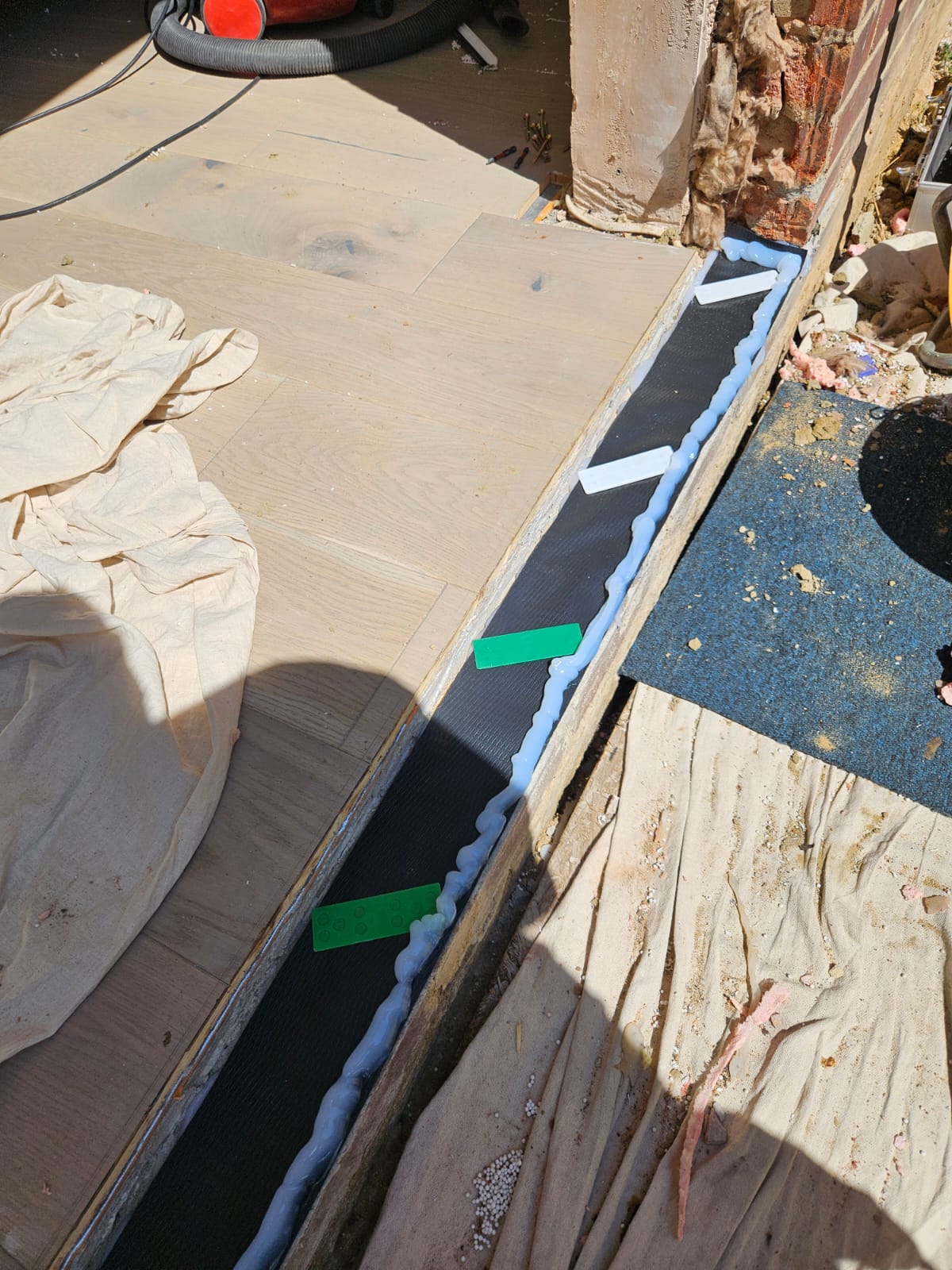

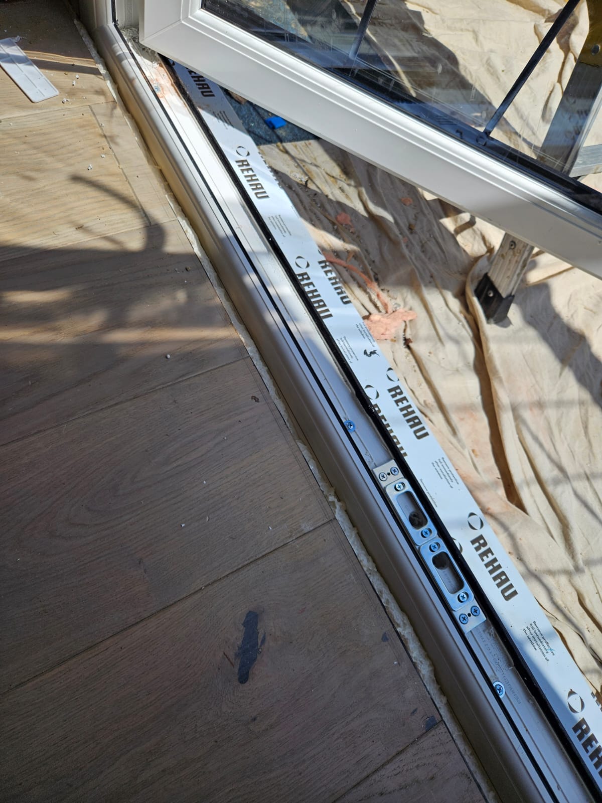

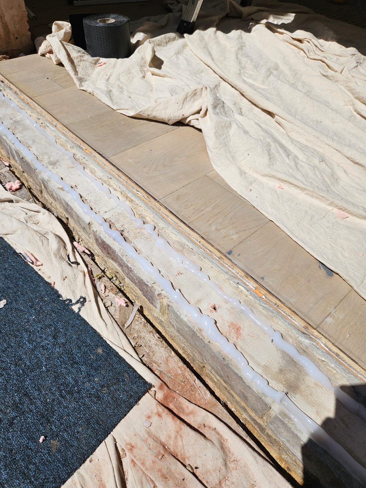

I’ve attached a bunch of photos from the installation day. Under the sill there’s basically just beads of silicone and tiny packers, no insulation or thermal break at all, and from underneath outside you can see the silicone is pretty patchy. So I’m trying to figure out if cold air is just moving around under the sill and chilling everything.
I get what you’re saying about the aluminium coupler being a heat sink, but dropping to 1–2°C seems a bit extreme unless it’s being hit by cold air or directly touching cold masonry. Could be wrong of course, but that’s what the pattern looks like.
The “cold floor from outside ground” idea was my first thought too, but the thermal images don’t really match that — the floor itself isn’t cold, just the sill line.
Anyway, I’ve added better exterior shots so you can see how the sill is actually sitting on the bricks. Maybe that helps explain what’s going on. Curious what you think once you see these.
Hmmm hard to say, looking under the cill I can't work out if it's a bed of foam OR a bead of silicone, some of the **** I go out to see where they haven't sealed underneath at all because you can't get a gun in but at least put a thick bead of silicone along the bricks and squidge the cill onto it, it looks like something along those lines has been done.

That's better, ok so that confirms what I said, there's a gap in the floor but they foamed it, that's good.
They've squished the cill onto silicone, and sealed above and below the dpc, that's good, they were thinking ahead
To be honest I'm not sure what more they could have done, I wouldn't say they've gone above and beyond but rather done what is required

Just to clear something up — the floor gap is foamed now, and on the thermal camera the floor edge is actually warm. The only cold area is the sill/frame junction, and that’s exactly where you can feel the draught with your hand.
The photos I've added are from the install day. Under the sill there isn’t a foam bed — it’s literally just beads of silicone with 1–4 mm packers resting directly on the brickwork. The external side also isn’t sealed in a continuous line — there are breaks where you can see light through the silicone.
So I’m just trying to figure out if cold air is getting under the cill and hitting the aluminium coupler, because that part drops to about 1–2°C even when the rest of the floor is normal room temp. I get that the coupler will always be a bit cooler, but this seems extreme.
If you think this could just be an air sealing issue, what would normally be used under a sill when the gap is only 3–4 mm? Just trying to work out what a correct install should look like in this situation.
