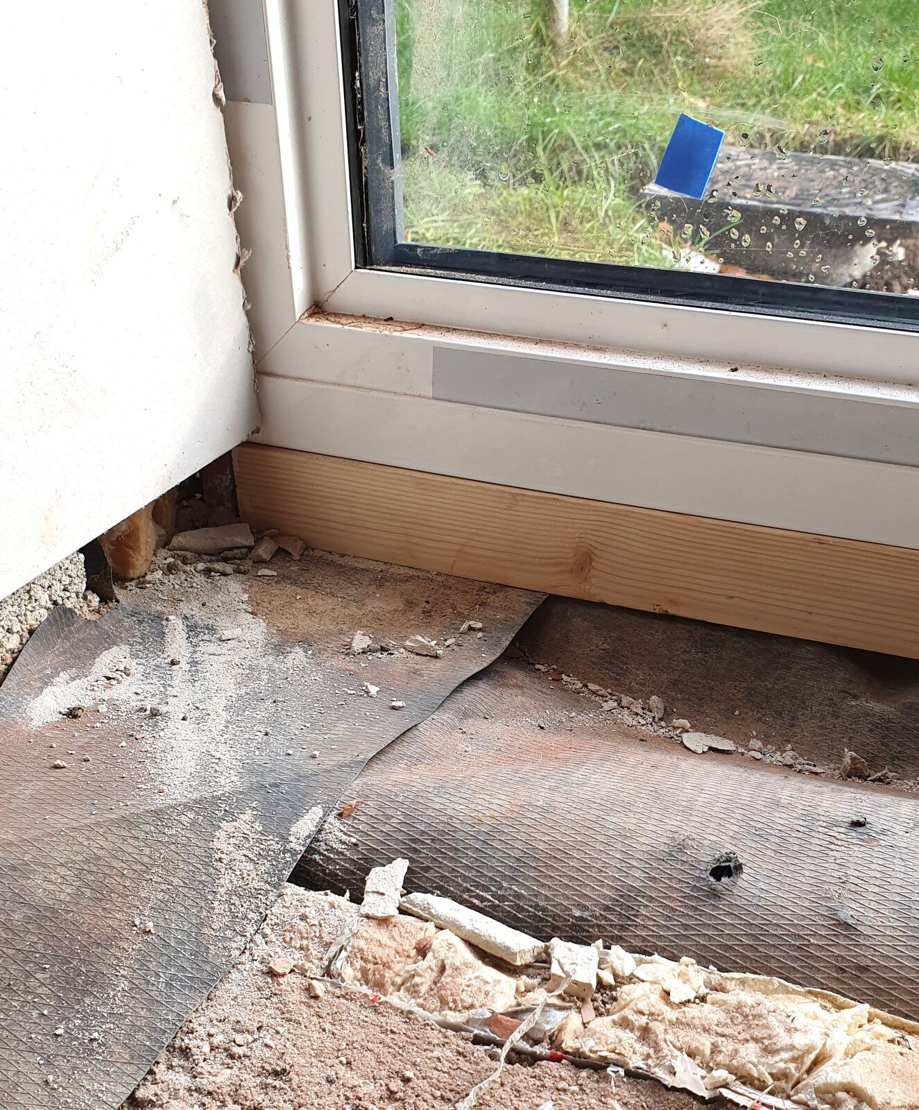

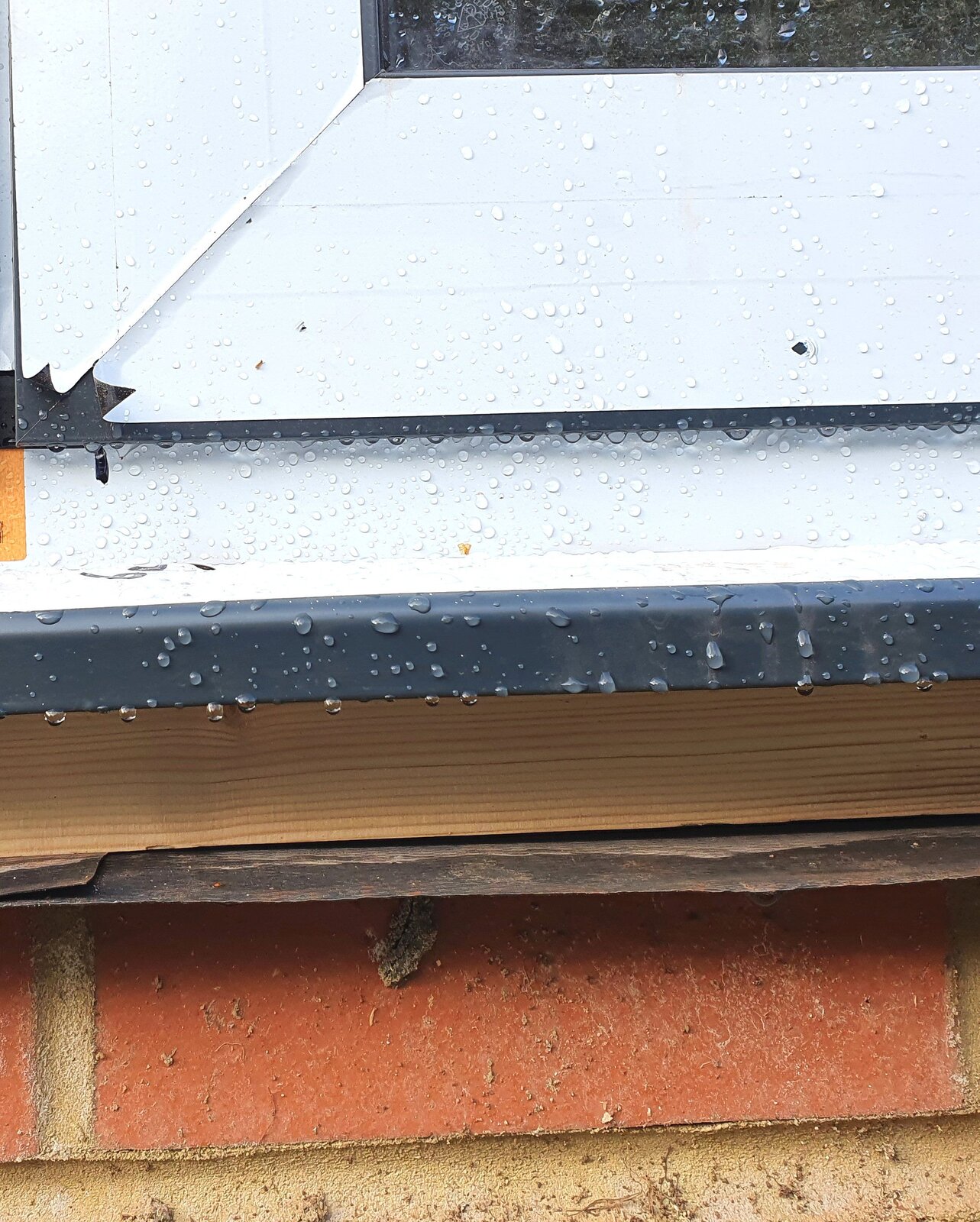

Hi everyone,
My wife and I are renovating a 1960s bungalow to be our home in retirement and we have a question about weatherprrofing and insulating a gap of 45mm at the base of a set of new aluminium patio doors.
The builder built the gap for the doors 75mm too tall and the window fitter installed the doors roughly midway in the opening leaving a gap above and below.
The gap above is filled with expanding foam and the gap below is taken up by 45mm thick timber pieces. The timber is visible both outside and inside, because the floor level is 35mm lower then the bottom of the door frame.
Can anyone helps decide how to provide support for the doors that is weatherproof and does not create a cold bridge to the inside?
Many thanks,
Nick

It's not just about the visual. If you just fill the gap with bricks it will create a cold bridge to the outside that will be diificult or unsightly to insulate. Having taken advice from others as well, what I am thinking of doing is drop the doors so that they are at the correct height, inline with the floor screed, and putting all the gap at the top. Then, have that gap plugged with a pressure-treated piece of timber, boxed in and plastered on the inside and rendered so as to match the wall on the outside.

well you say that, but I doubt there’s much difference between the bricks and an aly frame in terms of thermal bridge. I know aly has a thermal break in it, but it’s not that great.
however, your idea of dropping the frame is exactly what I was going to suggest - having that step over at the bottom would be annoying and unsightly.
