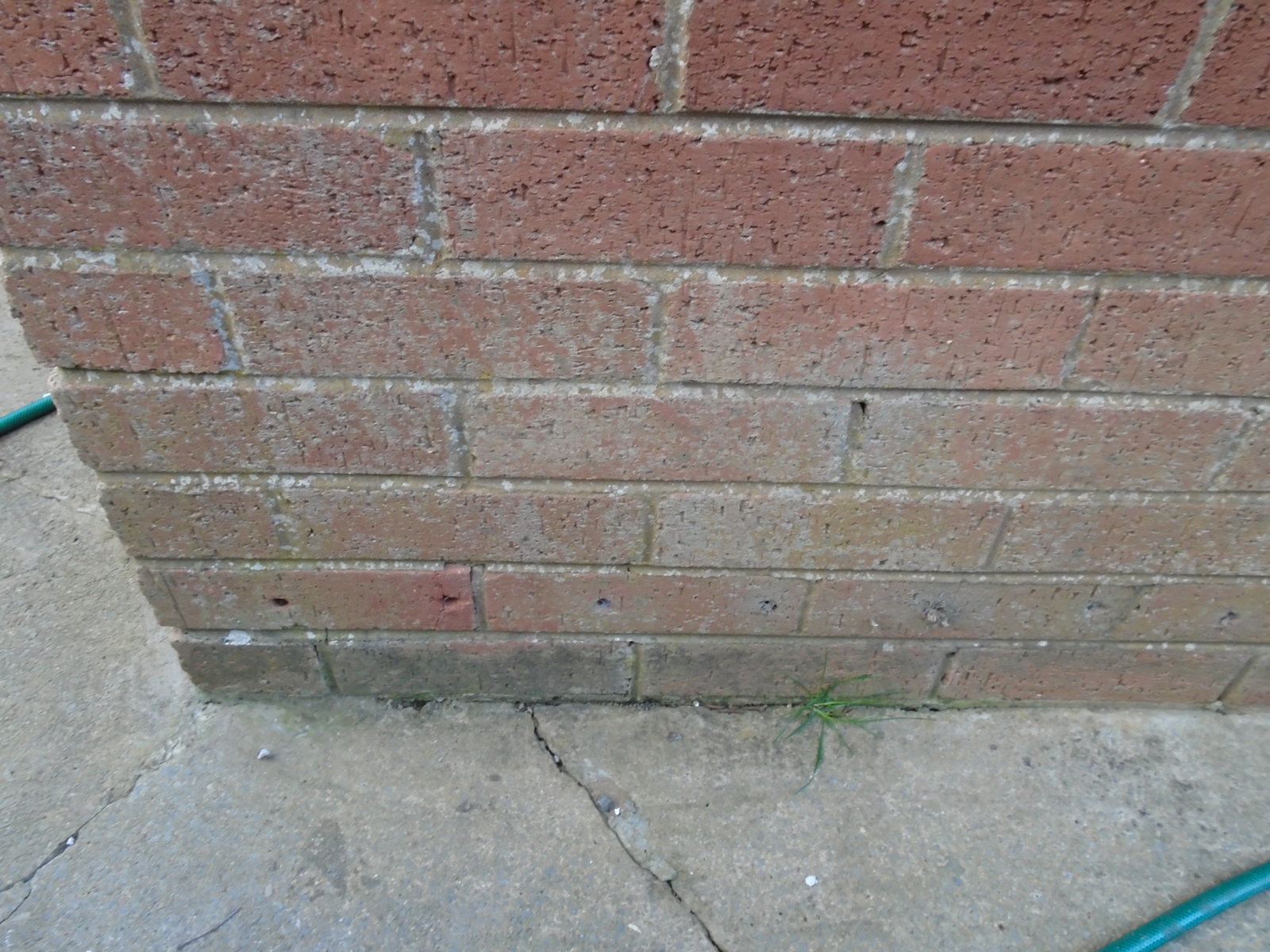

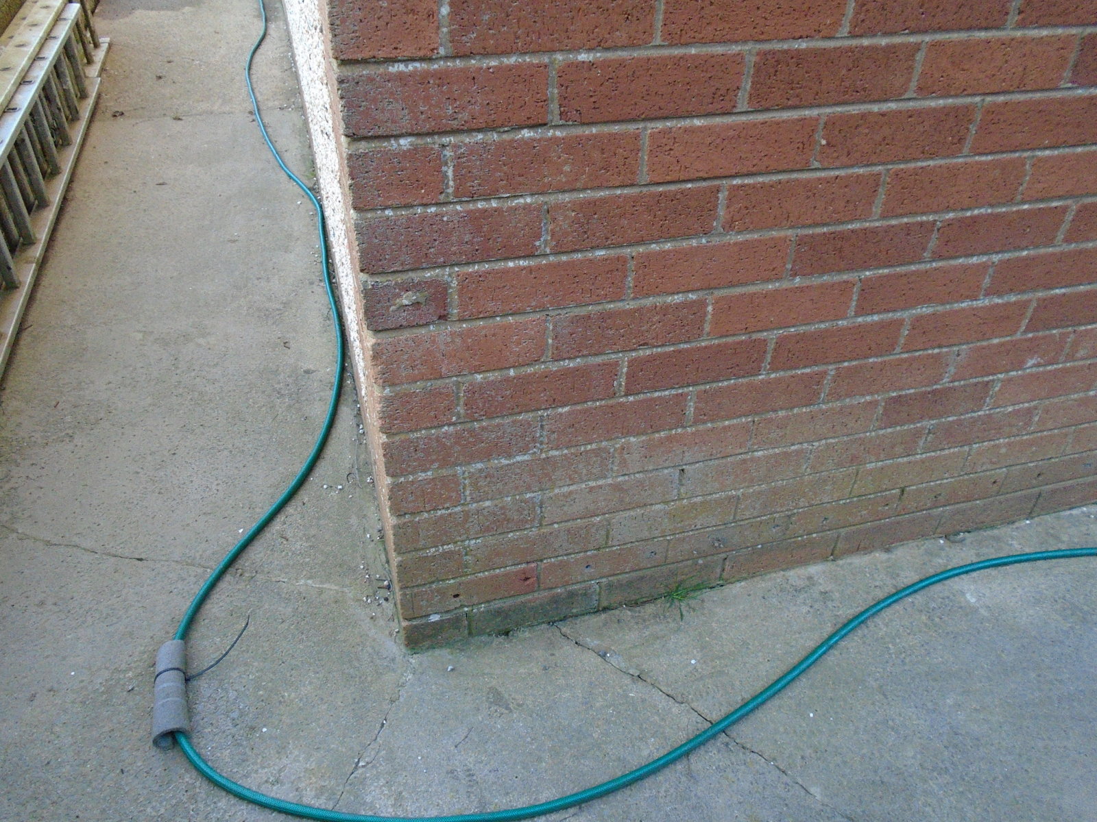

Some pics have duplicated, but I think I've got all angles. The injected dampcourse only runs along the rear wall of the property and a few feet around the corner, and was presumably a response by the previous owners to the same problem.

So with the above, the previous householder was conned into an injected DPC. Is there debris in the cavity? Remove a brick and look.
If it was mine, I would dig the floor up, dig down and install a correct floor.
On a budget, remove the skirting board. Chisel out the floor around the walls that face the outside. Standup the 25mm kingspan to stop cold bridging and put DPC between the wall and Kingspan, then fill with an ST4 concrete (usually specified for when rebar is installed but it contains more cement. Saves trying to mess on with a DPM if the floor doesn't have any.

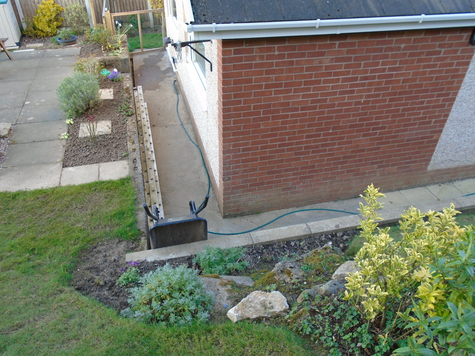

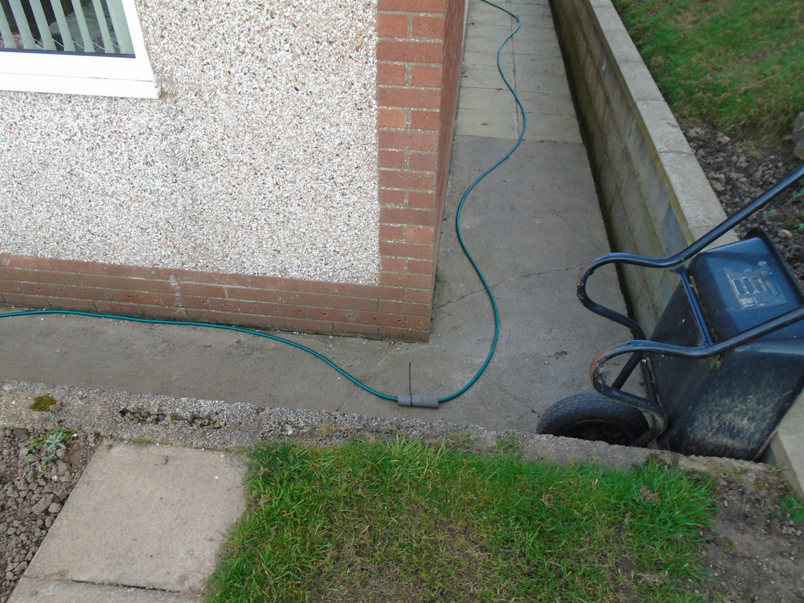

no matter what precautions you take for "sealing off" that solid floor they wont work.
Why, because of Gravity. Why, because you are on a steepish hillside, and the water table is so high its forcing high pressure ground water under your cavity wall and solid floor.
As above, you could dig out and create a membrane wrapped new solid floor but that might create the possibility of the pressured ground water moving further into the house beyond your membrane or finding a way up your internal walls?
fwiw: i wonder if the cracked concrete path was due to incorrectly placed concrete or ground pressure causing the cracks?
A previous remedial channel has been dug at the base of the retaining wall?
the lower courses of exterior brickwork are bleached.
It’s an interesting thesis. We are on a hillside, and there’s considerable ground water runoff from a field above us. The pathway alongside the house was flooded a few years back, about a year after we moved in, and it transpired that the drainage for that area was totally inadequate. Thats since been remedied, but the grassed clay slope above the house does hold a great deal of water after prolonged heavy rain. The channel at the base of the retaining wall takes runoff from the slope via weep holes, but yes, some water could seep below the concrete path and there could be something in what you suggest.

What does bleaching of the brickwork indicate?
Can’t see evidence of original dpc so may be below the ground , and injection Damp course ineffective .
Have you measured down from windows to floor inside and out , would be interesting to know the result .
The original dpc is there, yes. In fact coincidentally, I drilled into it the other day when I was fitting kitchen waste pipes. It’s in the joint above the injected dpc, but you’re right, not obvious in the pics.
I’ll take those measurements you ask for in daylight, tomorrow.
