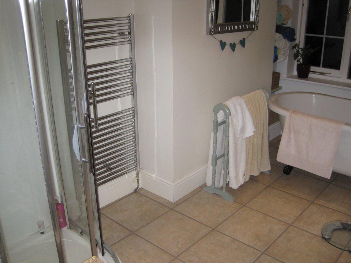

Our bathroom radiator has started to not get warm or only get slightly warm very slowly. The radiator is upstairs and is the closest to the boiler on the upstairs run.
It is a chrome, ladder-type towel radiator and the pipe sometimes gets hot before the flow valve but the rest of the radiator is cold or luke warm. It doesn't have TRVs and both valves are wide open and don't get routinely adjusted, so I don't think it is a sticking valve.

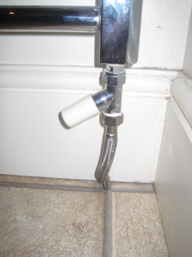

It is a copper system, combi boiler, but to this radiator it is flexible pipes, like tap pipes.
The flow pipe gets hot, as does the valve, but just above the valve at the start of the radiator it is cooler and then cools quickly away from the valve.

If its flexible hoses then the internal bore of these will be tiny, around 6mm. Ideally replace with proper pipework or spend an hour balancing your system out. Flexibles really shouldn't be used to pipe radiators as they are not designed for that and have a very high rate of premature failure.

Any chance of some pictures and we might be able to come up with some ideas that will help you out.
Jon

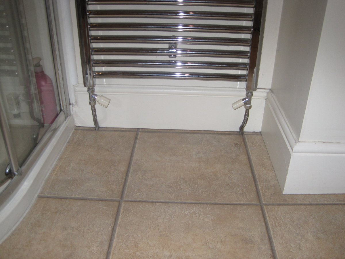

Here are photos of the radiator, the flexible pipe and the the position in the bathroom

Thanks.
That confirms my worst fears.
Almost the worst DIY bodge that I have even seen in terms of just how problematic it will be to correct it.
To do a proper repair from the bathroom will need breaking up and then relaying perhaps 2-4 tiles. IF matching tiles can still be obtained. Probably at a cost of £200-£400 !
I think my best advice will be to try to live with it and to ensure the boiler system pressure is kept as low as reasonably possible.
Tony

Its not tiles its a laminate Tony. The boards will be about 7mm thick and have a locking edge on them. If you can find an area where you can start to slide them apart then it may not be too hard to start lifting to get at the pipe work. Shower panel off at the bottom and see if there is any room for movement.
Jon
What's behind the wall with the towel rail on it? If it's a bedroom and not an exterior wall, I would try and access the heating pipes from there. Bring them up into the bedroom, chase them into the wall and then 90 degree them through the wall, into the bathroom. Then raise the towel rail and get it fed through the wall, from the bedroom - if there's a bedroom there!
If not... floor up in that area of the bathroom and get rid of those damn flexis :eek:
