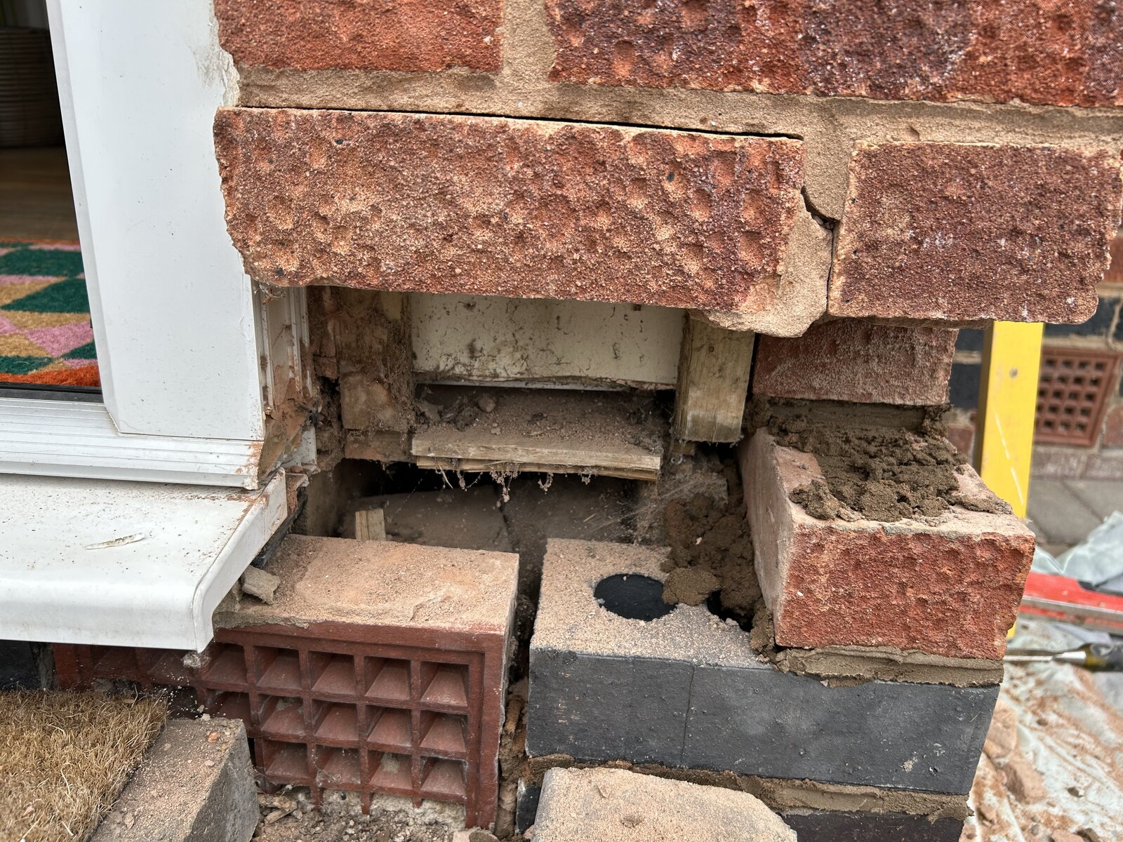

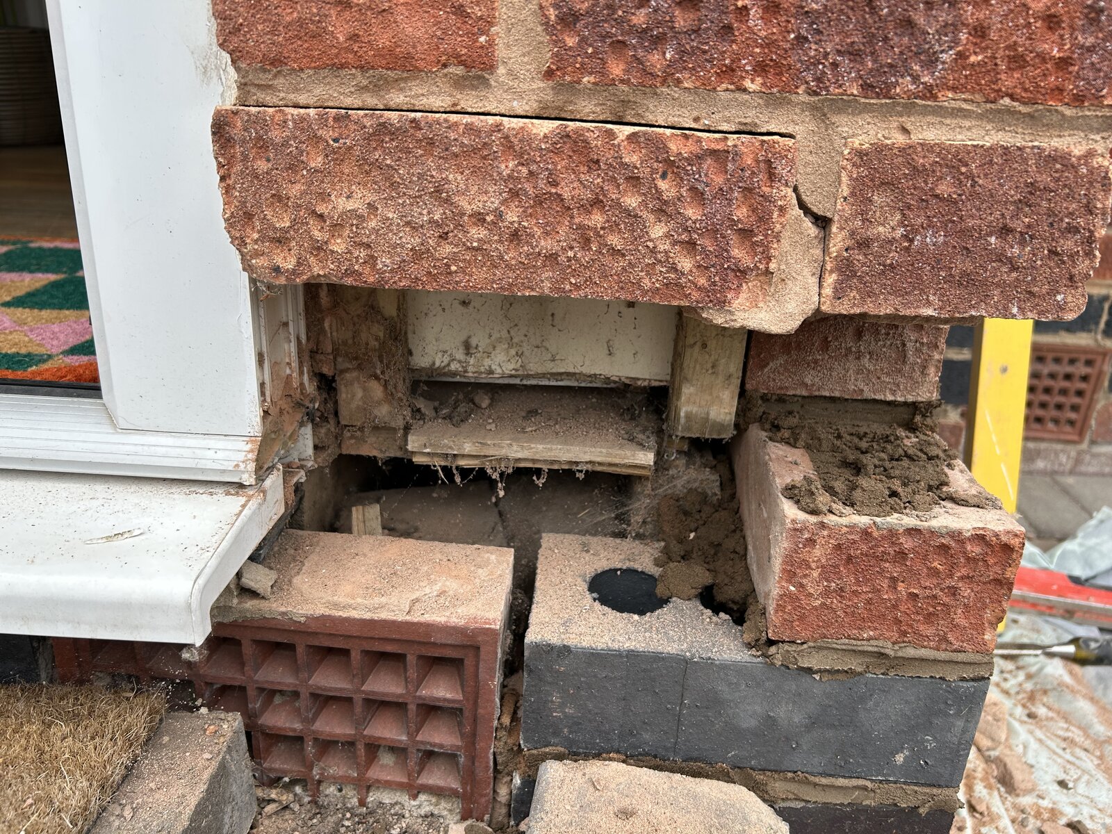

Collapsing porch
It looks to me like something has been done there retrospectively, given the differing types/ages of mortar present. Almost like they took some of the wall down and fitted the air brick or some such....? :confused:
That’s got me thinking it could possibly have been someone mistaking accelerator for brake .. it’s a very short drive, only fits a fiesta size car without it being on the pavement. And may explain why the step seems to have self destructed so dramatically …
Although the more I look at it, I reckon someone’s fitted that bit of dpc (a course higher than the dpc already is) retrospectively and made a pigs ear of it :ROFLMAO:

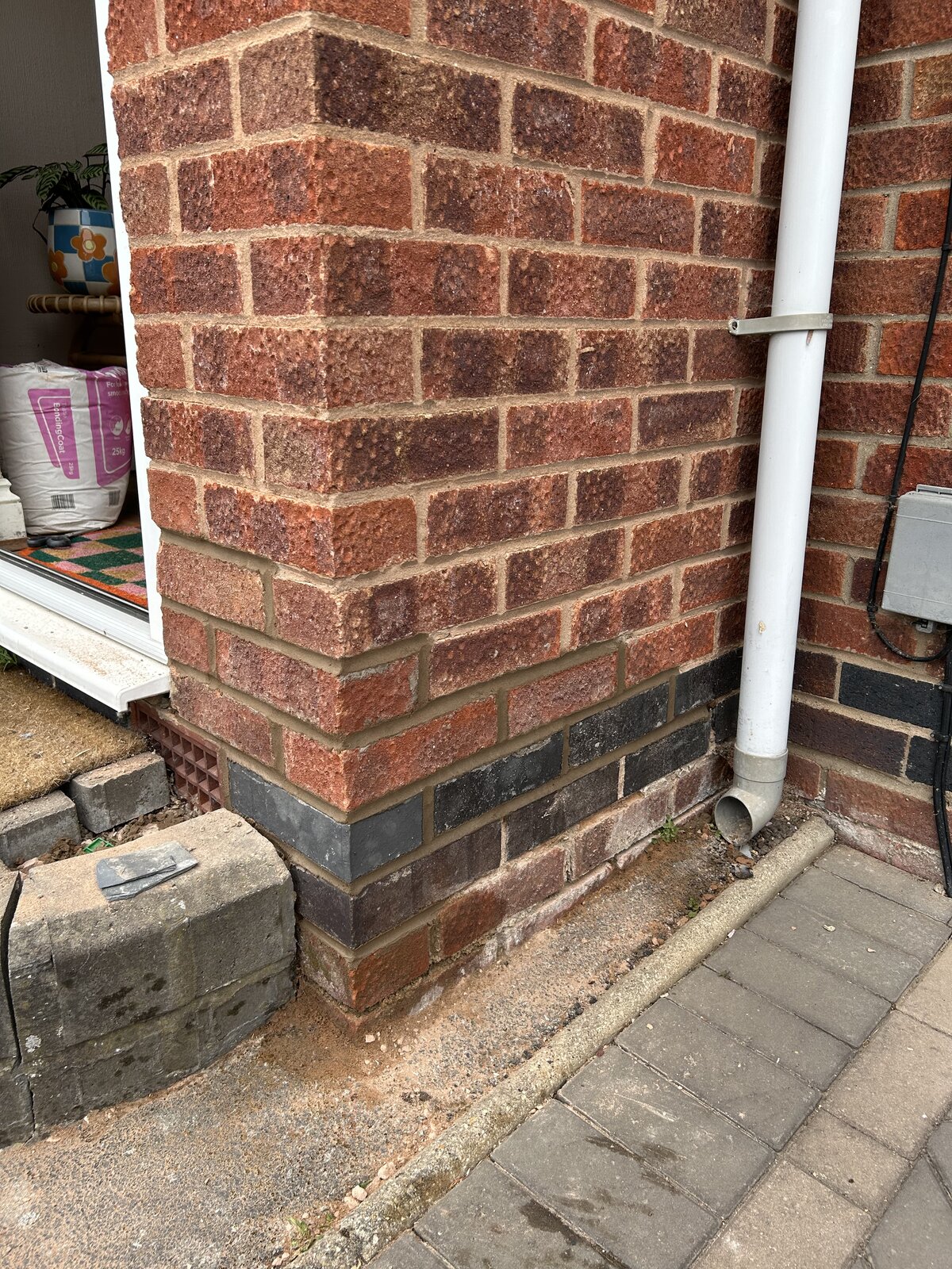

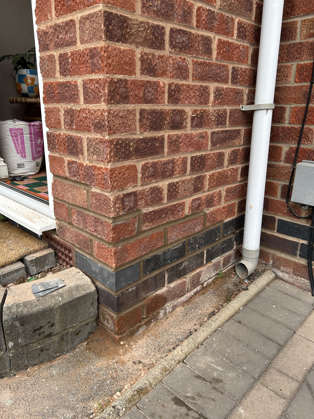

I took the bricks out and rebuilt it this morning, turns out the t&g floorboards had swelled and pushed that course of bricks out. Rubbish design, single skin too.
Trimmed the floorboard back and rebuilt. The coursing seems fine so I don’t think it’s actually sunk, but will see. Cheers for the advice on it. Still need to sort the step.
