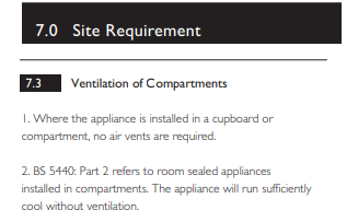

Does a door to a combi boiler cupboard need to have vent slats? The current door have one at the top and one at the bottom but this was there when the old boiler was there, which was a conventional gas boiler with a hot water tank. The existing boiler is a combi boiler and I am looking to replace the cupboard door but don't know if I need to install one with vents like the existing door?

it's quite a big cupboard under the stairs. i will get a ventilation grill fitted at the bottom of the door as having one at the top and one at the bottom (which is the current arrangement on the old door) is a bit OTT I think.

You may think that, however, it was a requirement of the boiler manufacturer of the earlier boiler and no one has any authority to reduce the ventilation that they require.
Indeed if the Gas Registered installer fitted a boiler with lesser ventilation he would be infringing his professional standards and risking being struck off the register if any complaint was made.
Gas Safe could also serve a Notice on him to correct the deficient ventilation ( at his own cost ).
If the boiler caught fire as a result of the sub standard ventilation then the Installer could be held responsible for damage caused.
The reason for ventilation at both high and low levels is to encourage a thermal flow of air.

I mean OTT for the modern day boiler that I have there now, which doesn't need ventilation.
