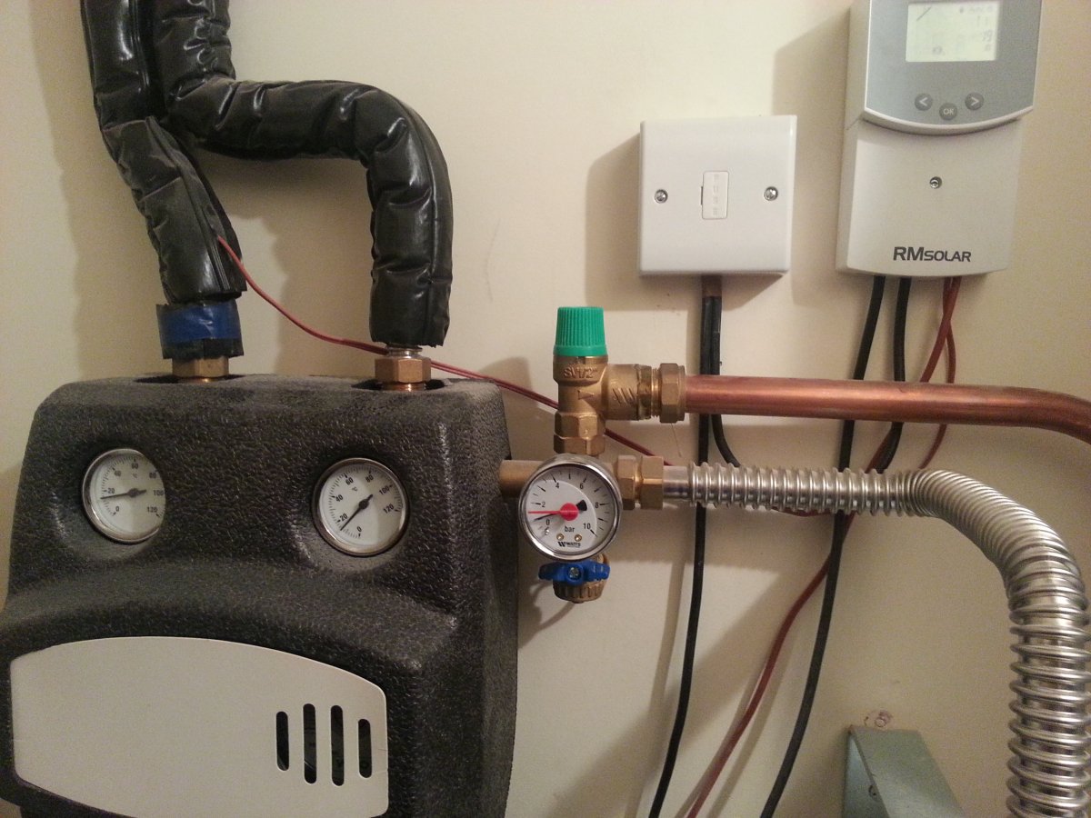

the boiler now starts but says 3.2 bar and flashes. is it safe to run? the pressure gauge is at around 1.5 bar so i dont know why the discrepency.

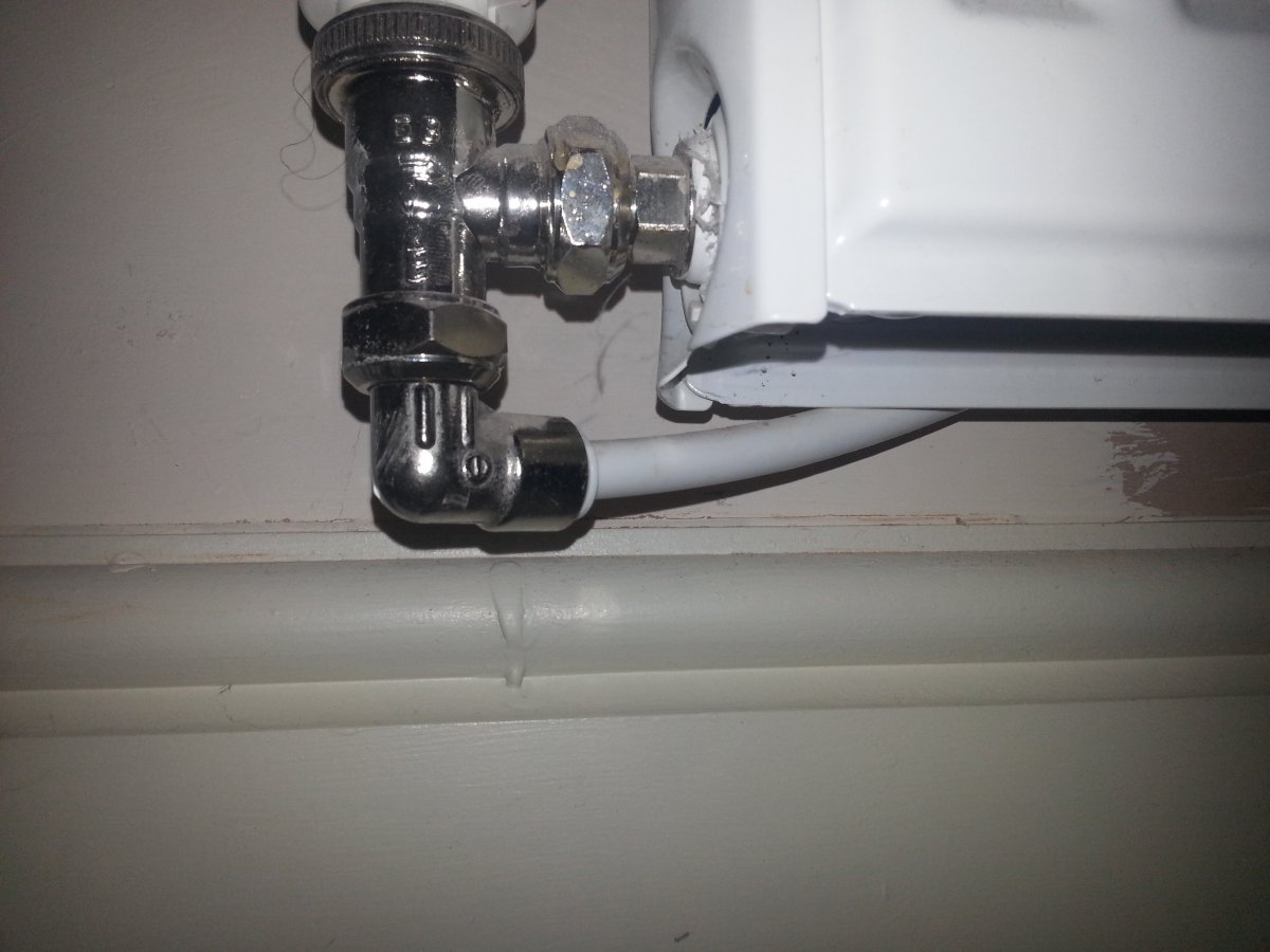

the radiators are like this https://www.mrcentralheating.co.uk/revive-750h-x-400l-double-deluxe-radiator-k2#.VkhQmnbhCiM
but have crosco stelrad written on them.
they are connected by hose at the bottom. when i attempt to undo the nuts the entire fixing just twists where it enters the radiator. they are very tight. is this the right way to do it for one of these? am i even doing the right thing?

Pressure gauge could be blocked.
Pressure sensor could be FUBAR.
Why is your radiator connected with a hose? Only an idiot would use hoses to connect a radiator to pipe work.
If they have, then christ knows what state the rest of the system is and sludge and all manner of crud could be in the boiler.

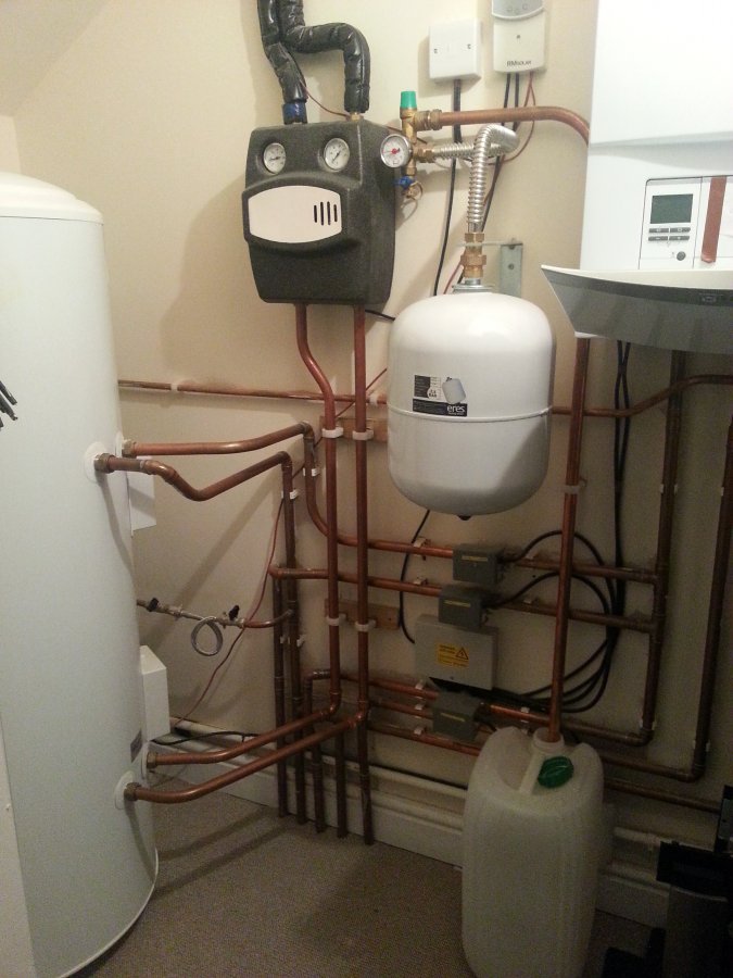

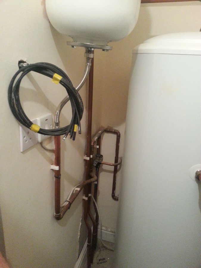

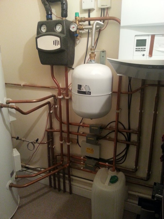

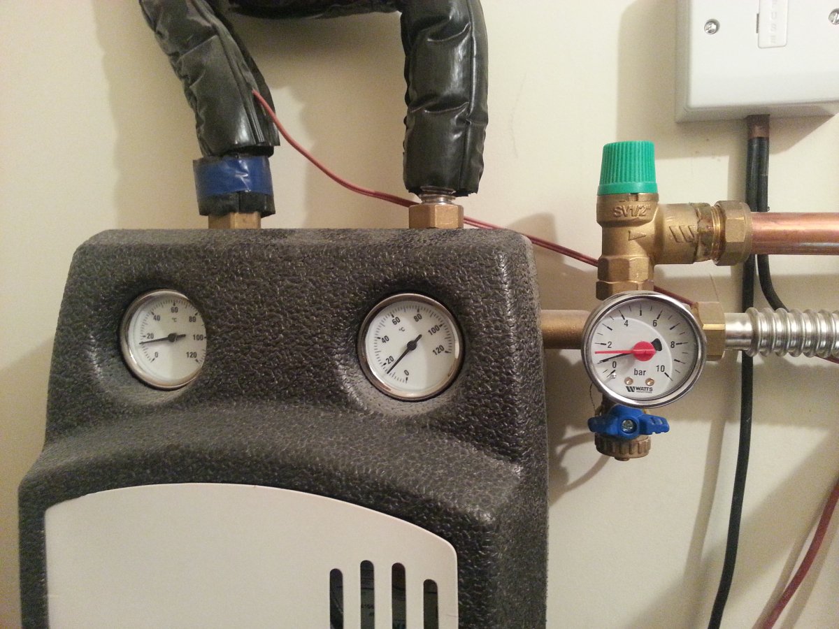

well its a rented place, i moved in in may. Its got solar panels on a flat roof, underfloor heating downstairs and thermostat radiators with hose connections upstairs. So there is quite abit of pipework and stuff in the boiler room i am not familiar with relating to the solar installation. The f.32 fan fault has reoccurred quite a few times with increasing frequency followed by the failure f.75 pump water shortage which put it out of action.
so i had someone look at it a while ago re the fan fault, but they could not diagnose it without said fault occurring in person and it irritatingly refused to. i had no idea when they would turn up so hadnt left it in the fault state as it just requires a restart to get it going. i didnt bother getting them back as it was summer. the f.32 fault occurred 2 or 3 x a day last week and then the pump warning after which it wouldnt start.
ill get someone booked on monday but its getting cold and i could do with a wash!
landlord hasnt replied to emails typically.
so i am now at the point where it starts after opening the filling loop but i dont want to damage it etc as the boiler flashes 3.2 bar
am i to leave it off until i get it looked at then?

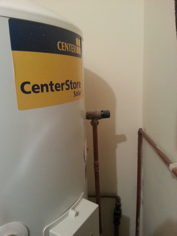

Is the solar a PV system? Or do you have a cylinder?
If so immersion heater?

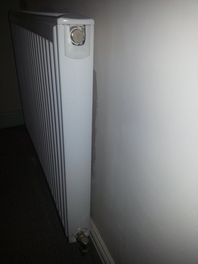

Can you post a picture of these hoses?

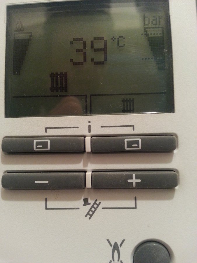

I have turned it back on and the temp is increasing to 50, pressure on the boiler now at the upper range and will presumably shortly start issuing a warning again as it creeps over.

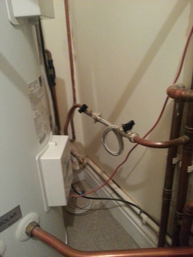

the loop i opened can be seen near the solar tank. this i opened , which seemed to cure the f.75 fault pump water shortage. but the pressure gauge did not move
the boiler is @55c now and not issuing a warning yet. its not over the upper line though
dodgy looking hair on the radiator not mine i might add (not to my knowledge anyway!). That rad is in the hallway. So its now flashing 3.1 bar. I have gone from f.32 fan + f.75 pump to this instead.
