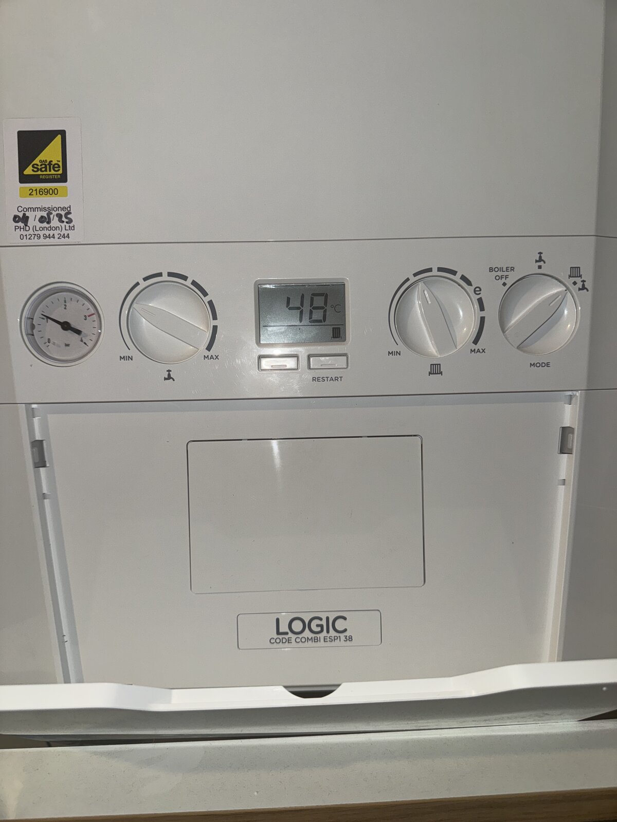

Hi,
We’ve moved into a new build property a couple months ago, it has a combi boiler (Logic Code Combi ESP1 38).
On the actual boiler we currently have it set to water and heating and have both temperatures as minimal as possible however for some reason our boiler keeps coming on and staying on for hours at a time when the heating isn’t on and we’re not using any hot water.
We’re averaging 27kwh for gas a day even when not using any heating, when we had it on water only mode it was about half of that.
Is there a setting that I’m missing? Our thermostat is on manual mode so the heating isn’t coming on either, the boiler is just heating for some reason.
We would appreciate any help, last month our gas bill was £16 whereas it’s currently on £10 for November already when we’ve only had the heating on for 3 days - the only change we made was changing it from water only mode to water and heating.

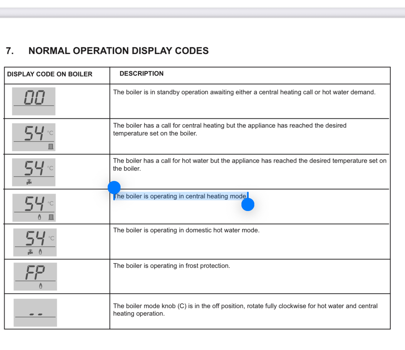

Edit: I’ve been watching the boiler for a tad now. The temperature on the dial is usually around 52, when it reduces to 46 (takes about 20 minutes) the boiler fires up back to 52 then switches off. It’s in this cycle, I’m assuming this is what’s causing the boiler to feel like it’s always on.
I can’t seem to find a pre-heat button anywhere. Is there a way I can stop this? In theory can we just put it on water mode till we need the heating which is usually 1/2 times a week.

Just to add, every 20 minutes or so it changes ‘The boiler is operating in central heating mode’ despite us not turning the heating on.
I’m assuming the boiler is switching on due to the sound it’s making and changing modes.

Contact your house builder, it’s likely a link (often 24v) has been left in which will override any thermostat. It won’t be preheat as it would have done it in hot water only mode.

Is that the case even if the heating isn’t actually on?
More than likely the case yes, that's what I said about it overriding any thermostat. Put it back to hot water mode and see if it still behaves this way. I've had it a fair few times now.

Sorry what exactly is the 24v you’re on about? So I can tell the developers. Thank you!
It's very common for this to be overlooked. I did it a couple of times when I started but soon learned to always remove the link when wiring in external controls.
Most combis come with this link connected, out of the factory.
It's a link inside the boiler on the PCB so the heating works until a control is wired in.

I put it on hot water mode only and it’s stopped firing up randomly so changing it to this fixes it but I’m assuming there can still be a problem with the 24v like you two said?
The only concerning part when it’s in hot water mode is that the temperature gauge goes below 1 and sits around 0.5, however as soon as I put it back on hot water and heating it goes back up to just over 1. Is this normal?
It's not a temperature gauge but a pressure gauge. Yes that's how it's meant to work, but it's supposed to be at approx 1 bar
You mean pressure gauge?
That should be around 1.2 when system cold.
It needs looking at tbh.
