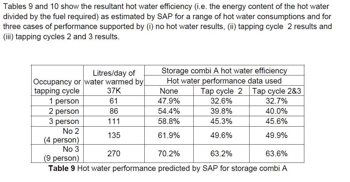

Many combi boilers are very in-efficient when producing small quantities of hot water.
Building Research Establishment evaluation of "High Efficiency" boilers produced these results,
