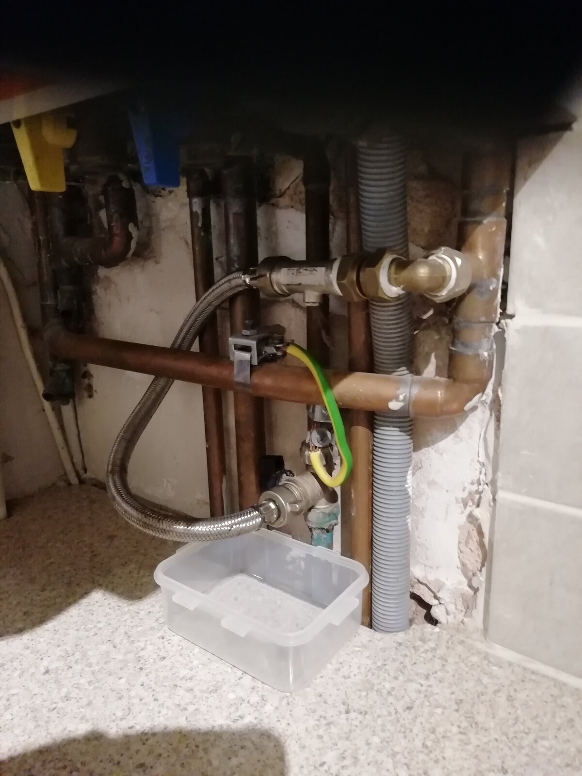

The mains comes in at the bottom of hose and enters a valve at top above earth cable. It is this valve that is failing for some mysterious reason (will fill a cup in minutes, not seconds).
Provided the hose stays on, this is enough to withstand leak. Not ideal, but will do for now.
I didn't understand your reference to capping. It would need to be temp cap so that system could still be filled if required.
I can imagine replacing the valve at some point after draining system. However I am curious as to why it should fail. Coincidence an unrelated to other issues?
Rest assured I have a pot underneath, and everything is as dry as a bone.
I accept that it could leak slightly over time
You could remove the loop and fit a blanking cap nut and seal ,just screws on, to both valves.
The higher valve is a non return valve ,and shouldn't allow water to come out ,so it's failed and needs replacing. If it lets water out your pressure will drop.
Totally understood. How usual is it for a non return valve to fail? I'm going to assume that this is totally unrelated to my original issue (EV)
Not too common for them to leak, but not exactly unheard of either.
The EV has nowt to do with it.
