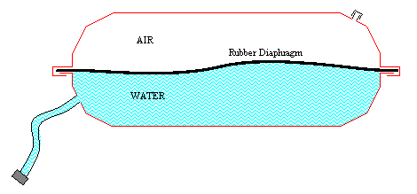

You don't have a tank in the loft so the water has to go somehwere when it's heated and expands. There's a can of air (pressure vessel) in the back of the boiler, which gets compressed. The whole system is kept under pressure (about 1 bar).
er pic somewhere...
