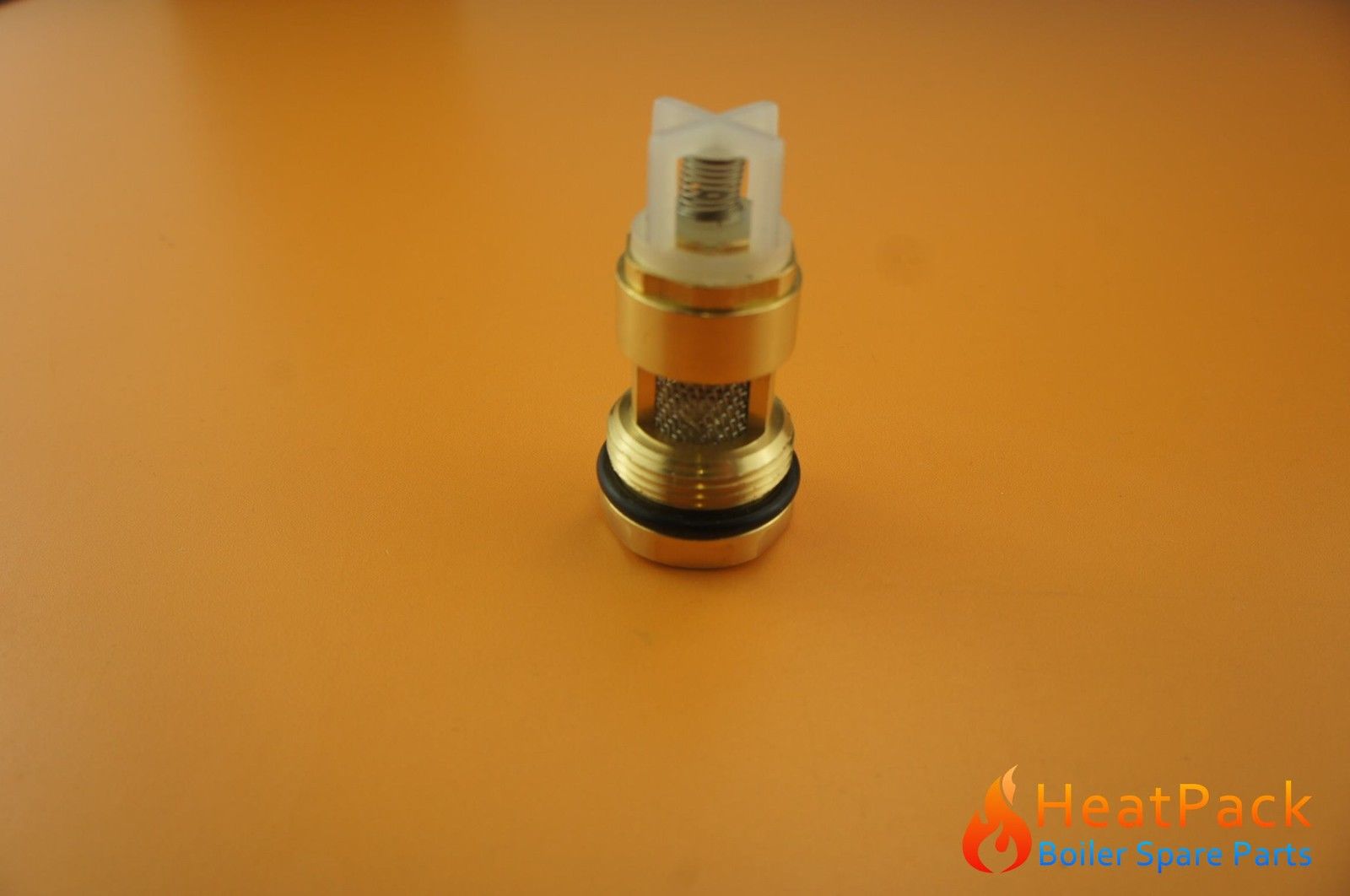

I have two part numbers for this venturi
HYDRAULIC VENTURI 248051 248050
Which one do I buy? Thanks
248051 is just the end bit which just un screws so that's all you need but if 050 is whole bit as in picture makes it bit easier. It is in the left hand side of the brass housing on the righthand side of boiler just were the two we pipes go in. You will need a 24 mm spanner to get it out once out put finger in hole and get the broken bits out before fitting new one back in.

Thanks for all that gas112. You are correct. When I got to the shop it was only the end bit so I've gone on ebay and bought the whole fitting (not the block). Something has been leaking around the fitting as its got a lot of white powdered crud on it. I'm going to put some lemon juice on it to dissolve the crud and wait for the part to get here. Thanks also for the fitting instruction. I think I can manage it without the aid of calling someone.

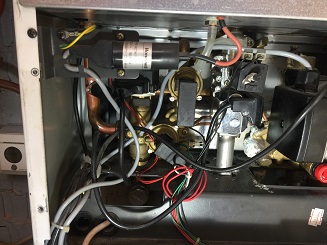

Anyway, I'll let you all know how I get on. Looking at the heat exchanger, I think the whole pump block would need to come off before it would come out without removing the boiler from the wall. Doesn't look that difficult though.
I took this pic to show the parts guy. You can see what mess has crusted itself round the fitting. It may have leaked from the small union above it.

Success! It was indeed the veturi. The plastic support had dried out and had fallen off, letting the spring and valve seat fall out. I retrieved all the bits except one small leg on the valve. Just couldn't find it. All working as it should now.
