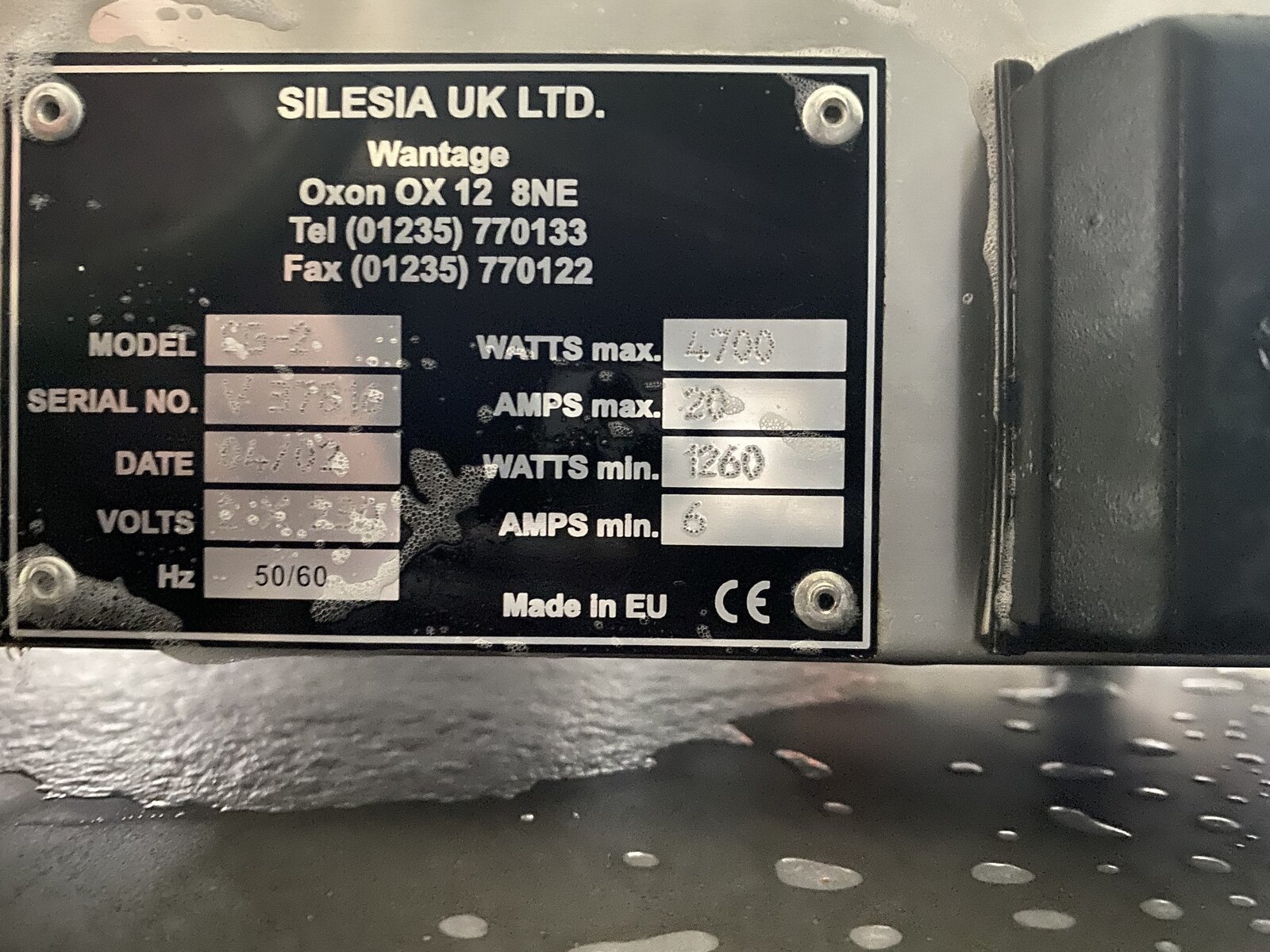

The maximum current or wattage demand, should be shown on a rating label on the appliance - what does it say?
Hello mate and many thanks for the input. This is what it is tripping and here is the plate from the back...

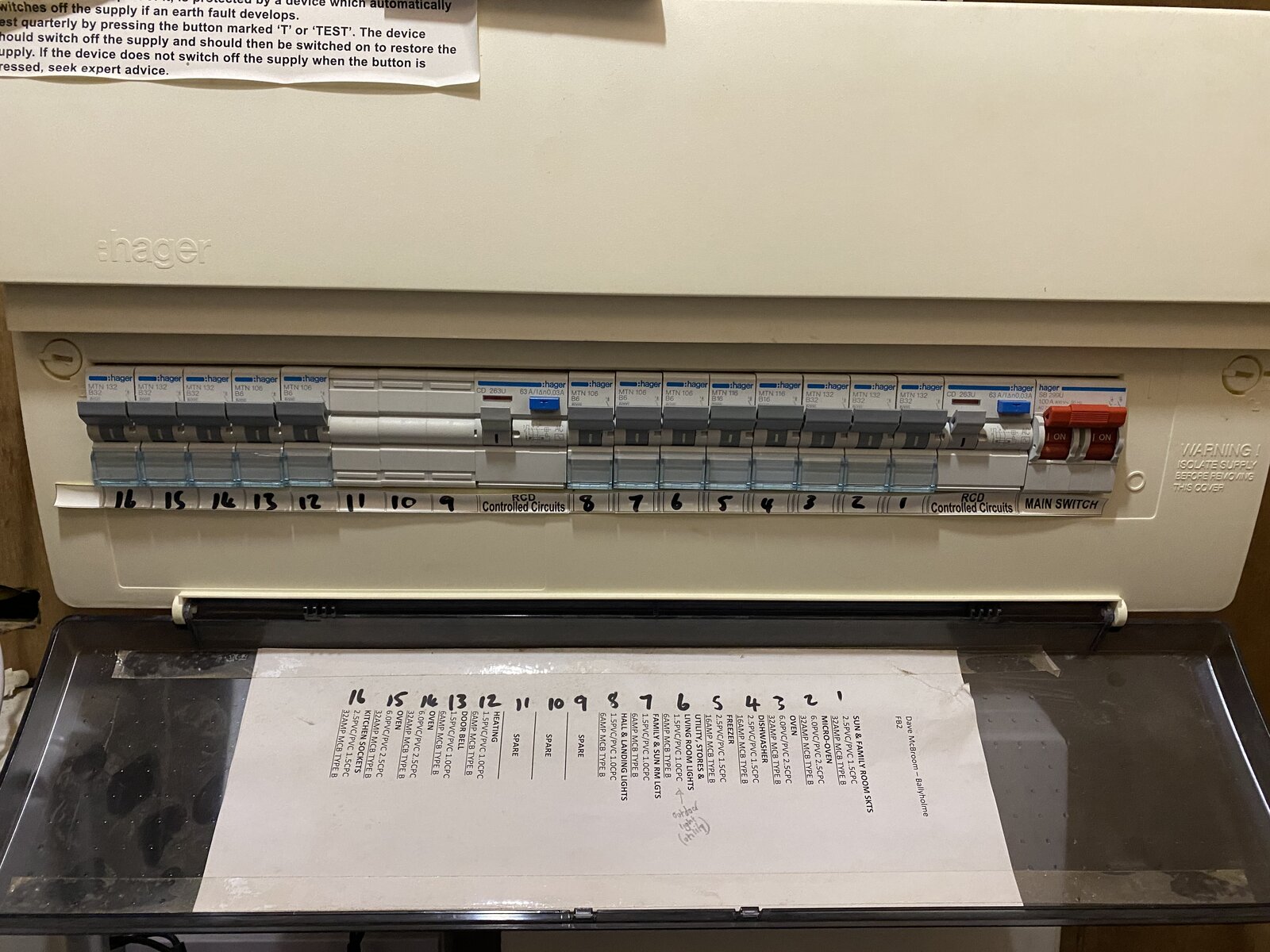

When you plug both in together, what and where exactly are you plugging them in? You have 2 circuits marked "Oven" and 1 marked "Kitchen Sockets" on the left RCD (14,15,16), and another marked "Kitchen" on the right RCD (3). You should be plugging both into circuits that are on the same RCD.

Possibly, but to confirm that - Have you one double/ twin socket, into which you can try plugging both sides of that unit? Then let us know is the RCD trips. It looks as the entire unit is rated at 22amps, which is the limit on the load a twin 13amp socket is designed for.

But I'll just throw it out there; the RCD is rated 63A and it has three B32s plus the rest. Could there be a risk of overloading the RCD?
Oh, and lovely to see a well labelled CU. :)
