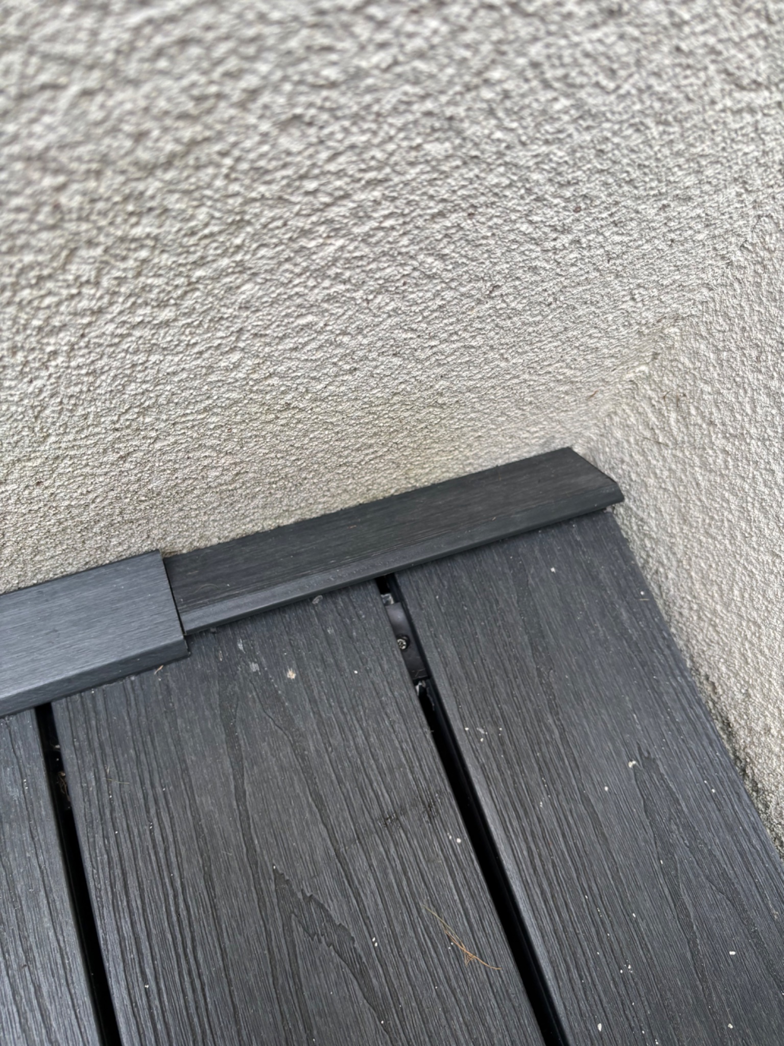

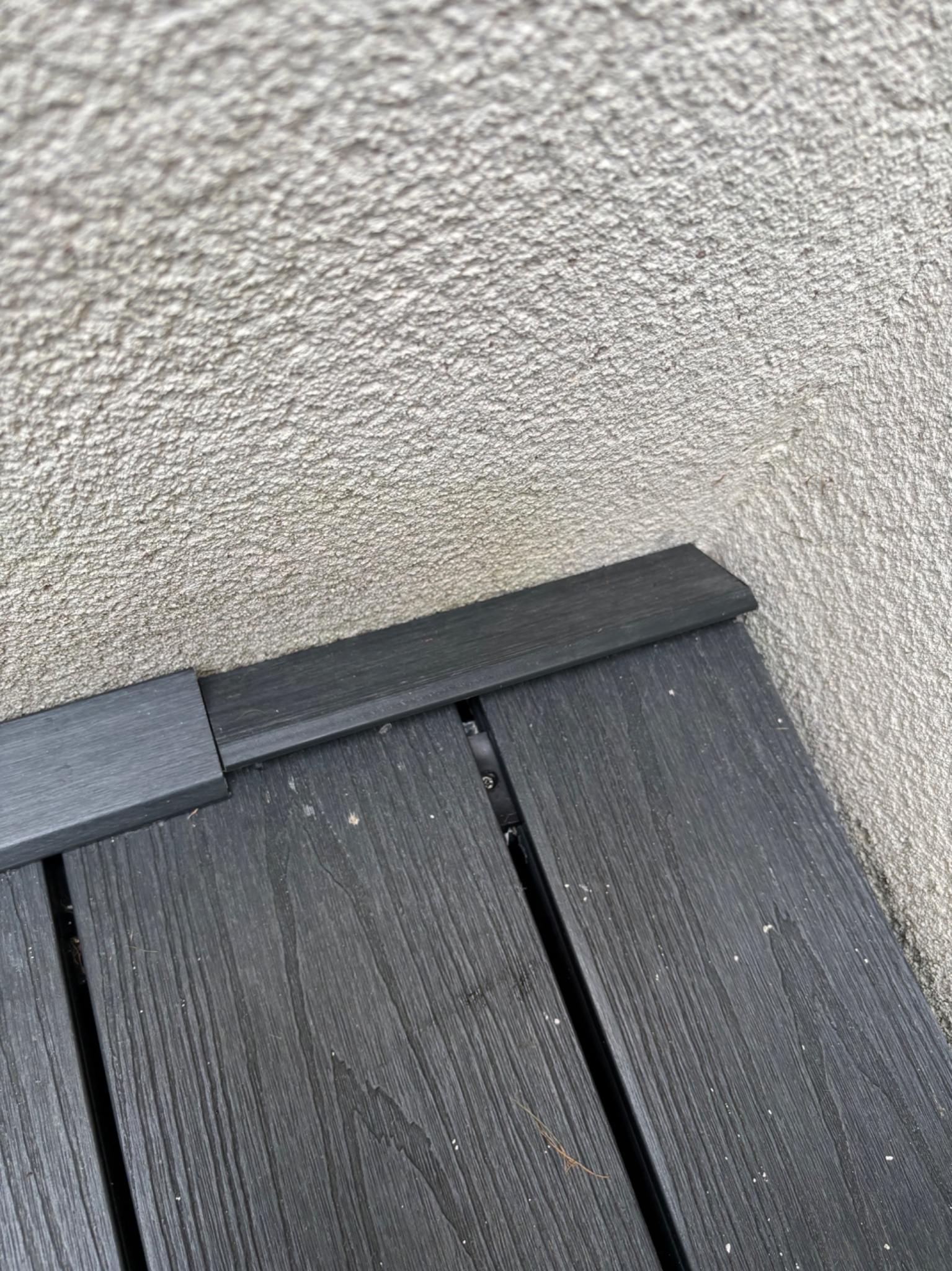

I’ve had some composite decking installed but a general builder. He had issues with the glue supplied and recommended by the supplier dino decking, in that the side neutral slats were falling off within a day or two.
He had since screwed some of these to the frame, which cosmetically isn’t great and some have split a little.

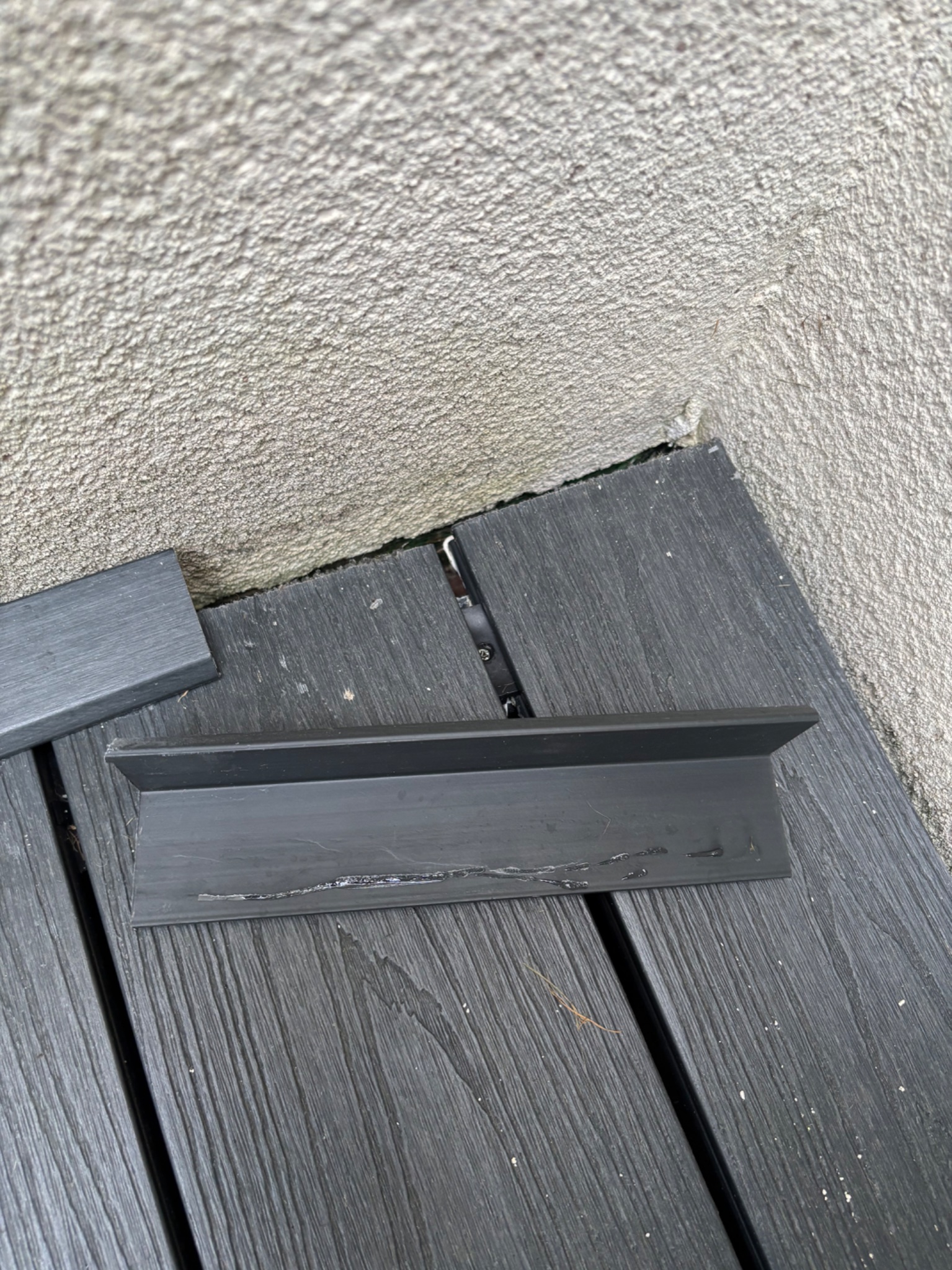

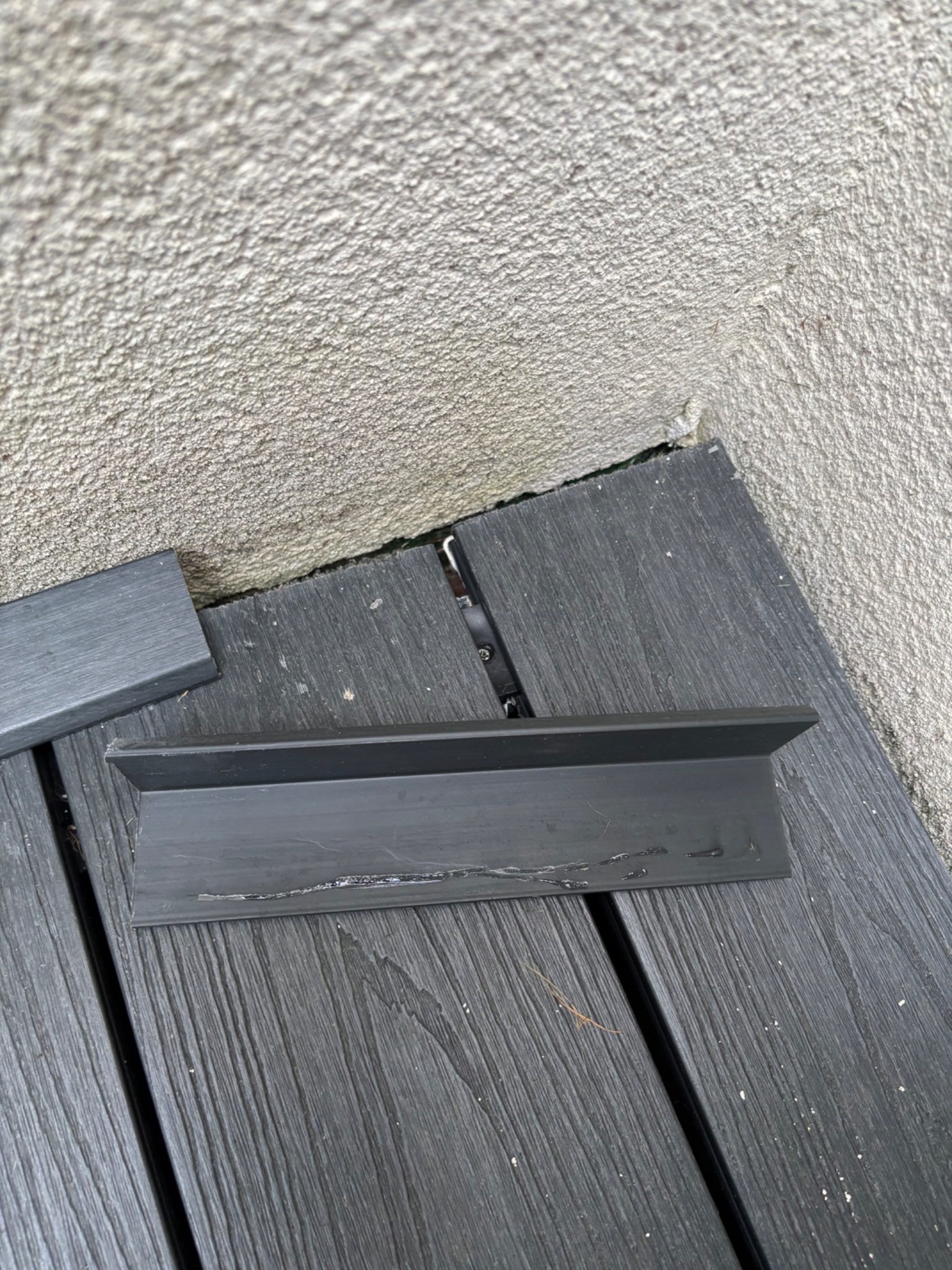

The latest is that there was a gap which needed tidying up at the rear between the deck and the wall. He fitted the right angled stuff, and again it fell off within a day. He used some other glue product.
See below.
What would you guys use to stick it? Ct1?
Cheers
I would be more concerned about how close it is to wall, assuming it’s the house external wall.
Could breach damp course and or cause damp issues.
I used stixall for this purpose, it's similar to CT1. It lasted for about 18 months before the trim fell off. I think if you clean the areas carefully with meths or alcohol and then maybe slightly rough up with sandpaper and use CT1 it should stick okay.

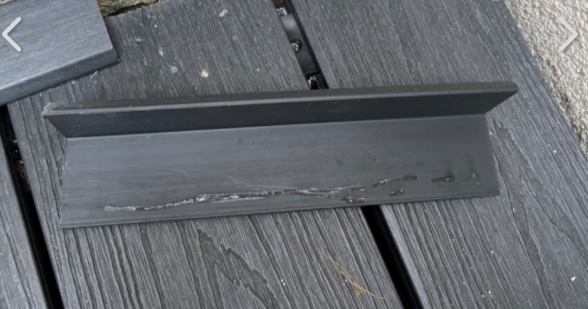

That's very strange, with your builder using so much glue I can't understand why it's fallen off:
