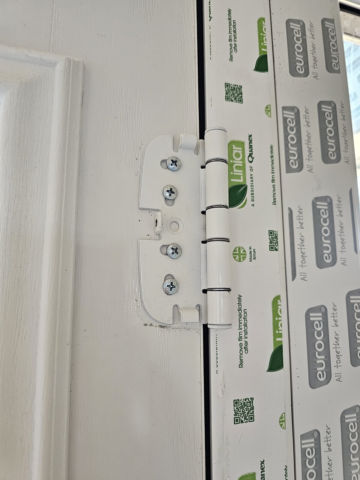

Hi everyone. I have a new composite door and in hot weather, it starts hitting the frame.
I checked the hinge and it doesn't seem to be easily adjustable.
I will attach photo of the hinges I have at the moment.
Can I replace these hinges with adjustable ones so I can pull it back a touch. If yes where can I get these from.
Thnaks in advance.

Tried silicone spray?
Screws look adjustable.
Remove 2.
Slide up
Maybe put one more screw in that centre hole
As @Wayners said. Also peel that tape off ASAP before it becomes problematic to remove.
On a side note. This heat plays up doors. We are struggling to lock our front door ATM. When it cools all will be fine
Thanks for the advice. Yeah it's okay now. I might hang on a bit too see if it happens again.
