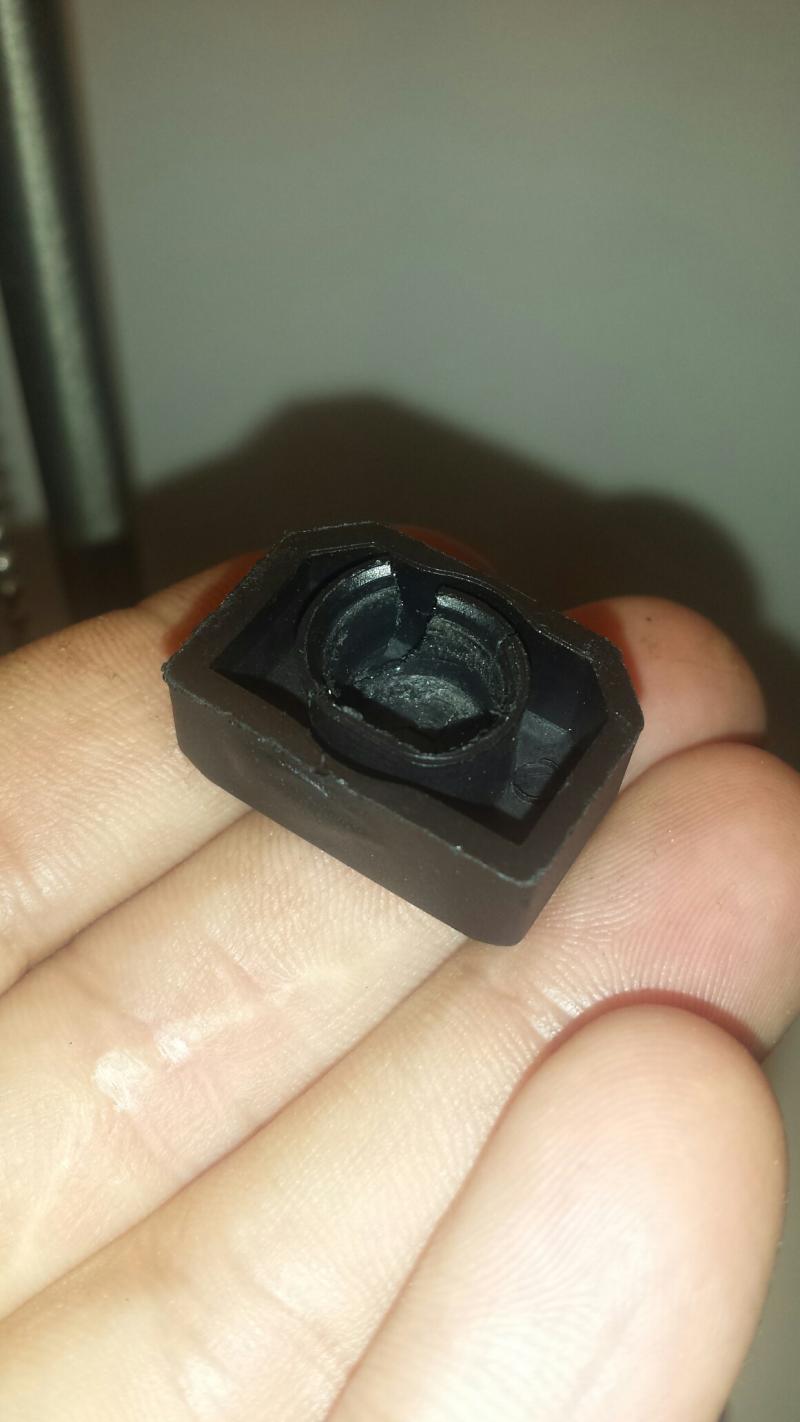

The good news: It arrived promptly and is factory condition.
The bad news: There are 2 parts loose in the box (see photos below):
1. The first part appears to be the plastic cover to the blade lock button:
As you can make out in the photo the plastic has broken where it fixes to the tool. I am happy to keep it, but have asked for a replacement part so that I can fix that; and
2. I am unable to identify where the second part is meant to go as it is not shown in any of the instructions (presumably because it has come loose from the tool in transit).
Any thoughts on what it is/where it has come loose from?
