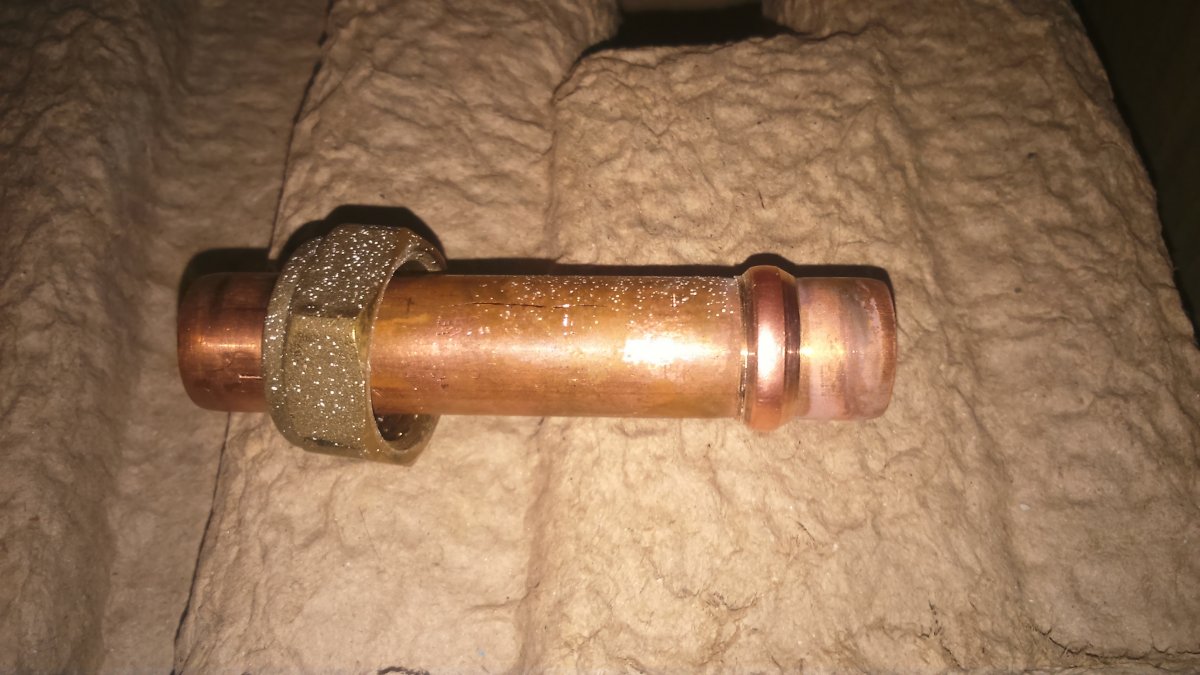

Start by placing olive (the metal ring not the wife!! ;)) and nut on the pipe.

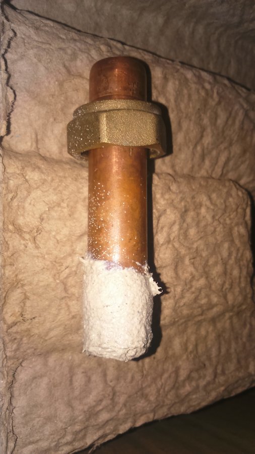

Apply a liberal coating of Boss white on the pipe and olive like so,

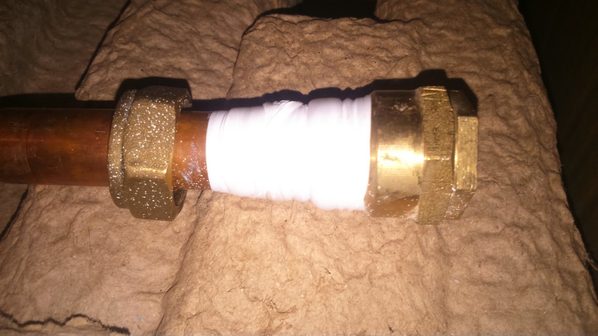

Wrap pipe, olive and threads with PTFE and then finish with a light compound glaze over the top

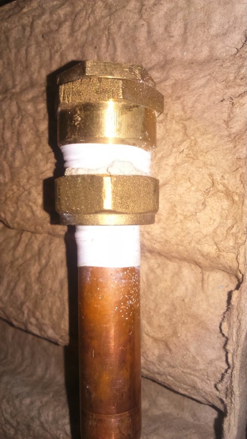

Tighten nut as much as possible usually 2-3 good grunts on a set of 18" Stilsons should suffice.
Job Done. This is how us proper engineers do it. Those that argue otherwise really don't know what they are doing.
