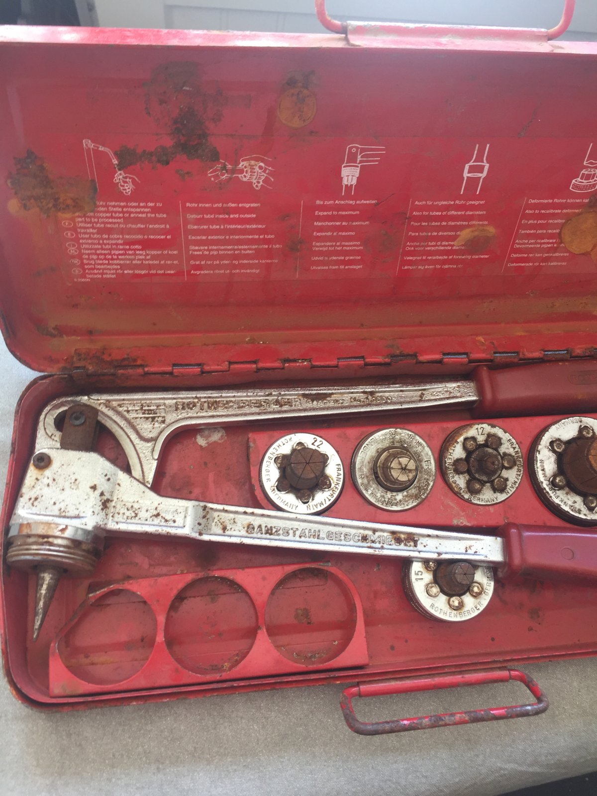

These are better
As you can see I look after my tools :LOL::LOL::LOL:
How often do you need to use that kit?
Not often now but when I was installing everyday. Quite often used to do all my couplings with it and it's awesome if you have to push a pipe with a bend on it under the floor and have it poke out because you can form a socket on the end of it and there's no bottom joint to solder so you only have to come up an inch or so.
Oh and for adjusting different sized pipes of course (y)
Ahh... Good old suaging (spelling?) (y)
Technically it's not swaging although the hammer in ones are. The head expands inside the pipe and gives a much more even expansion.
Not a must have but when you have one you use it all the time!
That's sold it right there... I love fishing but not that kind :sneaky:
