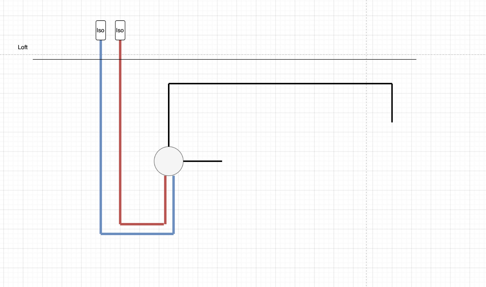

I have a crosswater crossbox to install for a shower.
Wall is Thermalite breeze and plan to channel out for the valve and pipes as I have limited space.
Its an unvented system and I have two previous Polypipe tails from a Bar Mixer that was dropped down the ceiling available to connect in with full bore isolators but I would like to do Copper to be sure this install is solid and I never see it ever again (getting wet).
Crossbow terminates at the bottom of the valve so I need to go down then up to feed in. The Shower head will be a run out and then Hand mixer right next to the valve.
I have bought a pipe bender....
Is this going to be suitable to do with bends and be suitable pressures or am I being naive?
There’s a minimum radius for 90 degree bends so you might struggle. I found texture sprint about as small as you can get if your not comfortable with soldering
Pipe bender is not very compact.
I always soldered joints in copper as easy enough.
Just remember never heat and solder at the same time.
Don't over heat pipe and bubble the solder.
I can't answer if your plan will work. Just go for it..
Thanks.
I can go along about 1m for the U bend. I'd get if you was doing a 180degree but I'm doing two 90's?
I've bought some 3m runs from SF today so will have a bash at this tomorrow with one of the runs (after praying at church).
Pipe Bending was a flaff but got the nack of it I had a few ripples but nothing to worry about on reviewing.
I also went and bought a torch, in reality I really didn't want to worry about fixing compression fitting leaks on an elbow up in my loft and in a channelled bit of thermalite! Using soldered fittings made the job easy enough and I've not had any leaks on it when testing over the weekend.
Im not sure im getting the decent pressure I need tbh when testing over the weekend, I get about 2 bar through the shower but then 1 bar when both my outlets are turned on.
